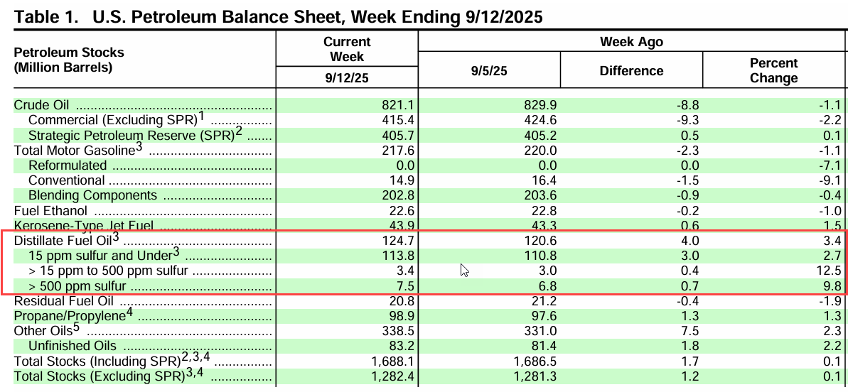

All diesel sold since 2014 has been required to be ultra low sulfur. And if it wasn’t don’t you think the millions of construction machines sold that were designed to burn ULSD would be having problems?

You would be hard pressed to find diesel that is not ULSD at a retail pump, regardless of the signage. It isn't kept at most terminals where the tankers for retail use are loaded. Some older large marine engines and railroad locomotives that cannot use ULSD are allowed to use >15 ppm sulfur fuel but they are being phased out.
