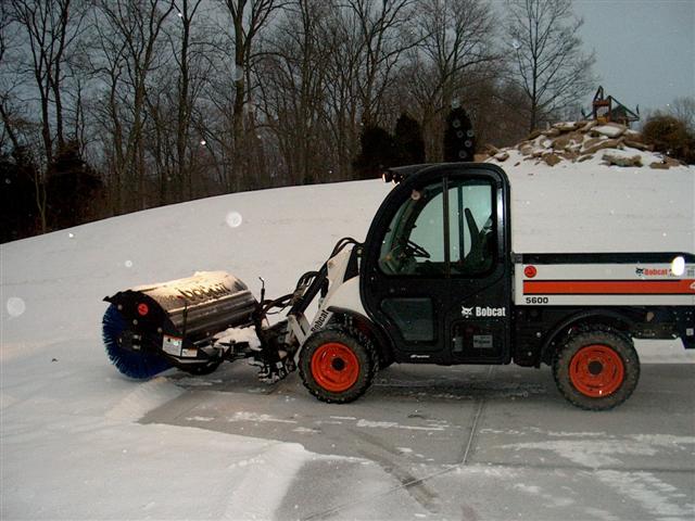

DHS said:
Purchase sweeper on ebay. $280
I like the Red Green reference...so how many rolls of duct tape did you use in the project?
I also have an angle broom that does a great job of removing up to 3 inches of snow in the winter...you'll get good use out of it.
Dean
   / Red Green Sweeper Project
#27
Dean
Looks like your sweeper does a great job with the snow. The company that makes the sweeper wants $300 for the angle cylinder. I found one that will work at Hydraulic's parts surplus center for $82. My intention was to keep the cost under $500. I am still debating adding the hydraulic angle.
I did use duct tape to make a motor bolt pattern to drill mounting holes.
How far down do you wear your brush before you replace it?
Dale
