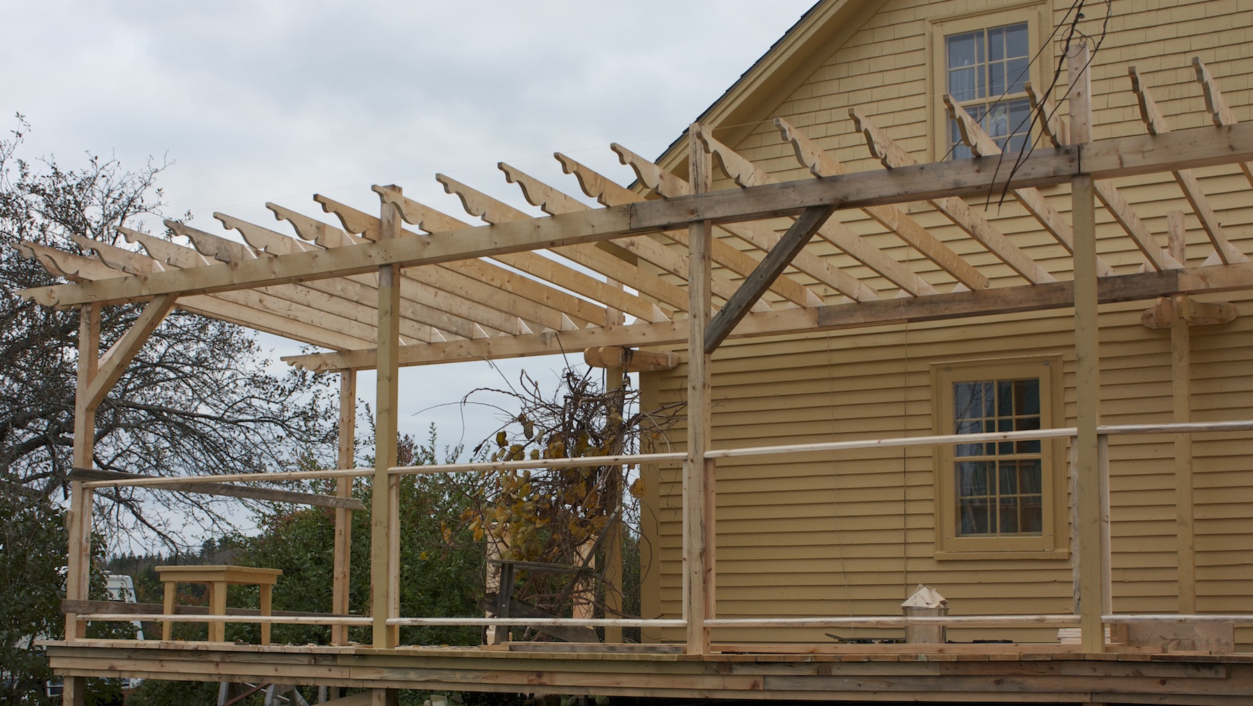

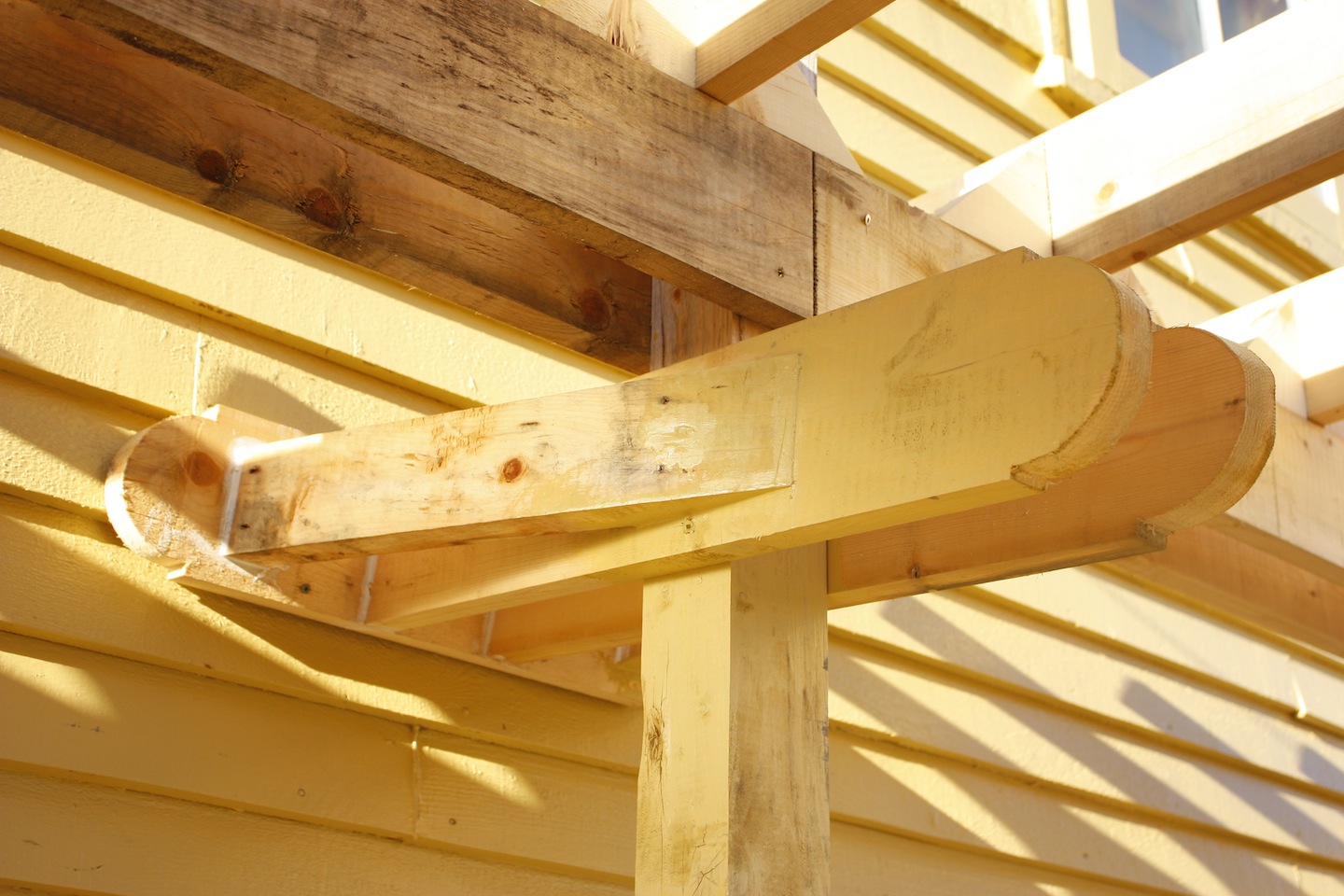

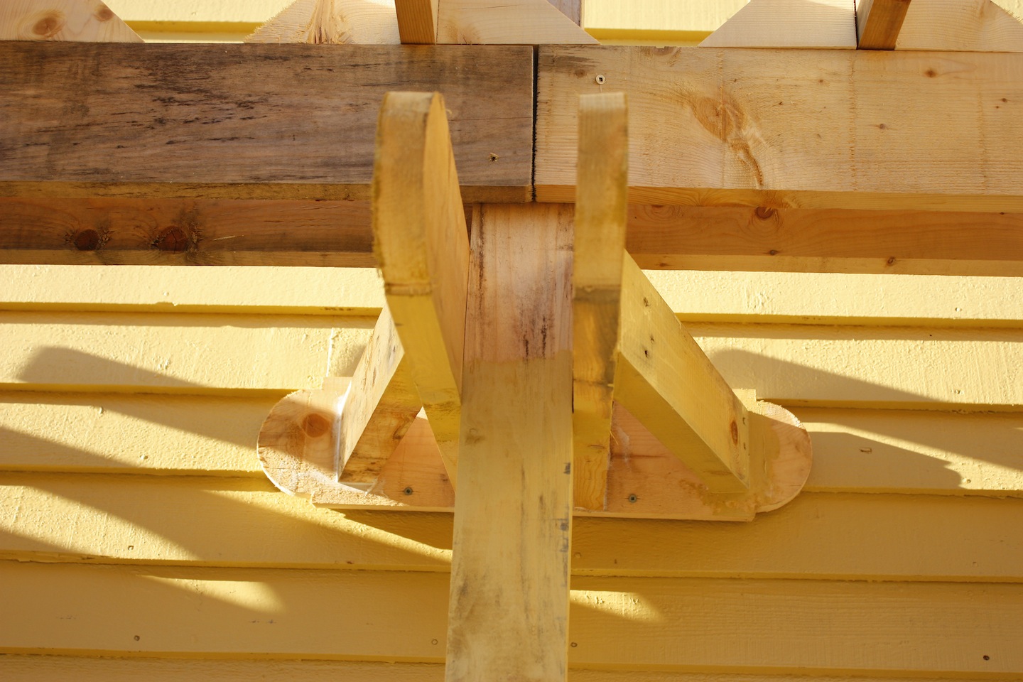

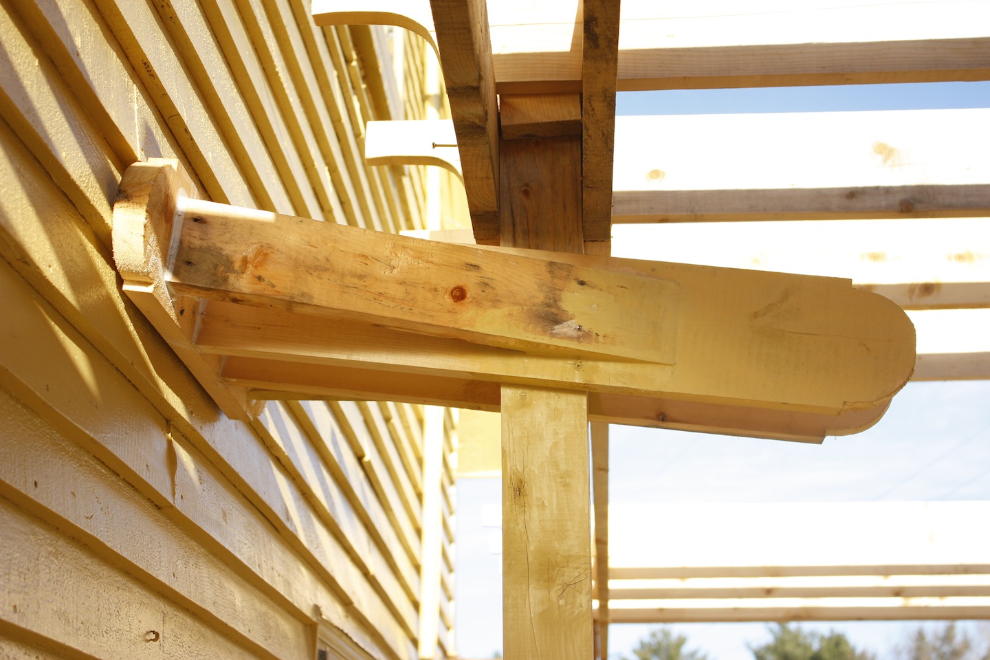

When we first bought and starting renovating the house I called local building inspector to get advice regarding the deck. Back then, if the deck did not attach to house and we weren't putting in a new doorway there was no need for a permit. Hence the slight space between deck and house - about 4". The previous deck was not attached to the house and over time racked. I will be placing in 45 degree ties with posts and horizontal supports to add strength as well. The pics show the connection of post to house - centre post. This one may stay but the two on either end of the deck will be reworked - they just look out of place and too big.

Thank you for the pics. I really appreciate it. How has it held up in the wind and winter time?

Sorry for not getting back to you. The whole structure can withstand the snow loads but I do get the kids to shovel it off- keeps them busy and reduces the snow load. Not problem with wind... we get some good size hurricanes up here...

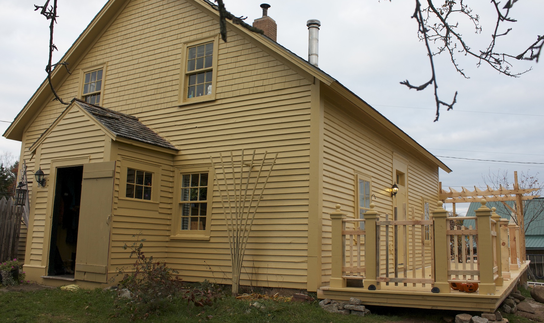

All your work looks great and I have to tell you I love your storm doors!:snowflake:
