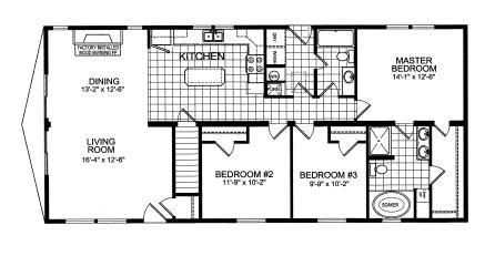

MERRY CHRISTMAS I have been thinking about a wood stove more and more lately. I recently had an event at my place we cut wood for an campfire to keep eveybody warm and it only took about 3 hours to get almost a cord of wood out cut
up in 4 foot lengths for fire. I really never wanted a wood stove before due to
work of the wood, but fuel prices are changing my mind. I have a hot air furnace and still want to use it but my house is very open. Living room, kitchen and dinning room all one big room with cathedral ceiling. The house is well insultated with R44 in ceiling, r21 in walls and r22 in the floors. House is on a crawl space. But I think I could save a great deal by using a wood stove. I know nothing about wood stoves and would like some suggestions on ones people like and use, I would like to get some brand names and ball park prices if someone recently brought theirs. Here is a floor plane of my place and My model does not have a fire place. I was thinking of placing the stove in the left back corner. Near where blue print shows fireplace. I also do not have a staircase in my house. Man have prices increase I bought my house for $68,000 and now they start at $90,000 about 6 years ago. I do know a few things I do want and dont want. My house is 15 sq feet, and open area is about 700 sq feet, that is all open. My plan is too cut wood place on pallet and use tractor to place full and empty wood pallet on deck cut out handling so much. Will have teenager in summer to stack wood for me.
Do want Stove Pipe will go through the roof of the house.
Fan or blower to help push heat out in the room.
Pan in bottom to empty ashes out.
Be able to fire must have a glass front.
Want to keep stove on left side of house as you look at floor planes as there is a deck and sliding glass doorsto bring wood in.
Do not want
Top loading stove
Will not use as primary heat source on supplement

Things to note is that if you want the best heat from a woodstove (or any radiant heat source), ideally it should be centralized in the house. You note you are planning to put it on the back wall which is not ideal but would still work. The other thing is you should have the chimney pass straight up through the roof and not out the side of your house and up as you want most of the stove pipe warm and the top cold for improved draft.

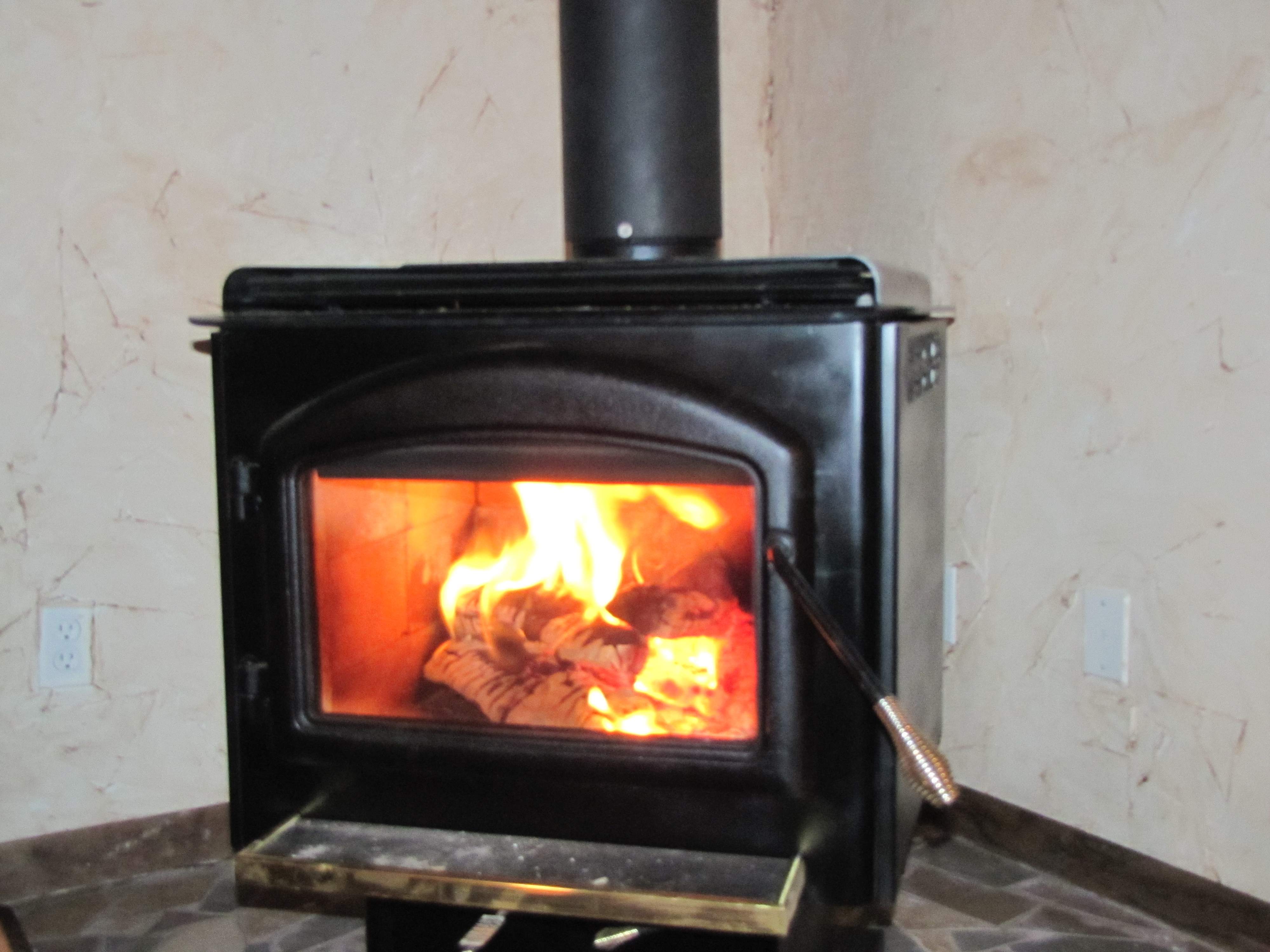

My house is only 1,000 square feet and I wanted a wood stove to save money on electric heating, but also for a source of heat if I lose power again like I did last year when it snowed. My oriniginal thought was to buy one from Northern Tool, but when I looked up their brand, I read quite a few complaints. I did the same with stoves that I saw on Ebay and then what I found for sale around town.
I read a lot of good reviews on Napolean, but there isn't a dealer anywhere close to me. I did a statewide search on Craigslist and found the exact model that I wanted just ten miles from where I live!!!!!
My stove is rated for a 2,000 square foot house, and I think those ratings are more on what will keep you alive, not actually heat the house. I don't have a blower and don't need it. Mine heats my living area very nicely. I have to be careful of getting it too hot or I'm uncomfortable. I bought a canvas sack from Ace Hardware to carry in my wood. I can get the stove hot and maintain it all night without using all the wood that I can carry in that one load. Some nights, I have wood left over.
I have an ash pan on my stove, but never use it. I bought a fireplace shovel from Home Depot that has a sort of long handlen and a small shovel end that is perfect for scooping up ash and putting it into the metal bucket that I also bought. Very small amout of mess and it's very quick. I do this once a week.
Getting the ash into the ash pan was a lot more work then just scooping it out.
My advice is to buy a stove rated for at least 50% bigger then your home. If you put a blower on it, or get one with a blower, you can go smaller, but be sure to check to see how loud the blower is. The ones I've heard make a ton of noise. I hate the sound of them, and don't want one myself. Wood storage has been my biggest suprise and challenge. I've got a plan now, but it's taken some thinking and planning.
Price wise, my stove sells new for around $1,500 and the pipes and fittings add another $450 to it. I put in tile for a base for under a hundred bucks, but you could buy a platform or put in brick for less. I didn't put anything behind my stove because I never found anything that I liked better then the walls that I already have. My stove is Moble Home rated, which means it's sealed better and can be installed closer to a wall by a few inches.

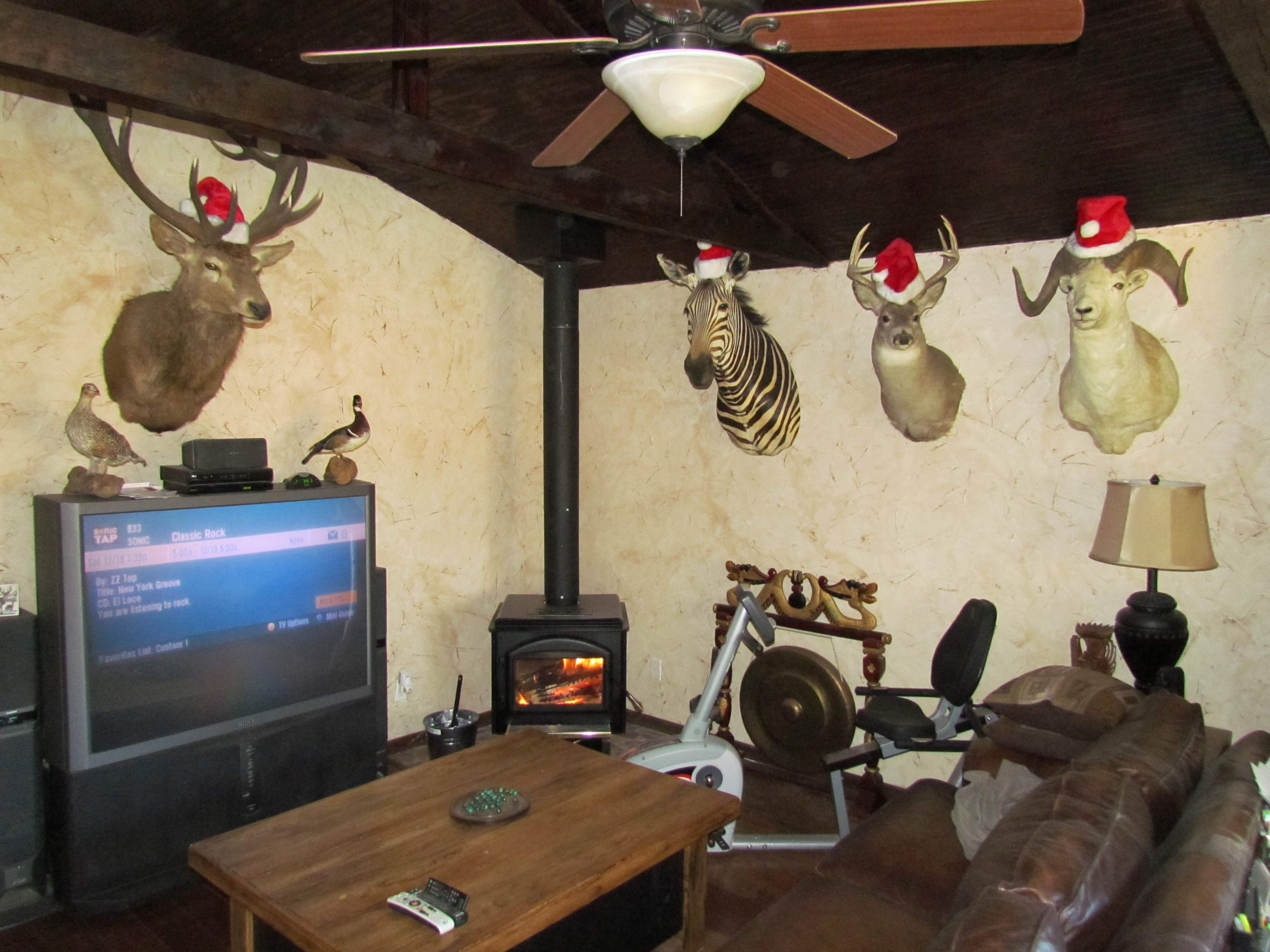

Recently bought a Napoleon wood stove to supplement our primary furnace and to use as a back up if our furnace should break down. Love it. Should have installed one a few years ago. $1500. or so plus $100. in 6" black pipe and fittings. Should note that we had a second flue installed in our brick chimney to provide for a wood stove when we built our house 3 years ago so the recent installation was fairly simply. Like Eddie, ours has an ash pan but I find it easier just to shovel out the ashes into a bucket without using that feature of the stove.
