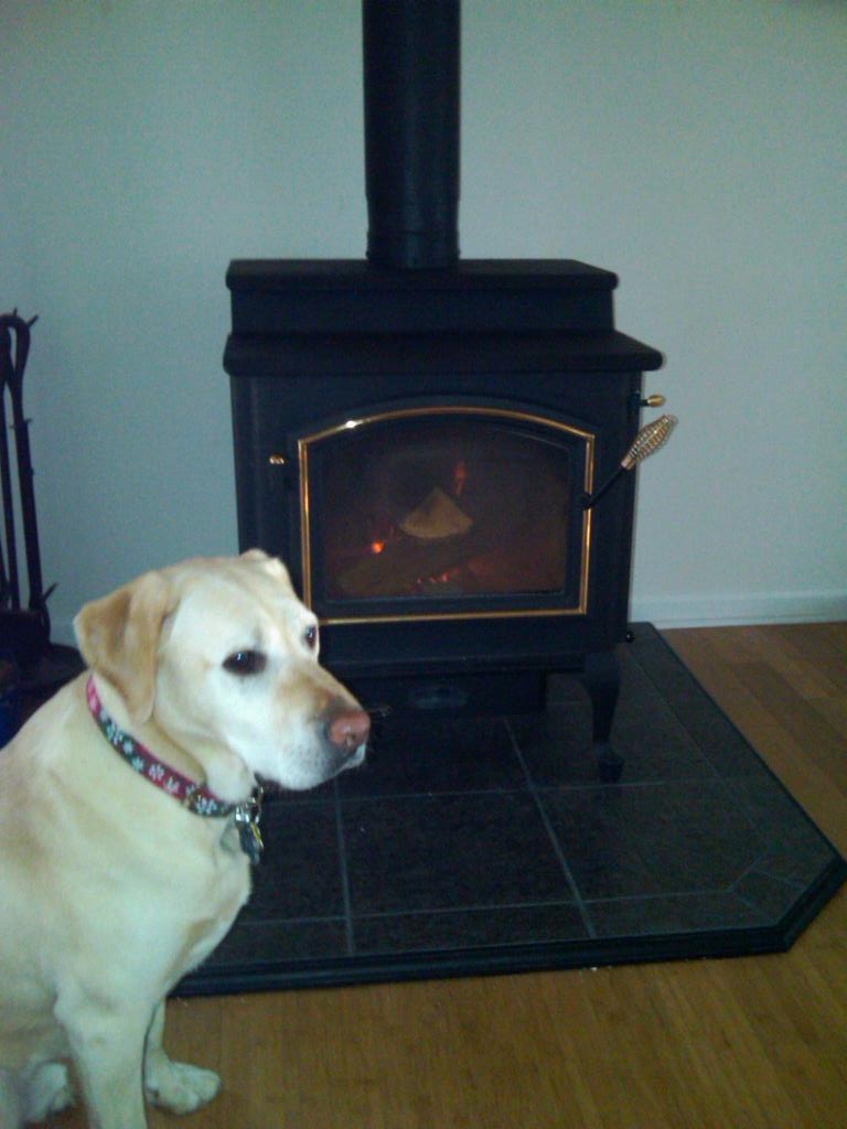

My wife and I just had a wood stove installed about a month ago. The stove was $1,800 with 80% effeciency rating. The chimney was run to the outside of the house and is approximatelly 26 ft to the tip above the roof peak. It has been by far one of the best investments. I only wish I would have bought and stored more dry wood. We were mixing in green wood but there was just too much creosote. The minimum clearance on the back of the stove is eight inches. The project was 6,500 after everything was said and done. The stainless pipe was unbeleivably expensive. When the stove is running the Heat Pump does not kick in and the heat pump for upstairs seems to run a lot less. We do need to get a fan to help circulate the air a little better though. Oh, the stove we bought can heat up to 2,400 square feet. This is also the first time I ever posted a picture on tractorbynet.:thumbsup:

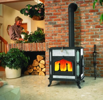

This is my 4th winter using a wood stove as my primary heat source with propane/heat pump as my auxillary heat source. I am extremely happy with my Woodstock Soapstone stove. Welcome to Woodstock Soapstone
Their website has a ton of useful information about wood stoves, wood burning and their efficiency using a catalytic converter to reduce emissions. They have quite a few styles, mine is attached.
