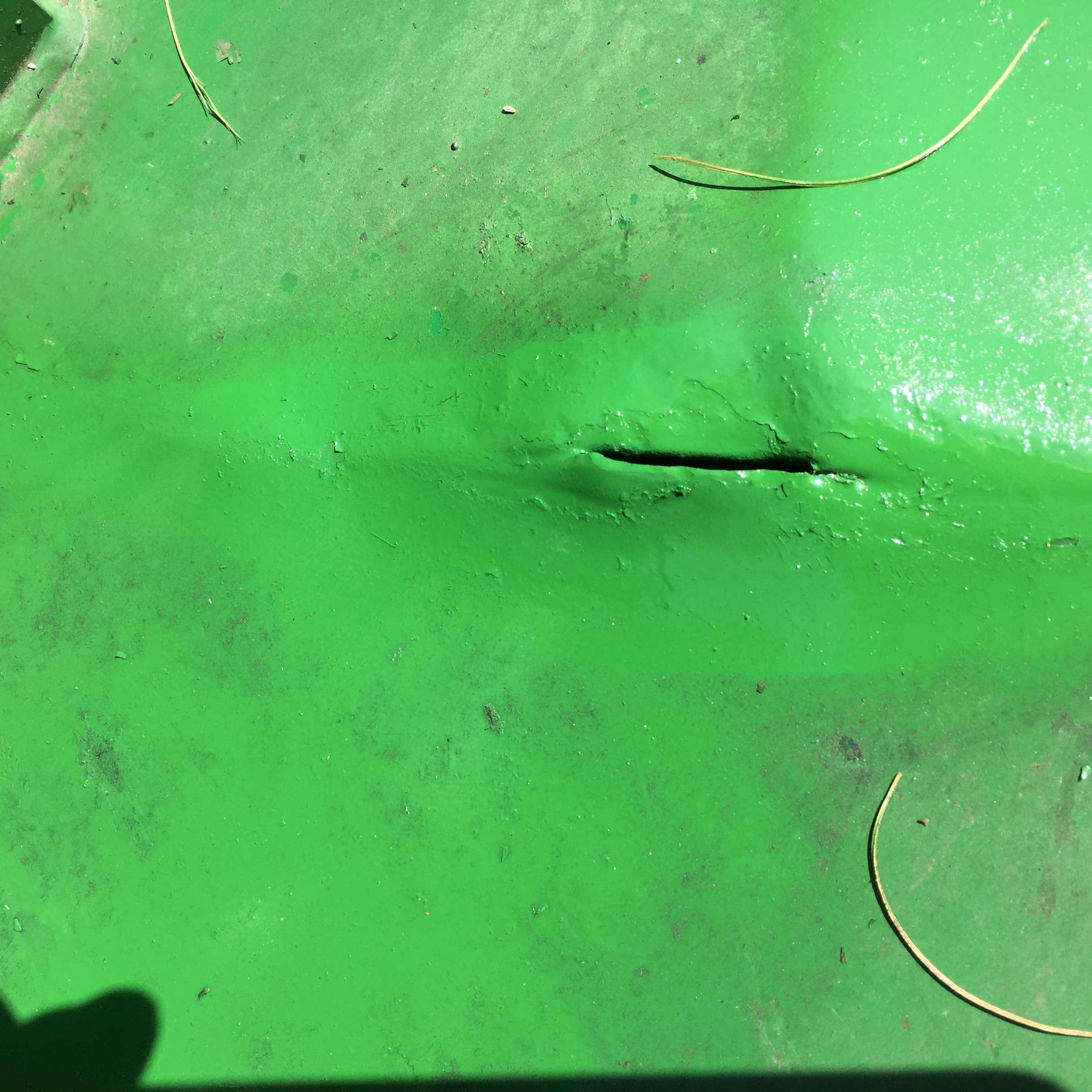

I ground a smooth curve into the trailing edge tips of the suction blades and rounded the top. Kind of golf ball shaped on the top edge. It makes a smooth welt on the deck instead of a sharp crease or tear. 3 years now and I think its working well.

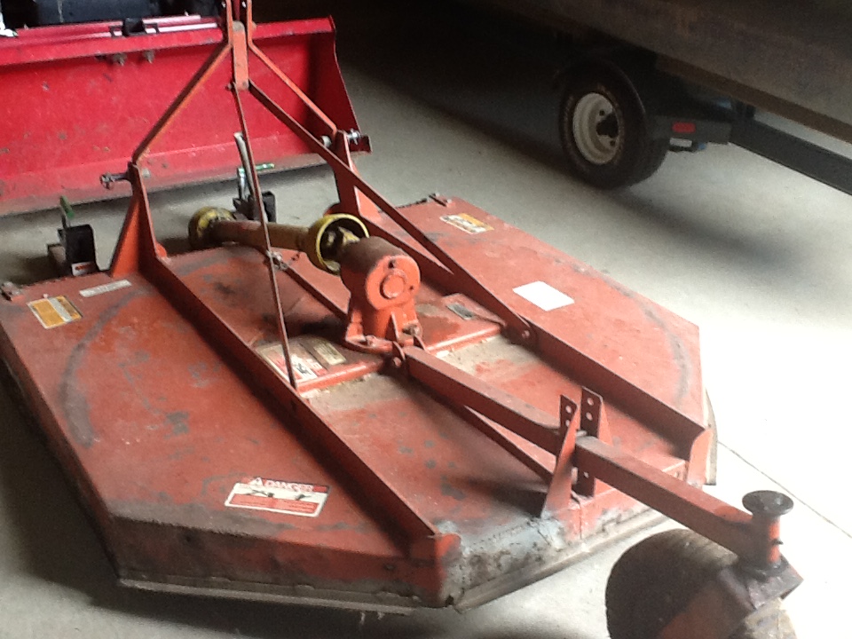

I get it... seen many old, beat, rusty brush hog decks with a ring worn into them where the tips of the blades have beat it up... some bad enough where it looks like a big can opener did it...
Some blades are flat at the cutting tip, others, like mine, are bent up to create 'lift' or suction to lift the grass for a cleaner even cut, like a lawn mower blade...
My guess is that years of bouncing off things on the ground sends the blades rebounding towards the deck, and once there's a bit of wear on the shoulder bolts the hold the blades to the pan, there's enough loose movement to allow this scenario to take place...

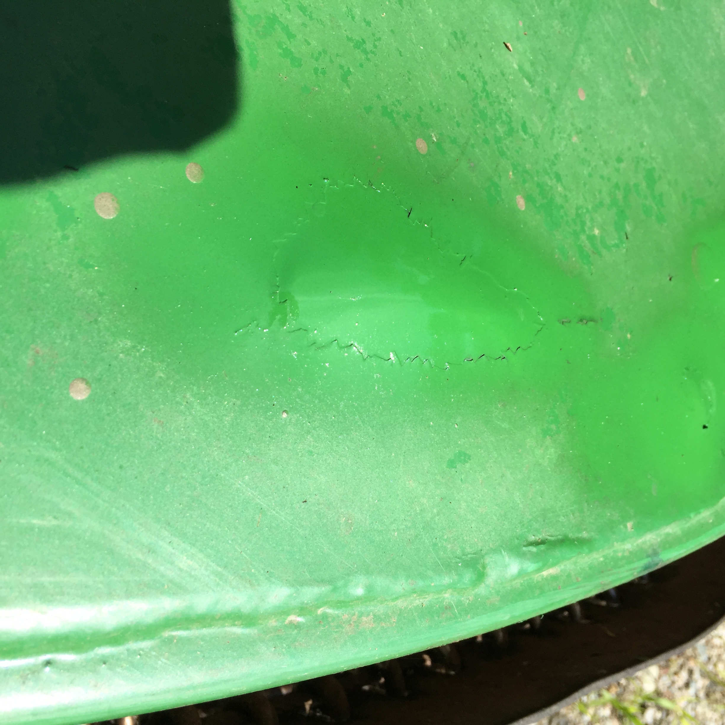

Dieselcrawler is correct. Photo of early dent with sharp cornered blade, with later dent from rounded. 1st dent also has been hit a few times since with rounded edge blades. About 300 acres on the cutter at this point. Stealth rocks are a fact of life in many northern new england pastures, pretty much any light / medium duty cutter will collect these.

The issue is not because a high lift blade was used. The issue is you have something wore out. Either the gearbox, the output shaft, stump jumper, or blade bolts. The Blades should NEVER contact the deck.
Grinding the high lift wing is a band-aid fix masking a bigger problem
