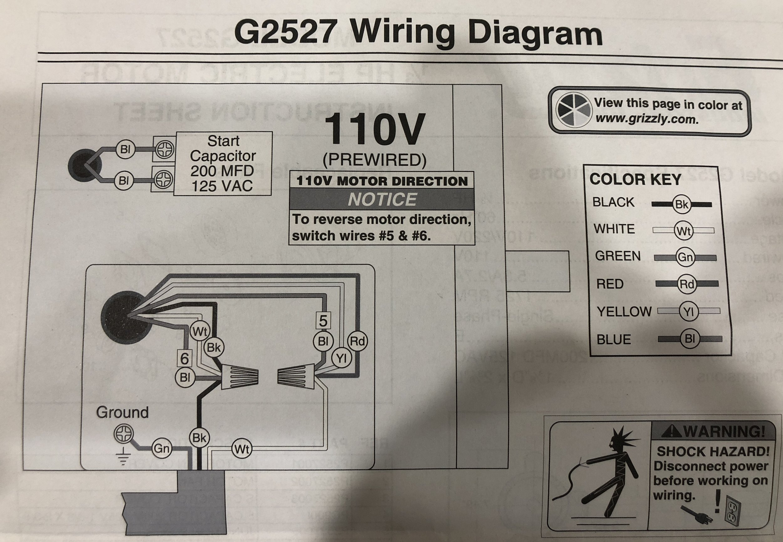

If you look back at the motor wiring diagram, for 110V, you see that red and yellow go into one ac lead, and black and white go into the other, so on your switch, you put one ac lead on either red or yellow, and the other ac lead on black or white. Usually, I pick whichever side of the switch has the most room, usually the side away from the motor lead entry. (Like on yours, red gets one and then whatever color is on the bottom that side (black? I can't quite tell in your photo.) gets the other ac lead.)
The really important thing is that you don't want to have the AC leads side by side on that switch, or they will short.
Does that help? Just for the record, I am not an electrician and I don't play one on TV...

Peter,
Thank you. Worked like a charm. The one thing I needed to do was individually tie nut each line at the motor. What is obvious to me now is… the way they are tied together in the picture below is if I did not have the drum switch.
You made it as simple as possible and I can’t thank you enough.

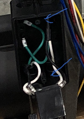

Awesome. Had to do a bit of super glue on the cheap safety switch housing. The screw posts broke off I put arrows to them glued back on in the picture.
So… will have to wait until tomorrow to post pictures of the finished product.
Thanks again Peter. So happy.

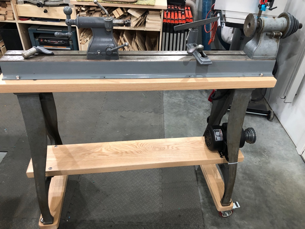

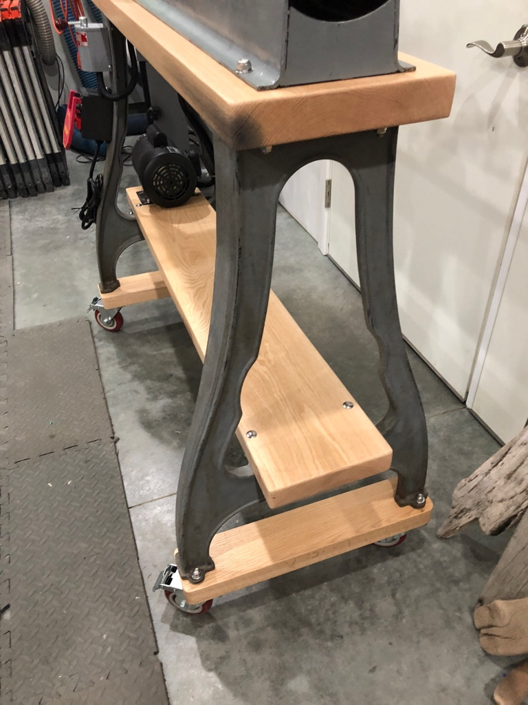

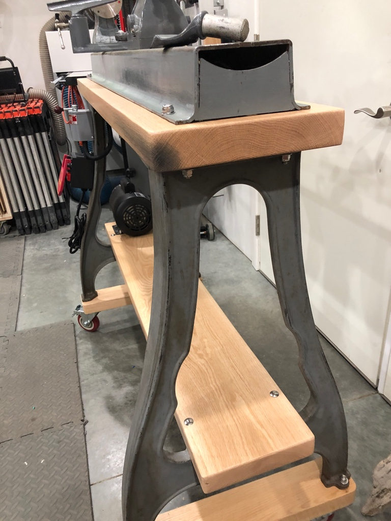

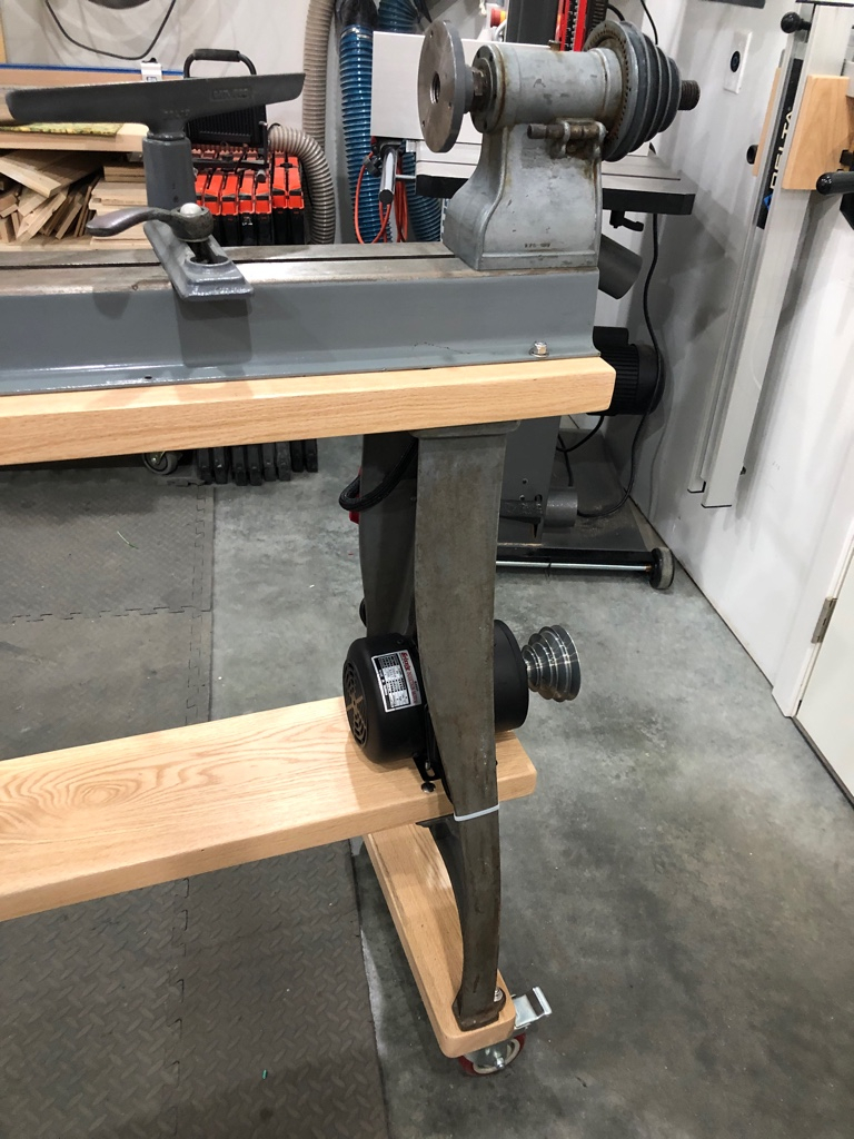

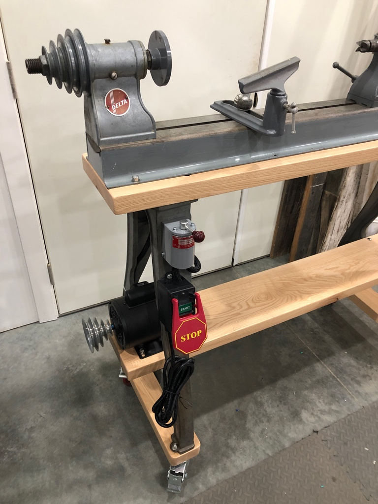

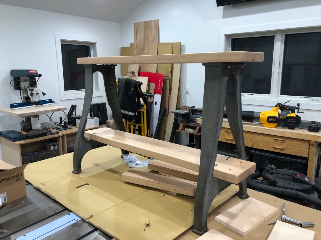

I purchased this antique lathe, then found an original set of cast iron legs for it. I built the connector planks and feet out of Red Oak cut and sawn from the location where my woodshop stands now. I purchased a new motor to be trouble free.

Stuckmotor, yes I hear you and others. Can only use the reverse when using the tail stock so it cannot unscrew and fly off. This will be my first time using a lathe since HS shop class.
Looking forward to trying it out. Need to go pickup the V-belt for the drive today.
