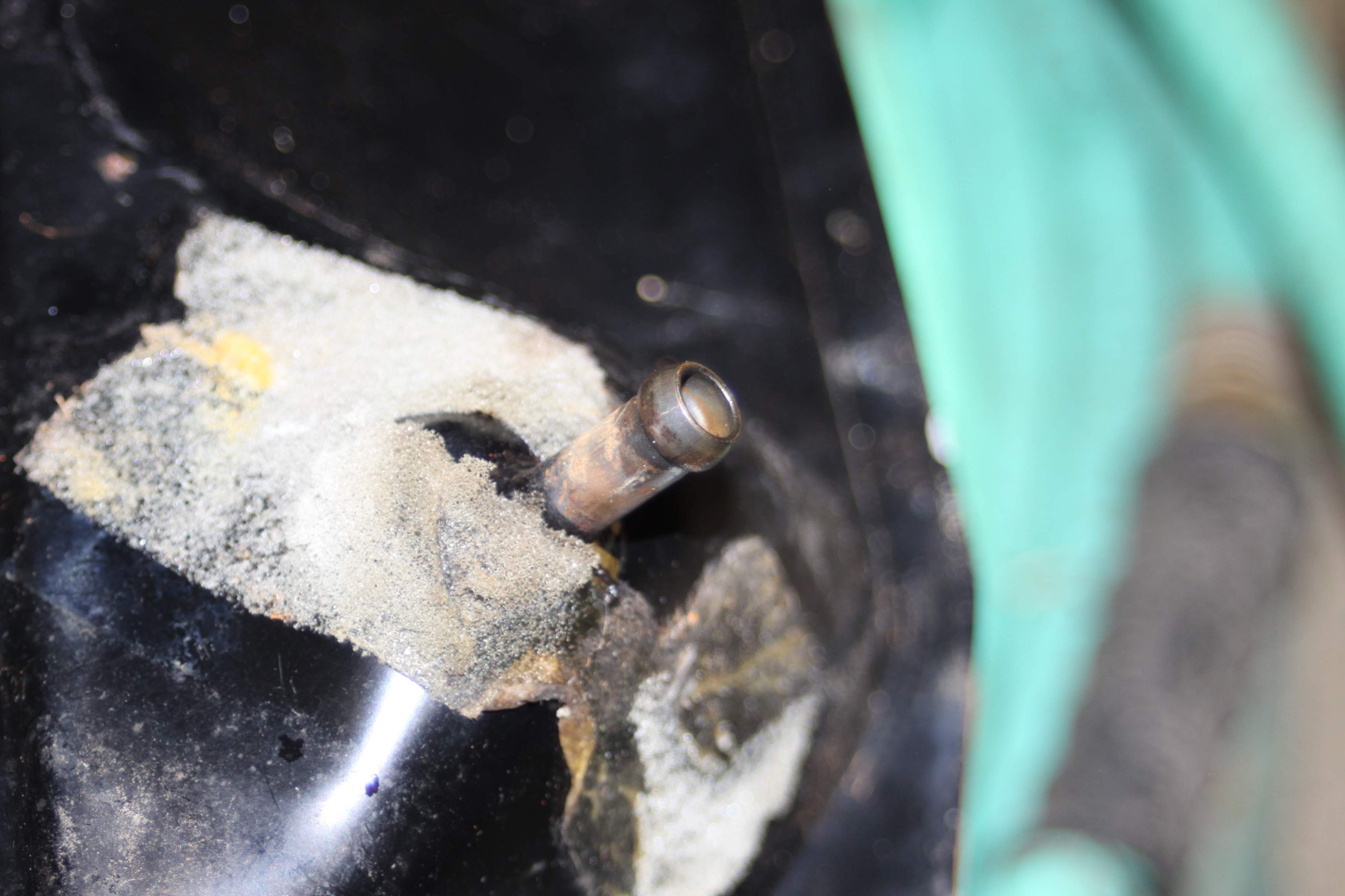

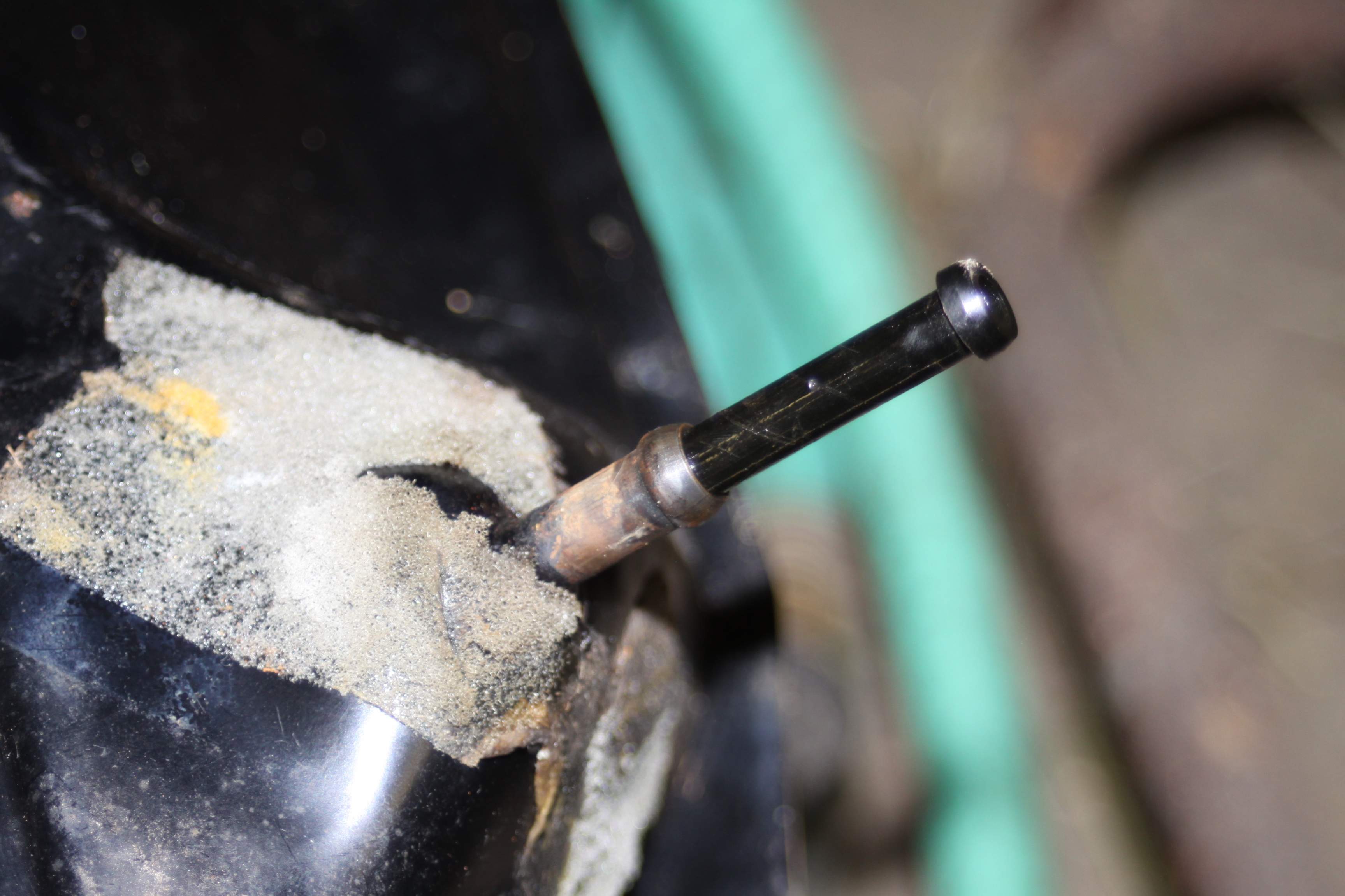

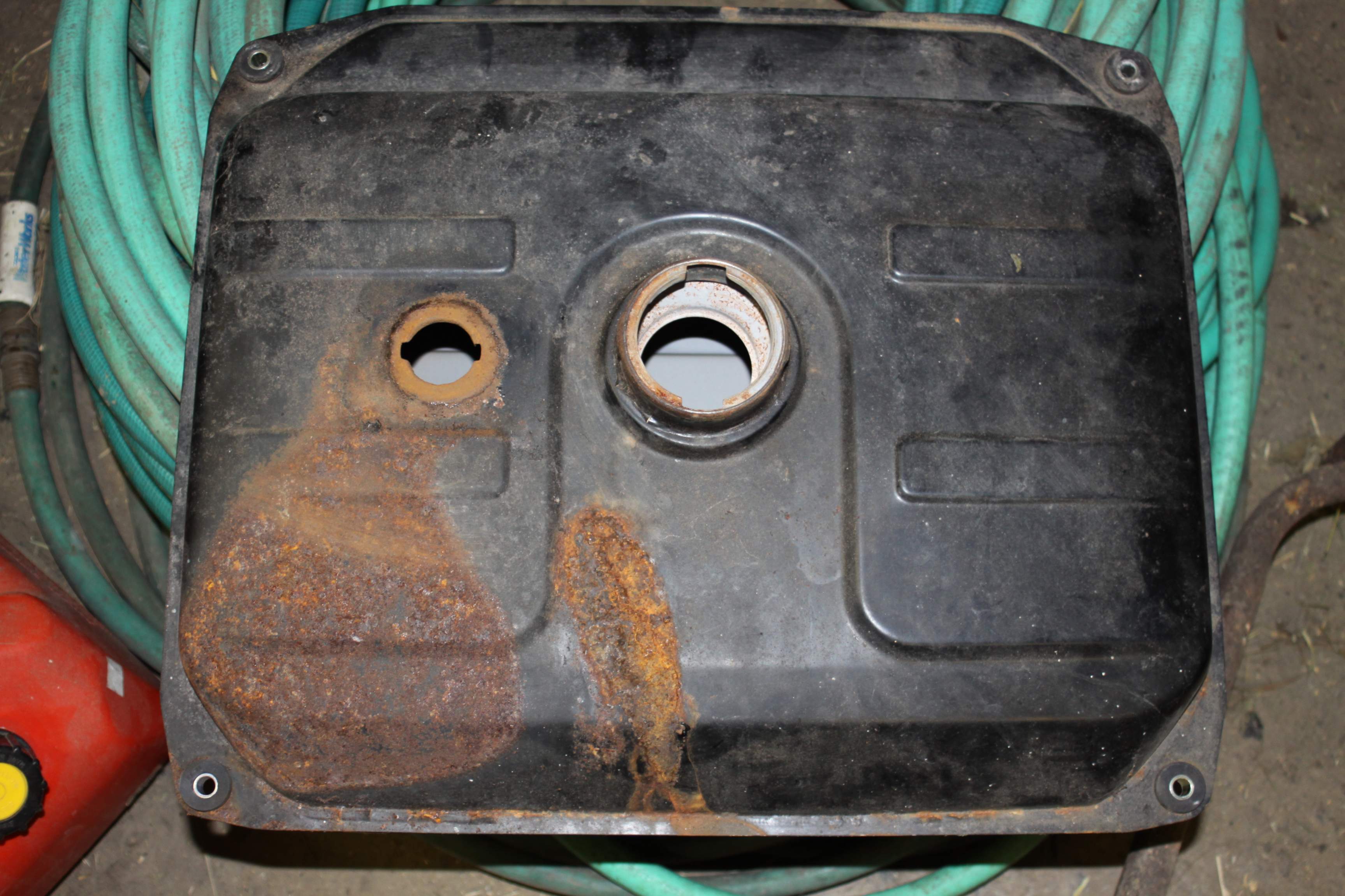

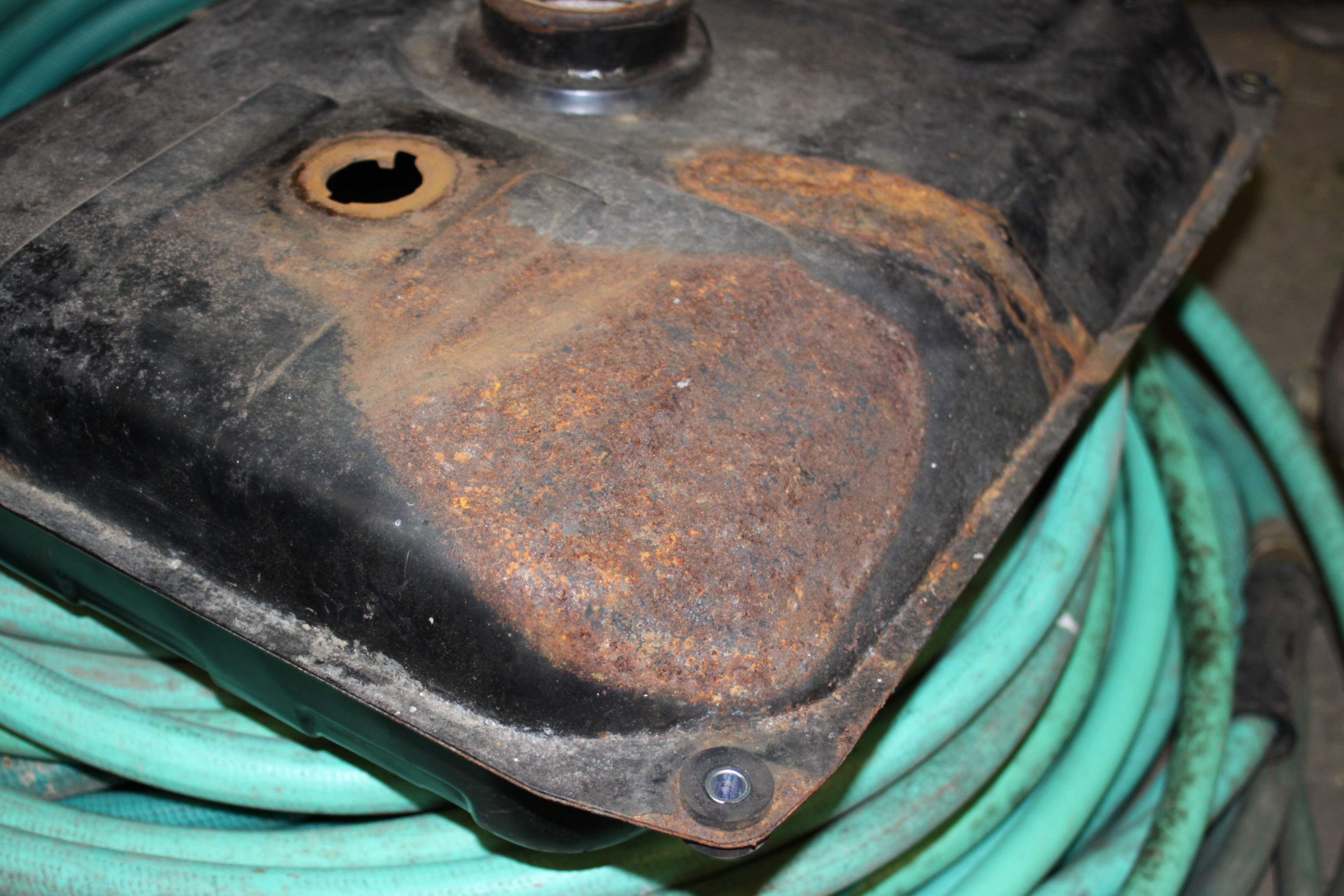

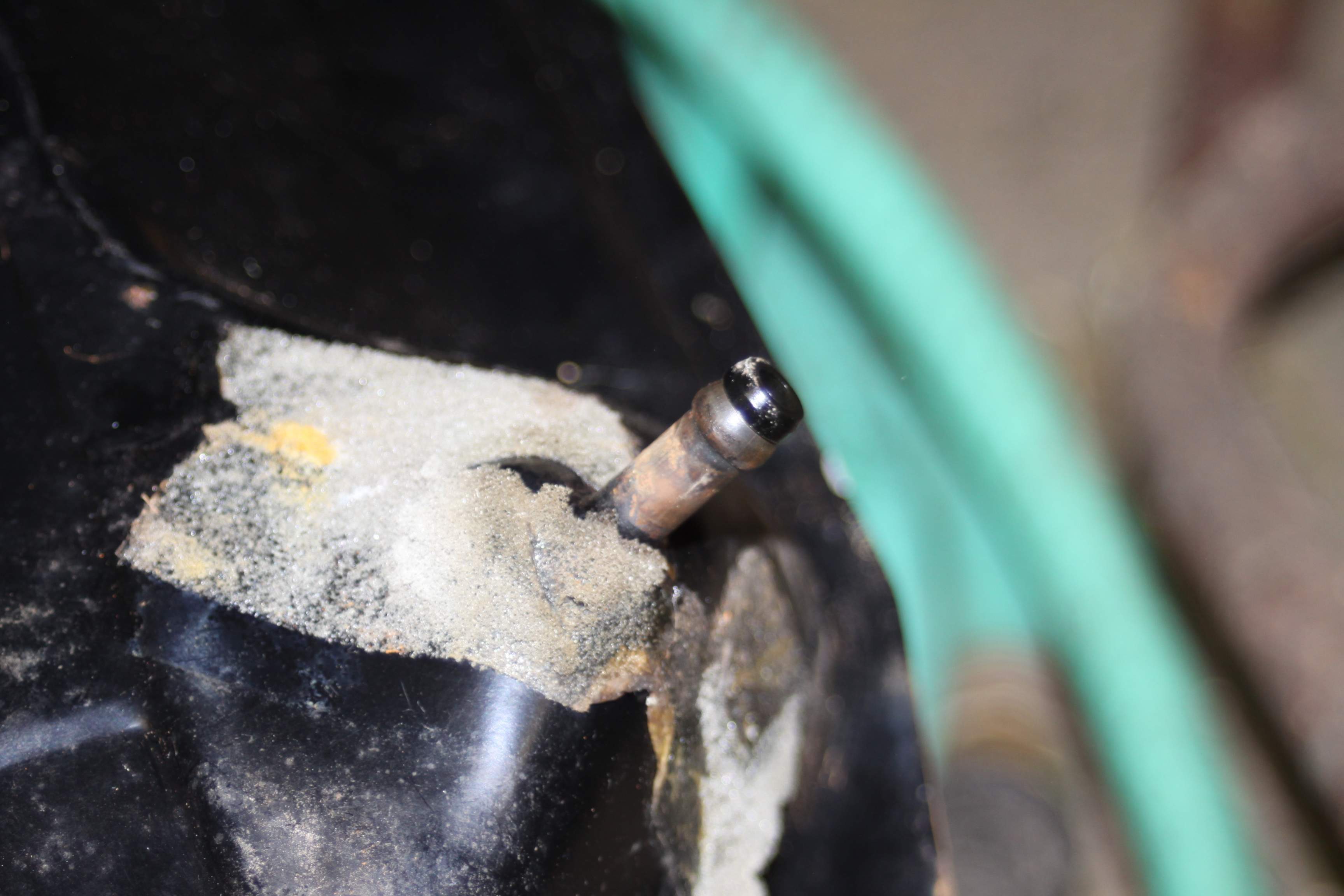

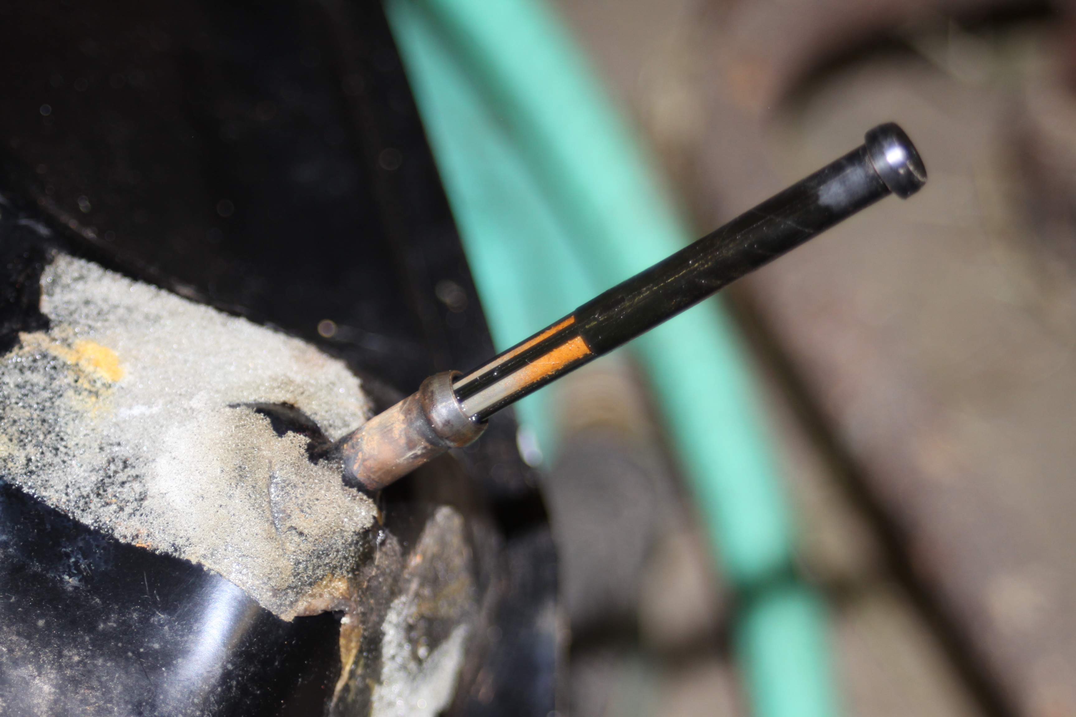

Here are the pix I promised.
These two are of the outside of the tank and the corner where the paint was scorched. If you notice in the first pic, the bottom of the tank inside looks really good.
When I stick my finger into the smaller hole (fuel guage) and feel the top of the tank there is a fine coating of rust on the top inside of the tank and my finger comes out with a light rust on my finger.
Here are pix of the where the fuel line attaches and the filter insert.

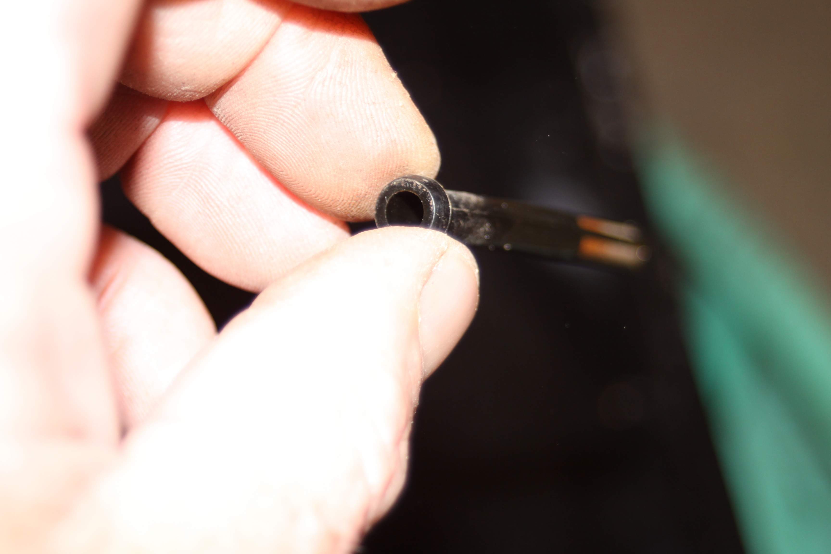

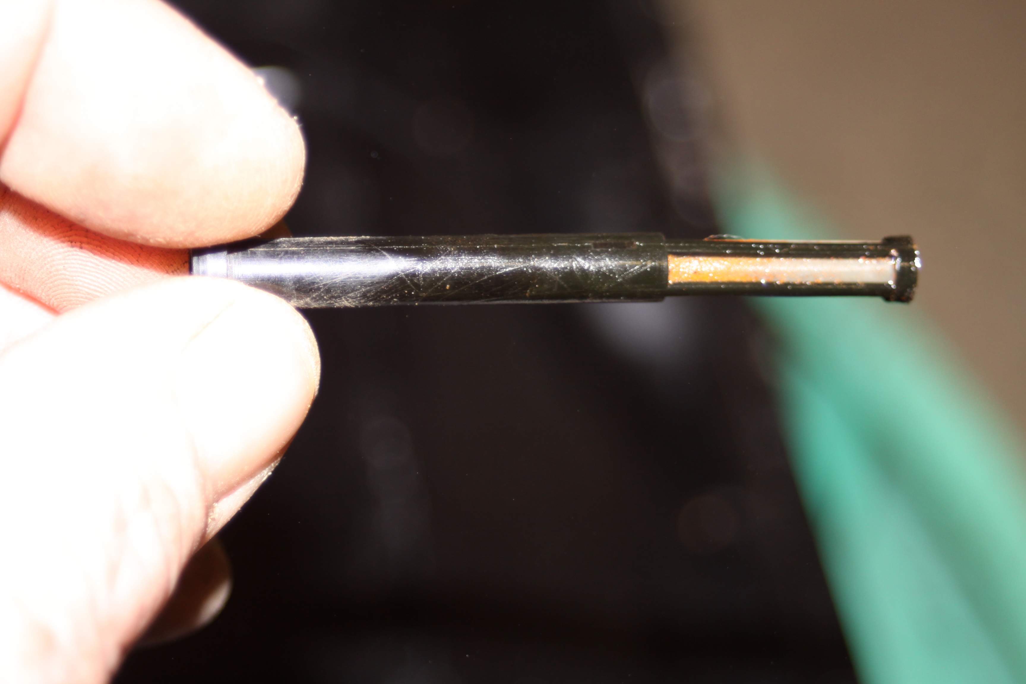

This is the inline filter removed from the tank.

cyril,I think the way I,d do it is empty a couple shoot gun shells(bb,s) into the tank with vinegar (acidic) shake around to remove rust scale,drian&rinse,then use the kreem mentioned earlier.The bb,s work well we,ve done it and easy on the pocket book.Have a great holiday weekend and don,t spend all of it working:laughing:Dave

G'day cyril if you have not got any leaks as such in the tank then empty a couple of shot shells into it as mentioned and shake like anything , then sand up the outside and repaint good as new. I did this 10+ years ago with mine and not a problem since just make sure when it is stored it is full of fuel ( i actualy put a bit of 2 stroke oil in mine for storage ) Not a prob since
Jon
So you think that just cleaning the inside and repainting the outside will be enough? Could be. I have a mirror at work which I plan to use with a flashlight to check how bad the inside is rusted. All the rust is on the top inside so a mirror will be necessary to check what the true condition is.
The rust I can feel just inside the fuel guage opening feels light, but I have no idea yet what the condition is in the area where the paint was scorched on the outside.
I'll post more next week after I have a chance to examine the inside better. It might be interesting to try and get pictures via the mirror. Not sure that would work, but will be interesting to try.
The more I think about this, the more convinced I am that reconditioning of some form is the better option over replacement.

It looks to me like the inside is coated with with something.
If the rust on the inside is light, any aggressive cleaning may remove the existing coating, which could make the issue worse.
One possibility is to sand & paint the outside, jettison the existing fuel filter and add a large clear aftermarket fuel filter. This would both protect from rust coming loose and let you see what is happening in the fuel filter.
I know you are against jerry-rigging something, but his preserves the original look of the generator while making only a small modification. Plus, I bet it is more cost effective than cleaning & coating the tank.
