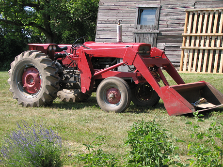

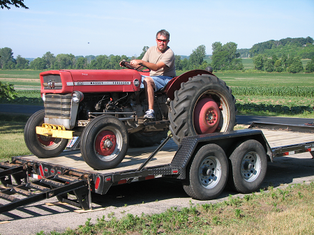

Thanks a bunch Kid Robert! Yes a refurbish is another great way to redo these ole' gals. I like your mind set KR, don't fix something that's not broke. Thanks for the info on the rattle cans we appreciate it. We plan to use our tractors for the intent they were made, to work and make life a bit more easier here at our place. We may just use the combo package of what you, MasseyWV and Mike have done. They should all be a big improvement for sure. I posted a picture of my tractor and hubbys baby. Well yes, I've claimed this little classic 135 while hubby has the MF150 Diesel w/fel. (the gentleman in the pic is the previous owner making the delivery of the 135) Like I said in another post "His and Hers".........and hey Mike I'm still waiting on that phone number deal about talking to your wife about the His and Hers concept.......lol! :)
:tractor:--MasseyLady
