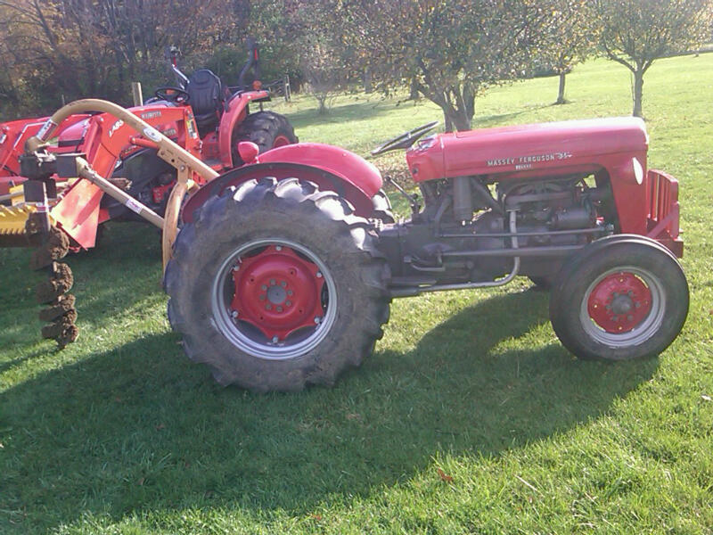

I just reinstalled my rears myself on my MF35 had to swap innners and outers to bring the spacing in after removal of the loader. Mine are loaded 14.9-24 520 lbs plus the rim each so It was fresh in my mind IMG00423-20121024-1018.jpg
