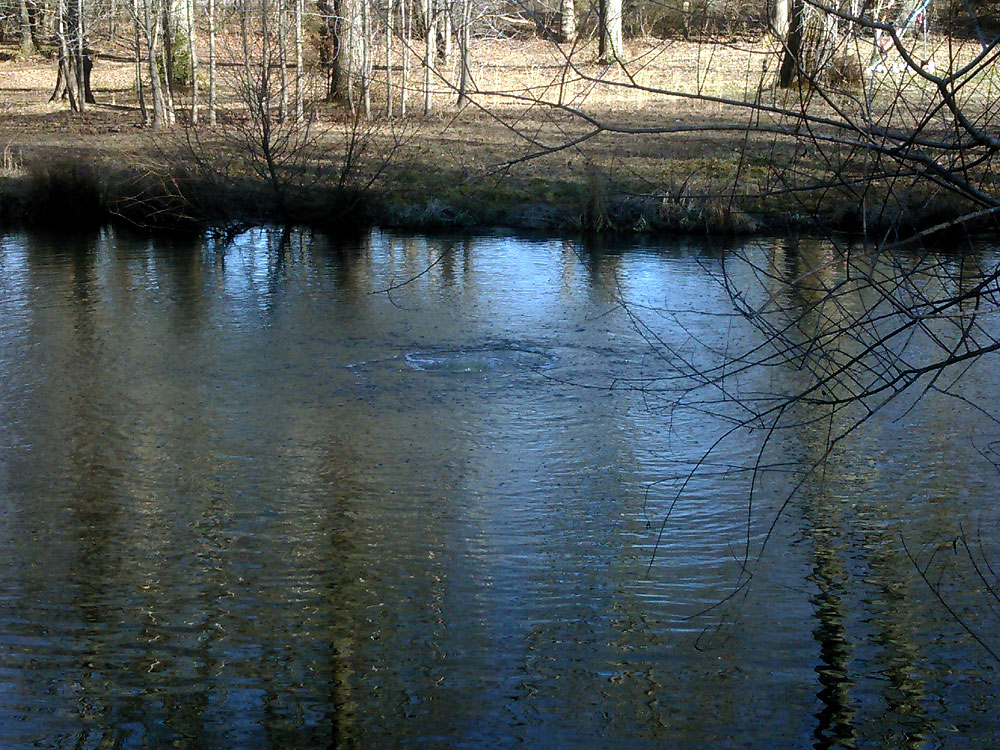

My difusers are rectangular air stones. Four of them attached to a single manifold. The diffusers and manifold are connected to the plastic pipe air hose.
I have a poly rope connected to the manifold with radiator clamps and knots to insure it doesn't come undone.
The poly rope is twenty feet long and connected to a one gallon plastic bottle. It is my buoy and marks general area where the diffuser is, and aids me in pickup of the whole assembly in the fall.
The air stone assembly is attached to a flat piece of semi rigiid plastic with a hefty amount of cable ties that go around the manifold and through holes in the semi rigid base. I lower the whole shebang with the poly rope onto the bottom of the pond, deepest area. The plasic hose has a couple six foot metal fence posts without the "V" attached to it with electrical tape. That keeps the hose down and assures the assembly stays put.
In the fall when I decommission it all, I pull on the rope from a canoe or kyak. I lift it and go ashore and disassemble the whole works and winterize it.
I take the stones from the manifold and soak them in the kind of acid used to clean swimming pools. The stones are filthy and after a soaking, they clean up almost perfectly in clean water. Sometimes the fittings need replacement or new epoxy when I take it apart for the winter.

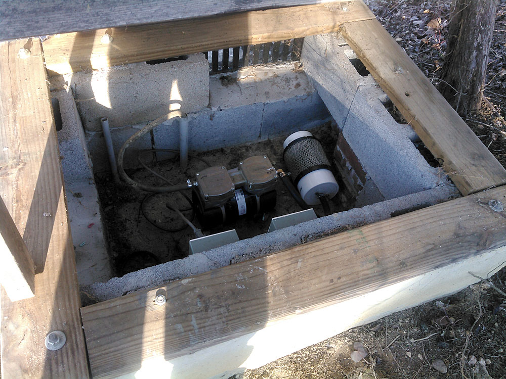

This is Purolater brand air filter, I tried to use standard pieces I can find easily in local stores.

The filter needs to be replaced, but the plastic cap directly by the compressor is cracked, I guess the vibration done it in. I will try to sandwich it between some plates with rubber cushions.
That's quite a bit of weight hanging way out there for that filter. Maybe mount the pump to a longer base that also supports the filter so it all shakes as one solid assembly. Or you could keep the filter assembly sitting next to the pump and not bolted to it, and connect it to the pump intake with a short rubber hose. Or, use a schedule 80 cap to replace the schedule 40 that cracked.

And thanks for the fresh eyes approach :thumbsup: Detaching the filter is a great idea, much better than my old solution.

Advice against setting bubblers too deep is to maintaain cooler deep water (more O2) for fish to gather in when weather is hot and surface water is too warm to hols sufficient oxygen for their nature.
Here in MI, when ponds are frozen too tightly and gases of decomposition accumulate fish kills can be startling.
I have ~2" of ice right now. When fully installed, one reason for the aerator is to keep the ice open. Clearer water is the other.

Back in business. Seems like detaching the filter cut down on the compressor noise, too.

There you go! That looks like a much better setup to relive the stress and vibration.
