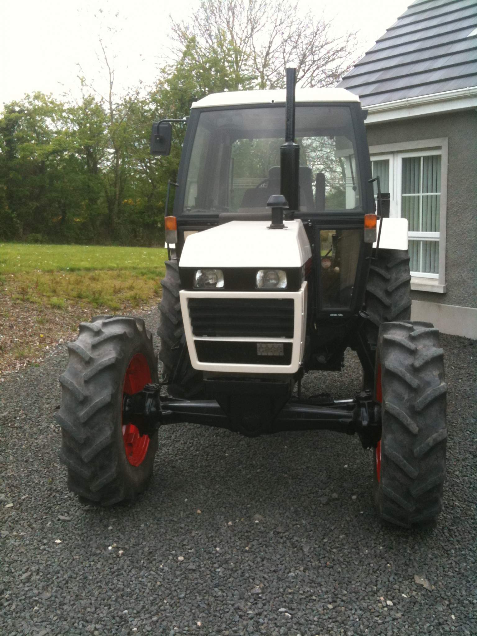

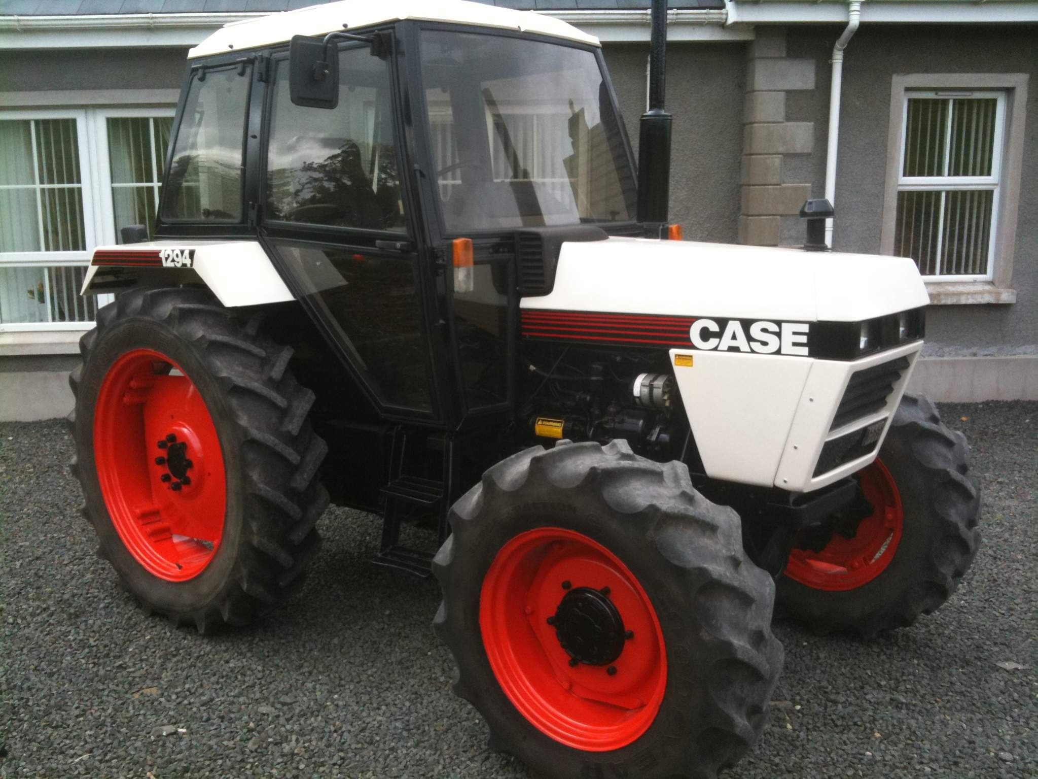

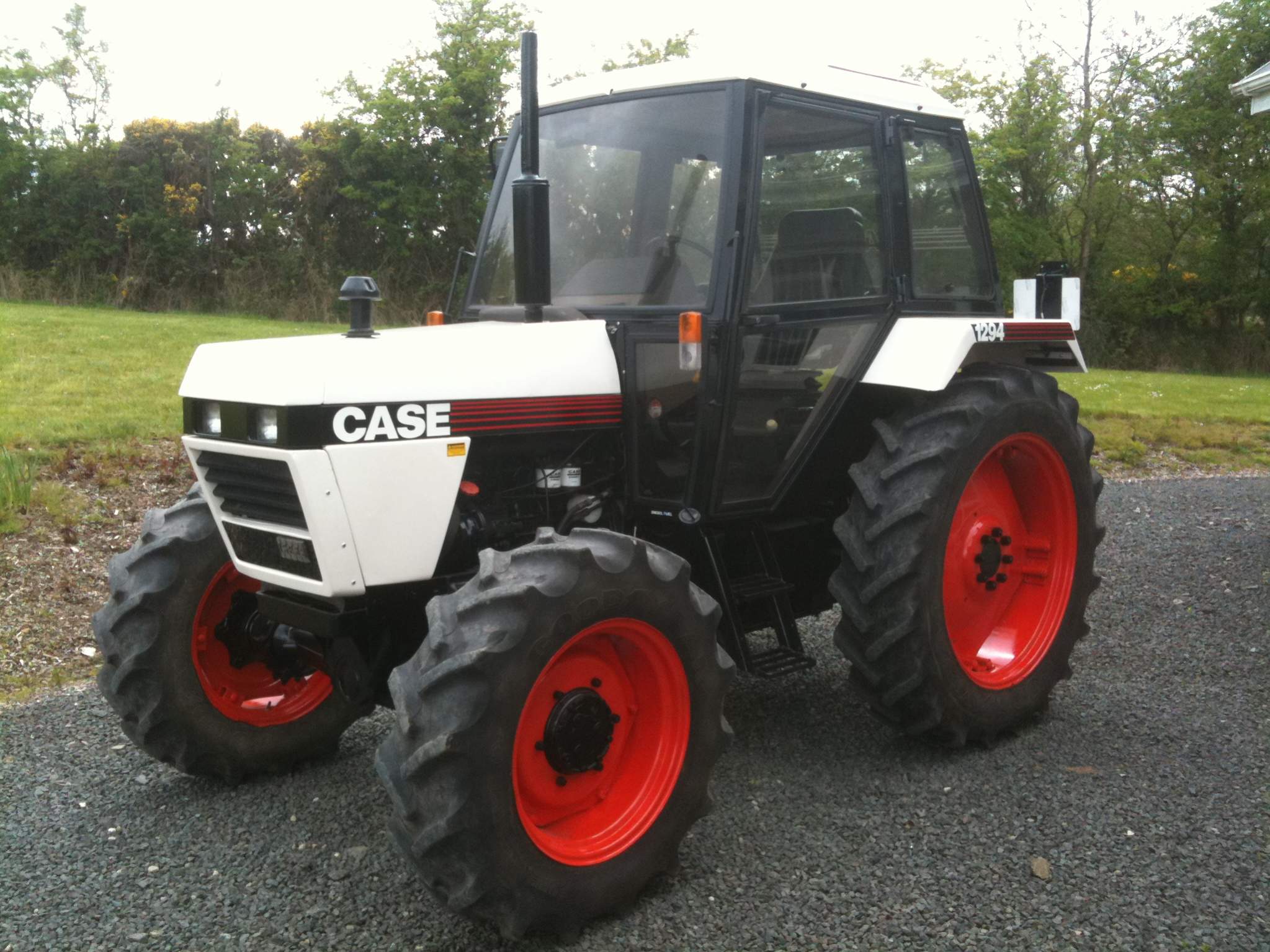

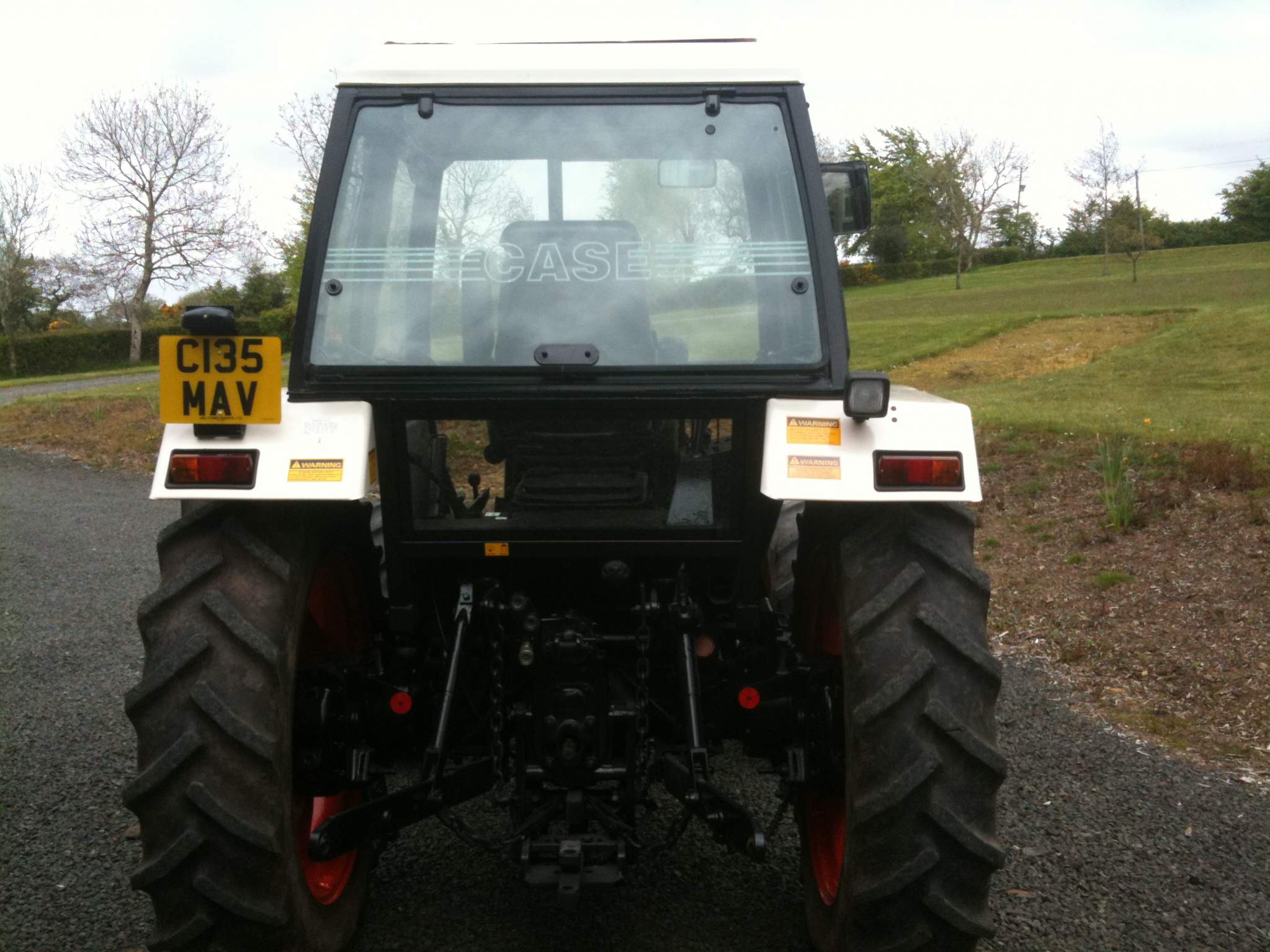

It's finished.... well almost. With this type of repair there are always a few loose ends to tie up.
The cab linings are in and all the decals are on.
All the lighting, of which none had previously been working, is all now fully functional. Some of the previous owners electrical "repairs" and splices into the loom were to say the least, interesting !! The short circuit on the pre-heat had burnt out the ignition switch so a replacement had to be sourced and installed. Fortunately most of the electrical items of this era are Lucas and are common to Ford, Massey, Leyland and the like.
I have the wiper motor and arm to refit, but first need to source a fine thread half nut or locknut as sometimes known to attach the motor shaft as it comes through the cab. Proving surprising difficult to track one down.
The fuel gauge was not working The disconnected wire at the sender unit turned out only to mask that the sender had failed. A new sender unit is on order via Sparex and should be available in next few days.
All in all, I'm very happy with the result. Wife now wants to know what I'm for doing with my evenings and weekends. She's even suggested I might sell and look for another project.
Hmm.... now there's a thought !!
