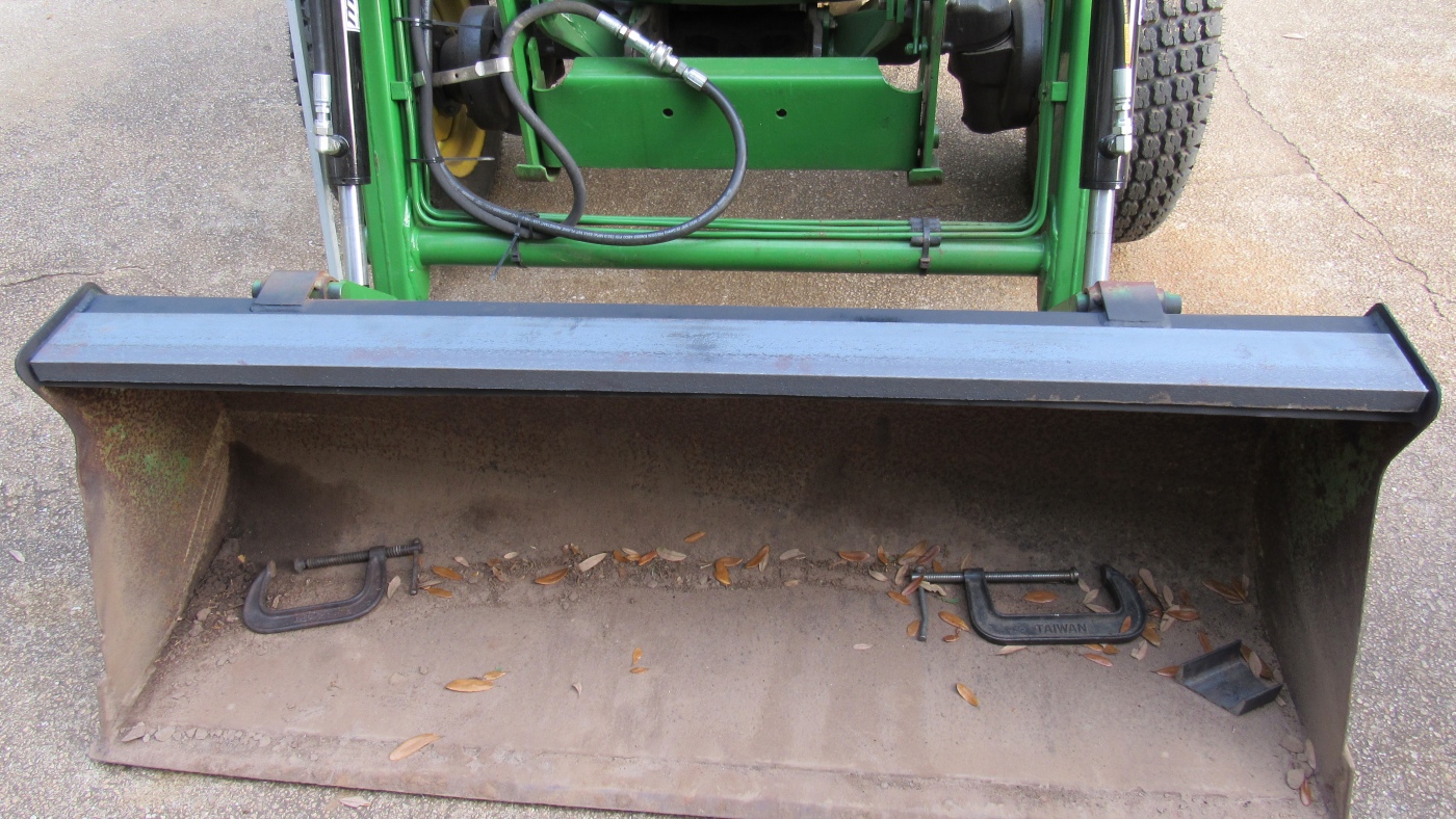

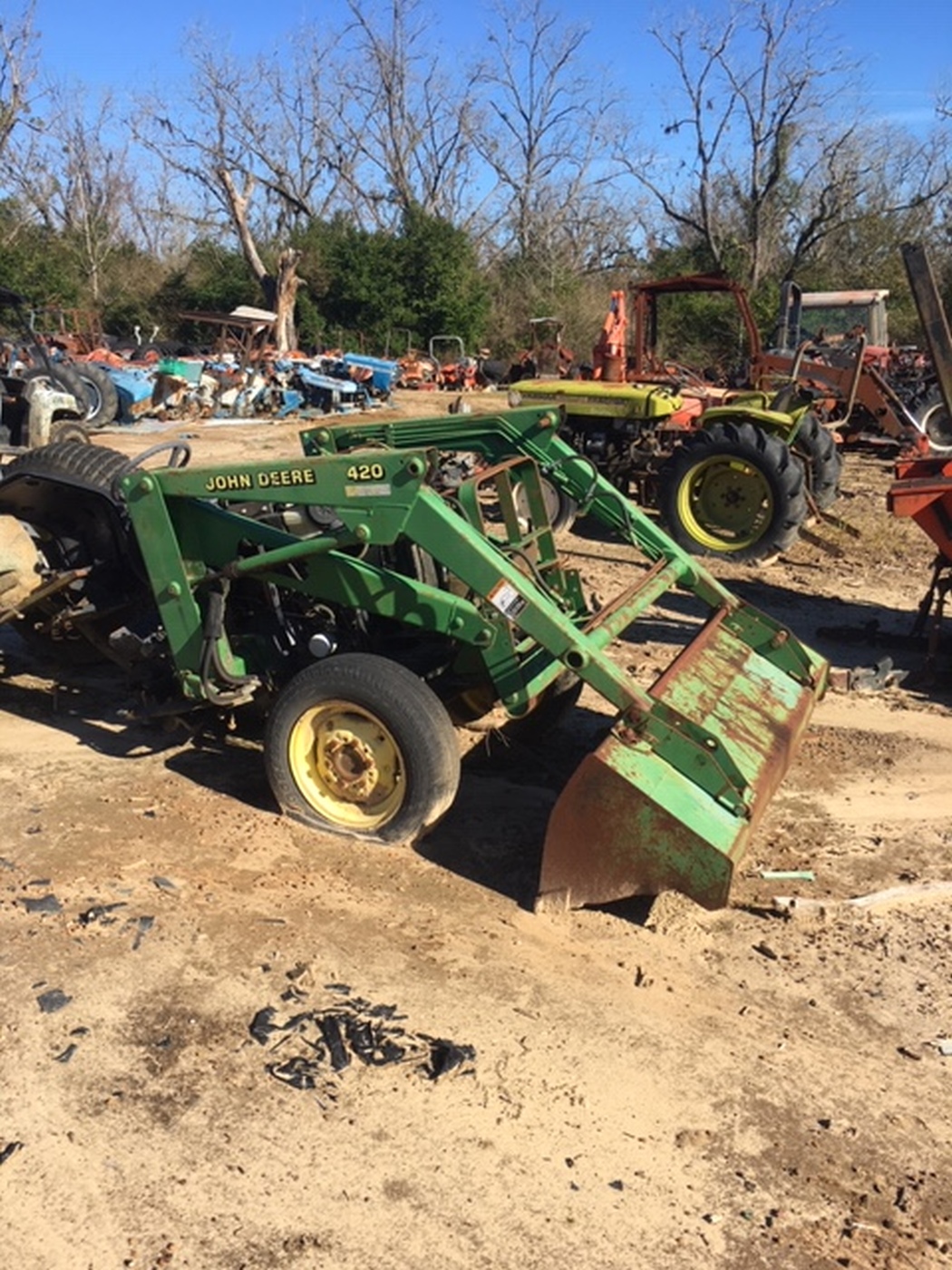

I've been fixing up a John Deere 4310 I bought at auction. One thing I added was a junk yard loader that needed cylinders and hoses. I outlined that in the JD section. It came with a standard 5 ft bucket that was in fair shape. I wanted to add the reinforcements that come on the HD bucket and weld some hooks on. John Deere's HD bucket is the same but has a piece of metal welded on the top and some strips of metal welded to the side lips.
This bucket had some surface rust, a slight bow in the top, and the right lip had some deformations.

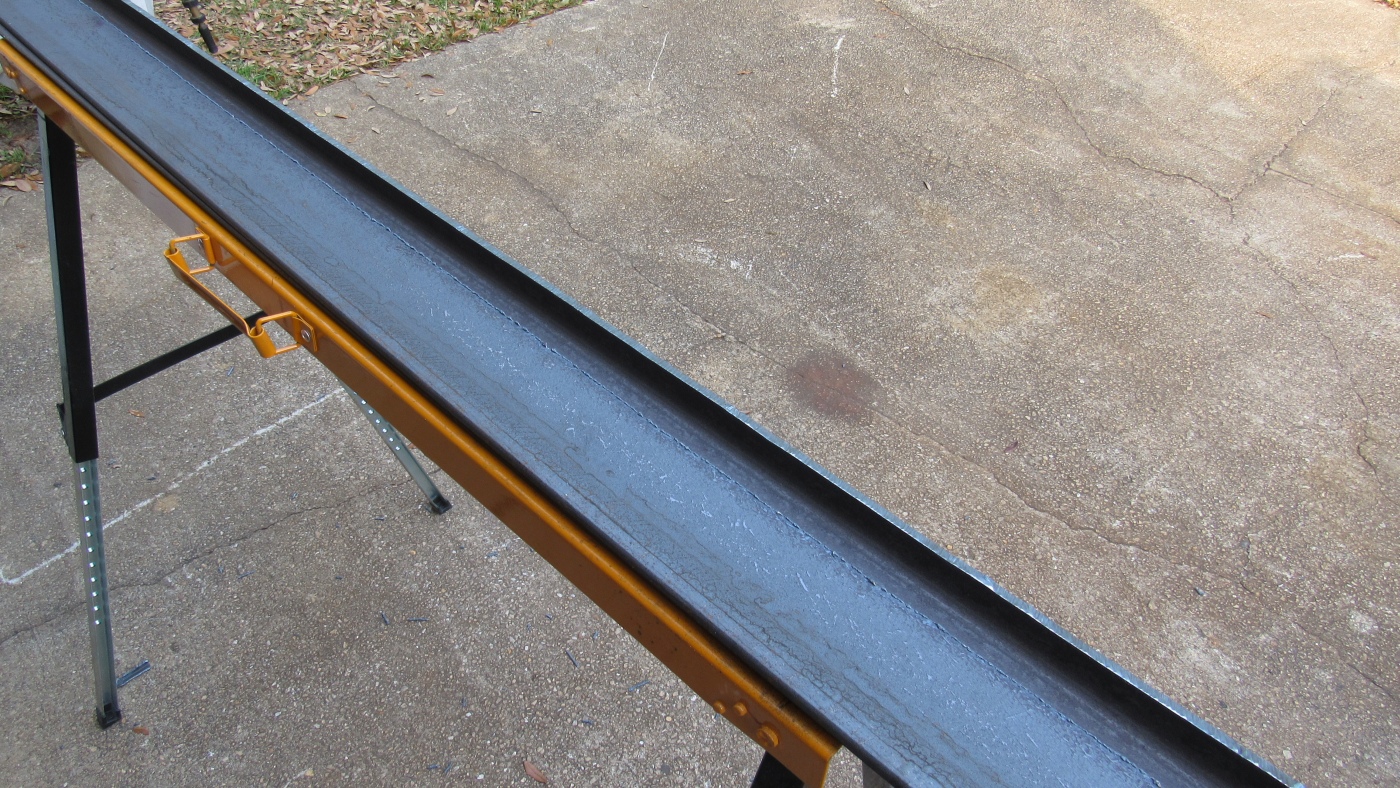

I had a piece of 4x4x1/4 angle left over from my landscape rake rebuild so i decided to put it to use on this bucket. I cut 3" off of one leg of the angle and used the rest for the top.

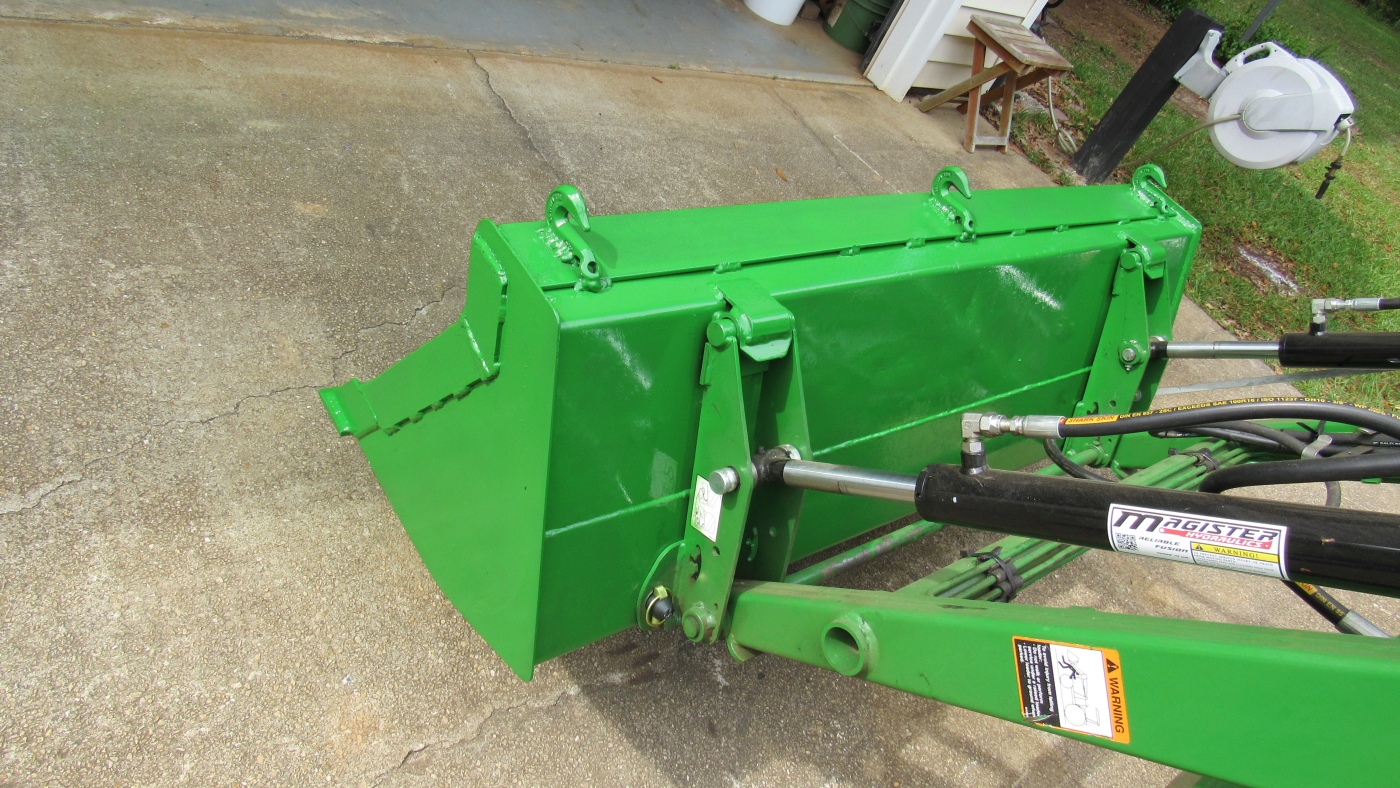

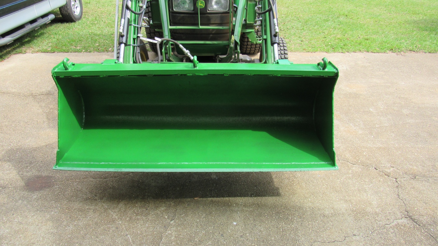

I just bought a couple of 2 packs of HF brand 3/8" chain hooks. I cut one ear off of those and shaped that edge to follow the bottom of the hooks to weld onto the angle. I didn't have much luck getting the bow out of the top but I was able to straighten the right lip edge.
I made some patterns out of cardboard and cut up some of the 3" strip I cut off the angle to make the side strips.
Should be a little stronger than stock and the hooks will come in handy.
I am still planning to get some metal to reshape the bottom. The way it turns up in the back makes it fairly useless for back dragging. I will need some plate that is 61" by 10" and another that is 61" by 4". I will probably close in the corners on that addition. I bet a lot of curl cylinders would have been saved if the factory made the bucket flat bottom and extended down from the attachment point. People are probably curling the bucket forward to back drag and bending their cylinder rods.

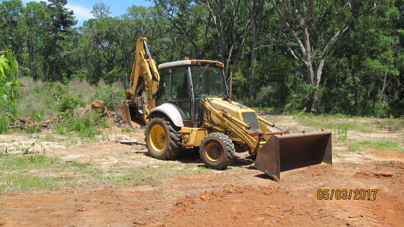

The bottom of my backhoe bucket is flat and can be used for back dragging with the bucket level.

That looks pretty straight, and the green paint is great.

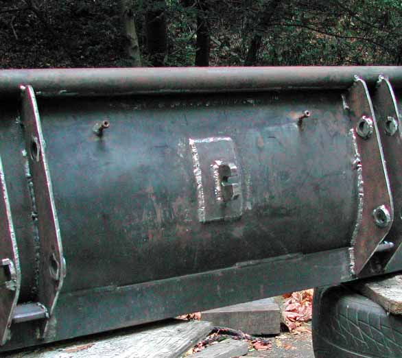

As for the lift hook in the middle of the bucket, I like something like this is the photo. It can be used above or below the bucket, does not bend the upper lip, and will detach from the seat. Got the idea from a grading contractor I hired many years ago. I also have one on my excavator bkt.
