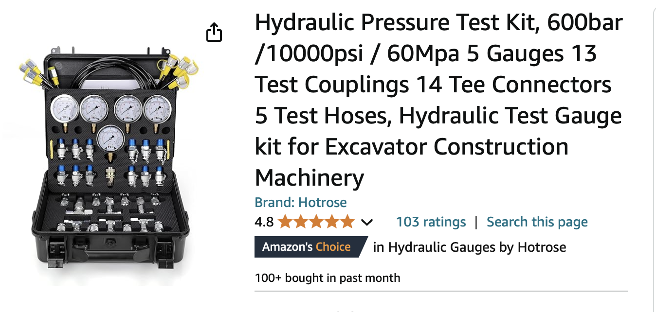

I've been following this thread now for a couple of years and have nothing that hasn't already been mentioned. There are already several really knowledgeable people working on ithe problem.
Does anyone think that some pressure gauge info would be helpful? I've been looking at the kits on Amazon and like this one. It has a variety of "T" fittings so that it can be put inline with just about any hydraulic fitting....except it might not fit that short regenerative fitting that between Leonz relief and cylinder.
I'm a believer in the value of hydraulic pressure gauge info & might just order this one for my own use.... $170.00
rScotty
