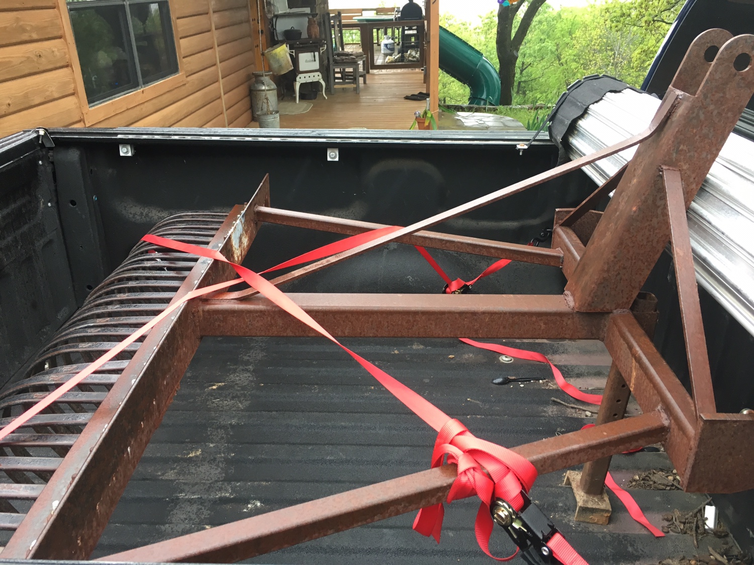

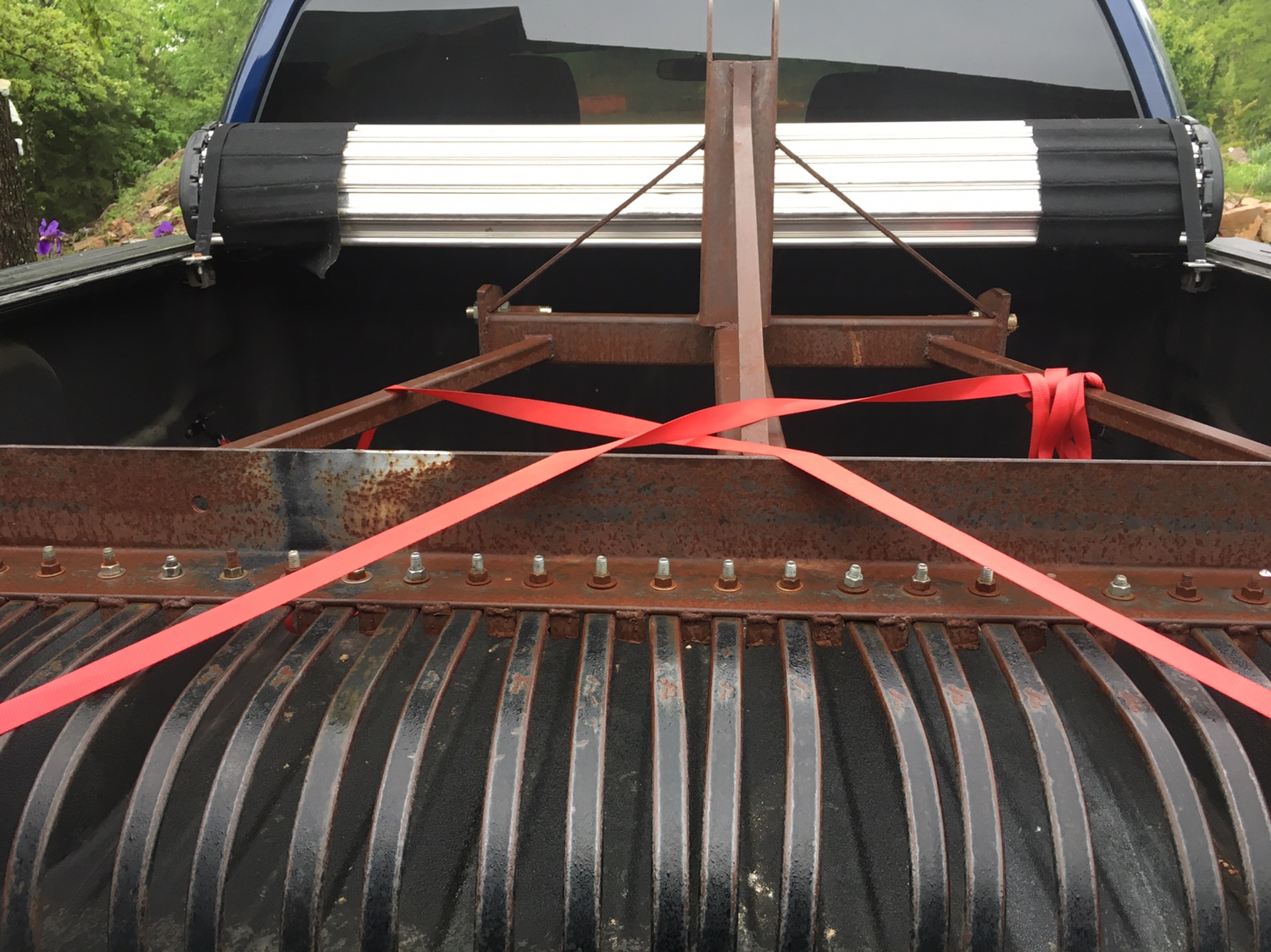

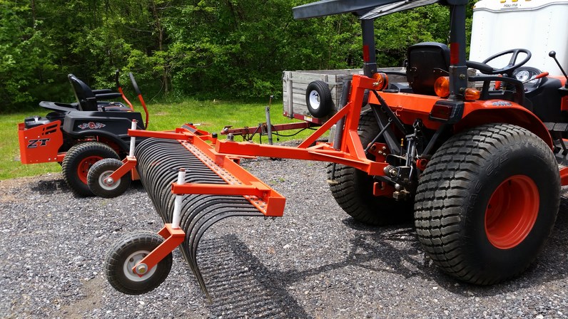

I picked this up today because I've been wanting a rake and the trade went well towards me.
As you can see, it's homemade and not very well thought out. The little tabs between the tines look a little "hokey" also.
I was going to make or buy one soon so the tines being near new was the main reason I got it as a good start of a project.
Any input from you guys on how to modify this to get the best use from with saving and reusing as much of it as possible?
I'm thinking on putting a swivel of some kind in for angle setting and moving the two outer bars to diagonal from the lift point areas to the main beam to allow that.
So angle adjustment.
QH compatible
Kickstand
(Maybe gauge wheels. Do I want them?)
(Maybe use it on front SSQA?)
And of course a cupholder.
Any other armchair thoughts out there before I fire up the welder and bandsaw?
Thanks,
Lenny

You guys have any ideas for making the pivot portion? Axle,bearing, etc.
Thinking of using a trailer stub axle.
/ Remake a Landscape rake #6

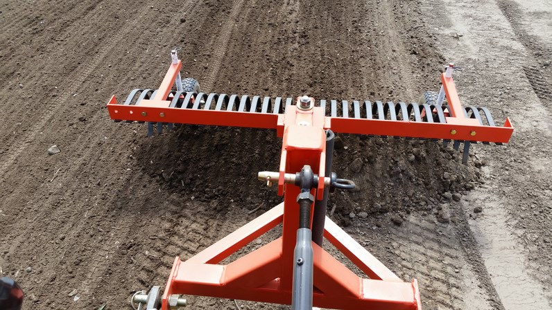

I built a rake a couple years ago and it's one of the best implements I have!
I just used a 1" Grade 8 bolt for the pivot and haven't had any problems. I decided to only have a 15* left and right swing. I really didn't see myself using it angled all that much. I build guide wheels because everything I read said they really helped in leveling out the grading, and I'm glad I did! I do have to build extensions for them as they are a little too close to the tines. But when pulling straight it wasn't an issue. So far I have not used it at an angle.

Are you wheel assemblies fixed or can they be adjusted?
If adjustable, what is your proven modus operandi ?
I just cut come PVC pipe spacers to adjust the height. Just add or subtract from the top and bottom. Most are 1" and then I have a 1/2" and 1/4" for finer adjustments. I didn't have any steel pipe that was the correct size, the PVC was handy. I was going to pickup some pipe but just haven't gotten around to it. The PVC has actually worked out fine. There's really not a whole lot of weight riding straight down on the wheels.

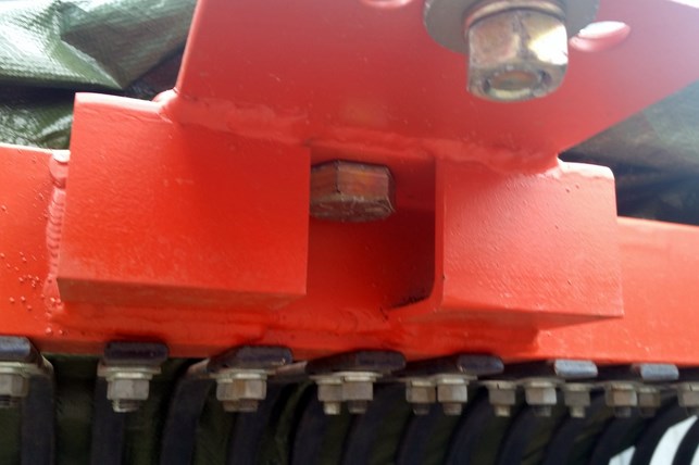

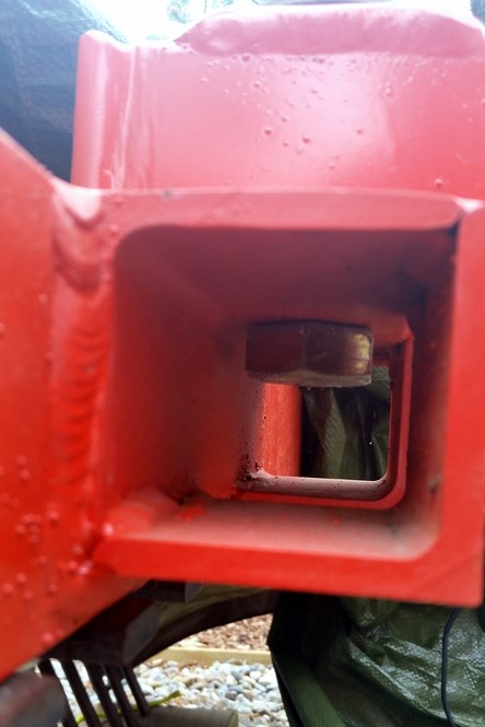

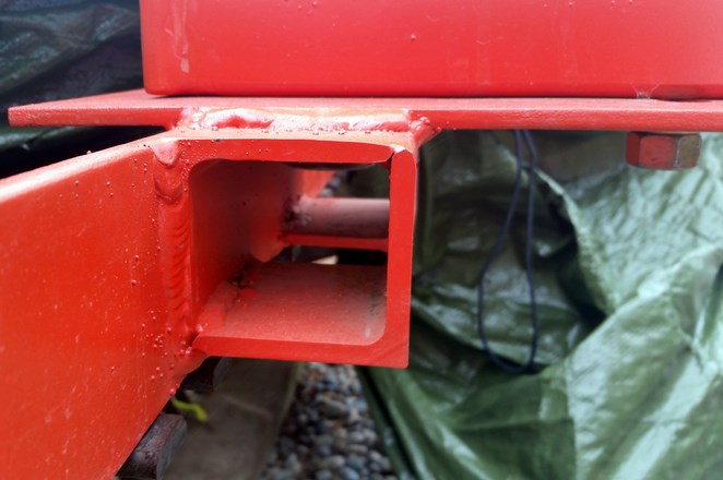

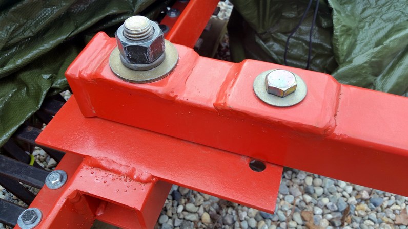

Nice. Can you show a close up of your pivot? The bottom part if possible without too much trouble.
I really like your implementation of the gauge wheels. Receiver hitch tubing is one of my favorite ways of adding things. IMG_2527.JPG
/ Remake a Landscape rake #11
No problem. I'll take a picture of it once I get back to the house a little later this afternoon.

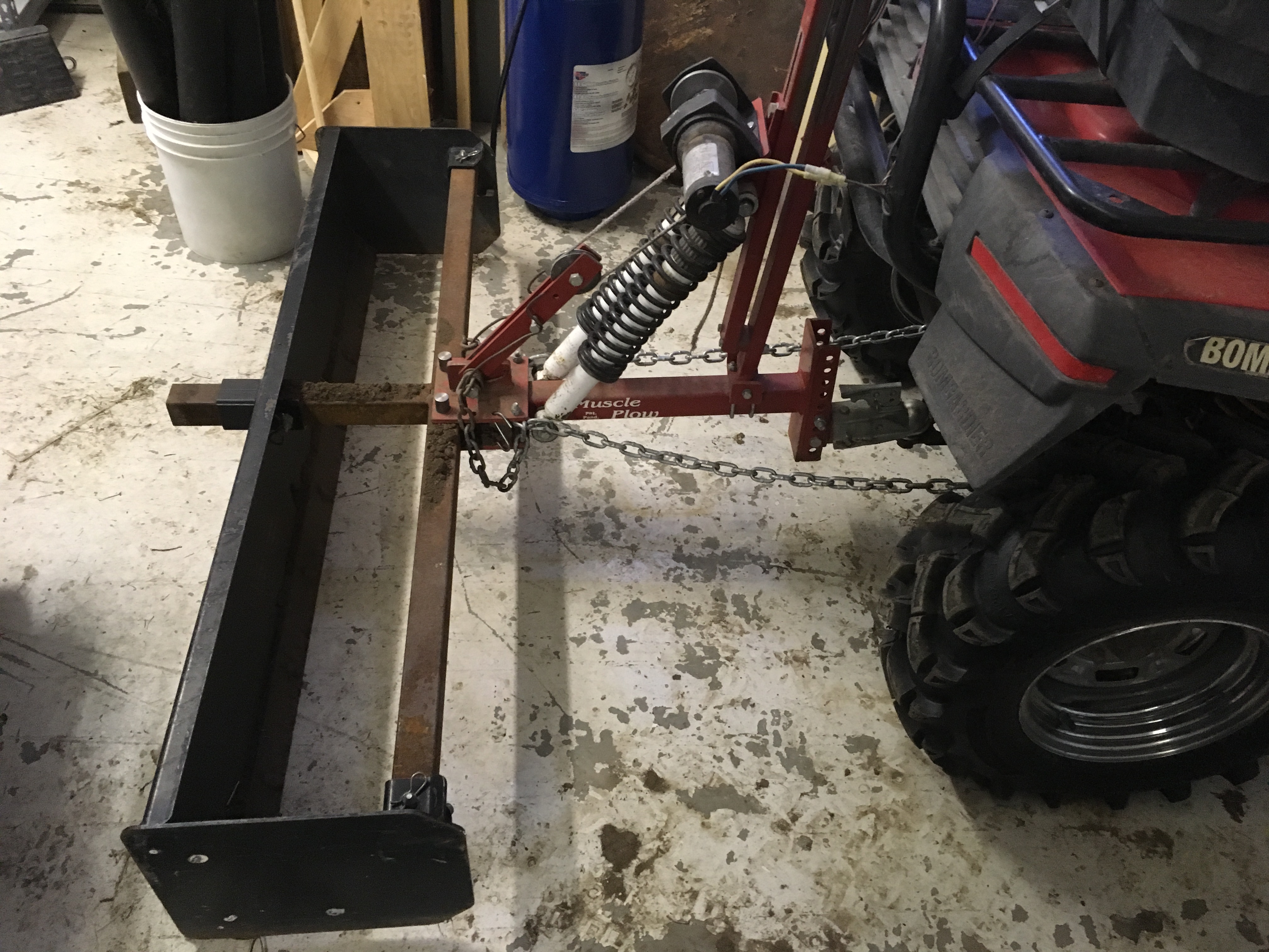

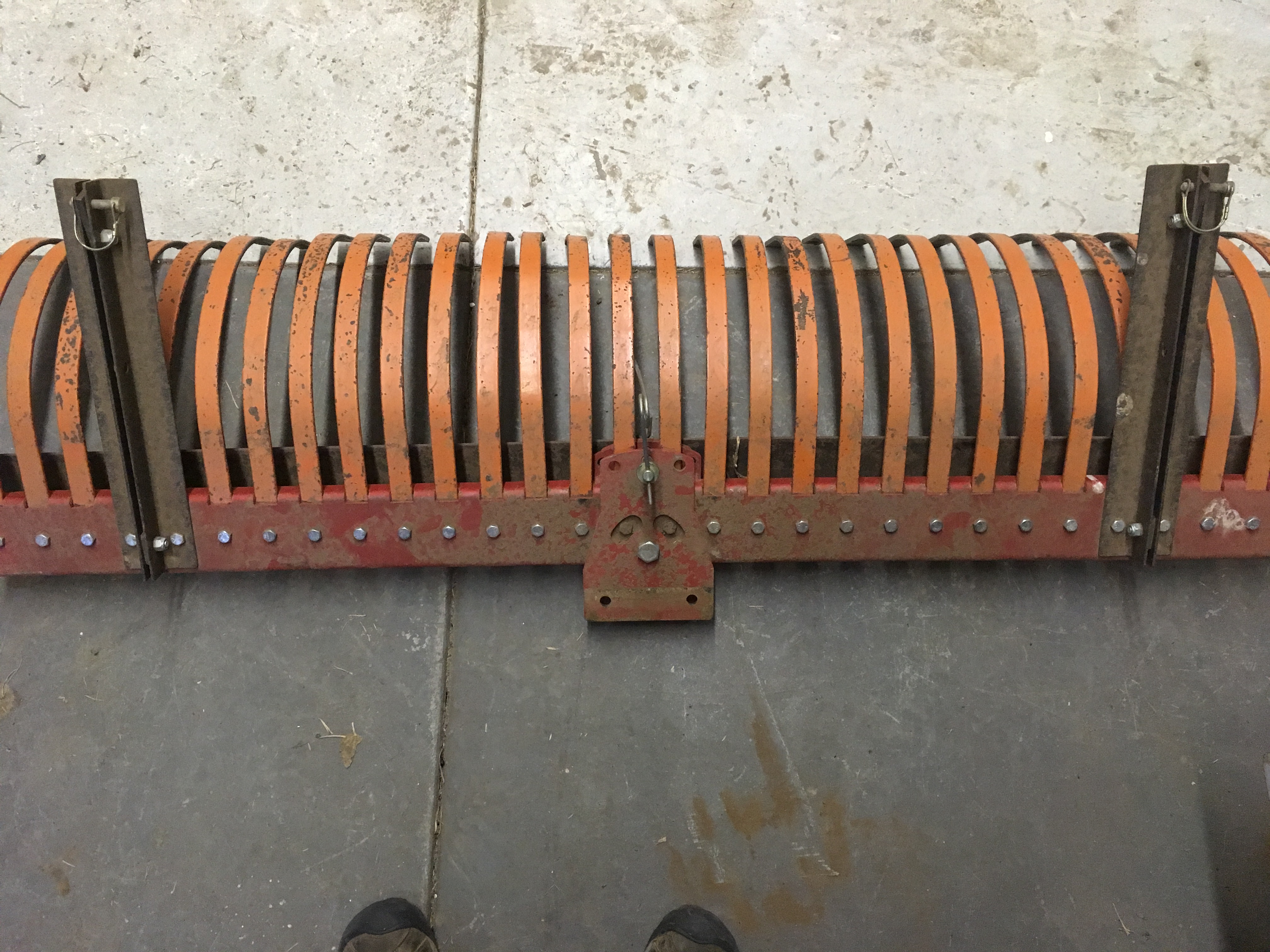

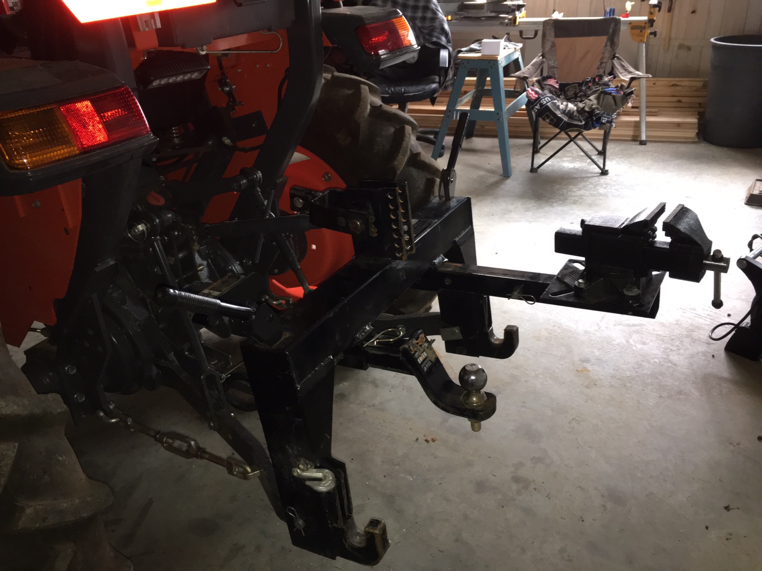

I built this for my ATV a few years ago. It might give you some ideas but you will need to make everything bigger for a tractor version. It has straight position and two angle positions each way. Plus the fold down blade and I have a scarifier that isn't shown.
I can take some better pictures this weekend if needed.
I just swap out the box blade and rake as needed, takes just a minute to do so.
/ Remake a Landscape rake #13
lennyzx11...
Here's the pictures you asked for...
#14
Perfect! Thanks for the pictures and the ideas everyone.
Lenny

How did you cut the square holes that the tines go through?
