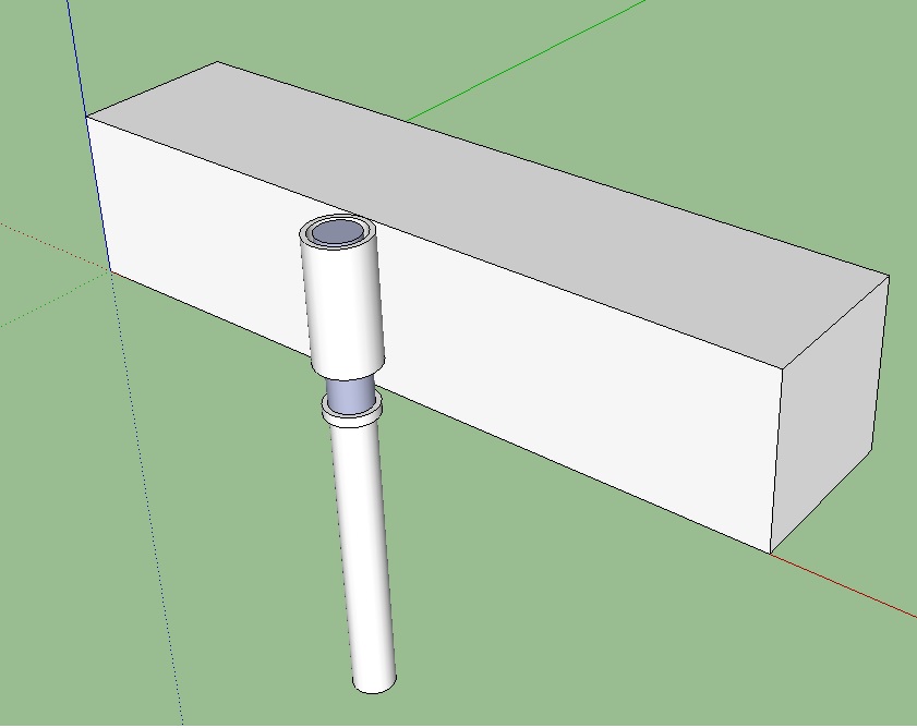

A simple idea is cut your pipe down so it reaches an inch or so out the top of the larger pipe on your frame. Weld a washer or collar onto the pipe about 3-4" down to hold the weight while it's sitting on the kickstand. Don't use a pin, so then when you pick the rake up next time the pipe falls out without getting bent (this is assuming you don't forget to raise it up before driving away!). If you worry about losing it, add a piece of chain between the pipe and your frame long enough that you can flip the pipe upside down and drop it into the holder from the top.
The annoying part would be getting the kickstand back in as you're disconnecting the rake. For that I'd drill a 3/8" or larger hole right at the top of the kickstand, then use a short 1/4" bolt welded to some chain so that with the rake raised on the 3 point, insert the kickstand from below, put the small bolt in the hole to hold it in there, then when you drop the rake onto the ground, the pipe slides up 1/2" or so and the bolt falls back out so you are safe from forgetting to remove it the next time you use the rake. Having said all that, not sure it's any simpler than your idea!
A quick sketchup:
You had me until how the 1/4" bolt would automatically fall out when the rake is raised. Otherwise, I like the idea.
A quick sketchup:
This makes the most sense and it sort-of is what I have done. I made my own stand and just don't put the bolt in the retention hole and when I pick the rake up, the pipe drops out.

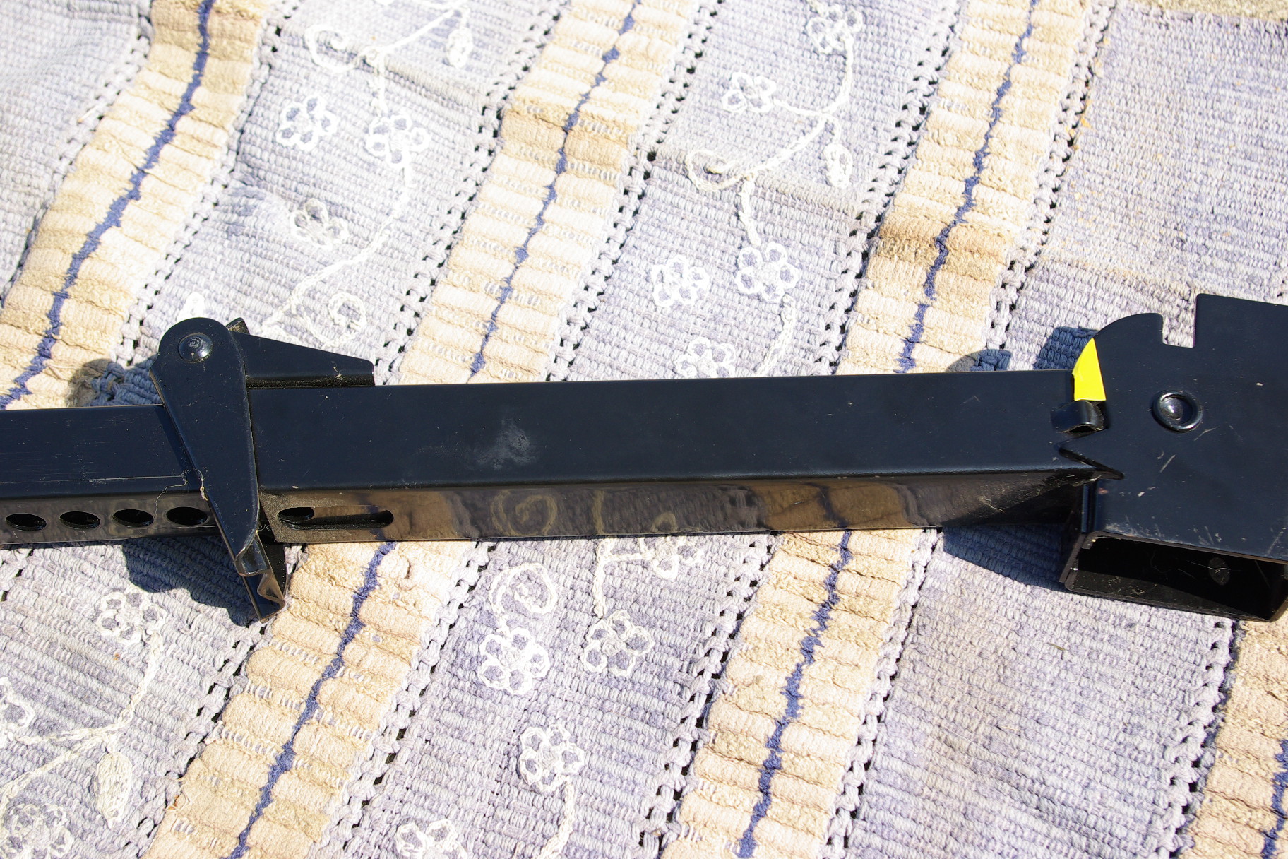

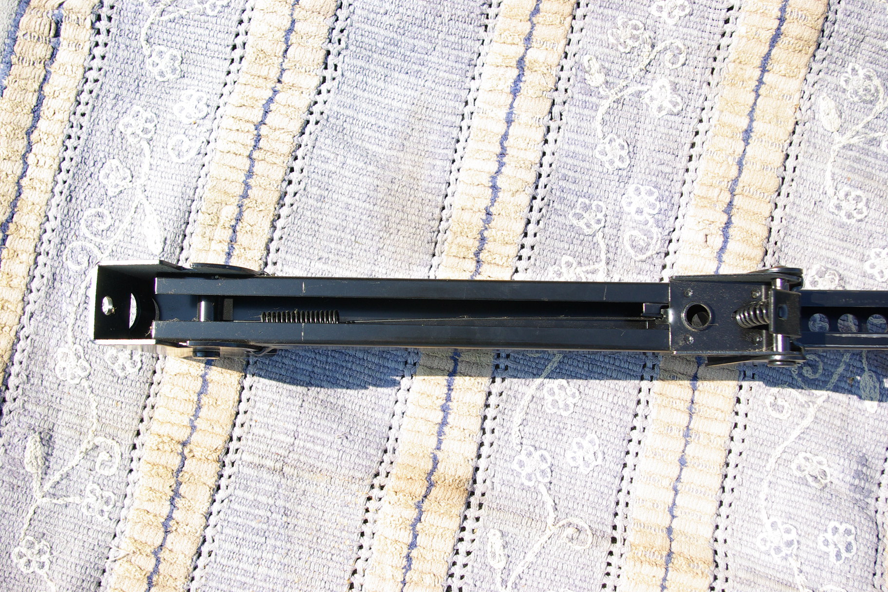

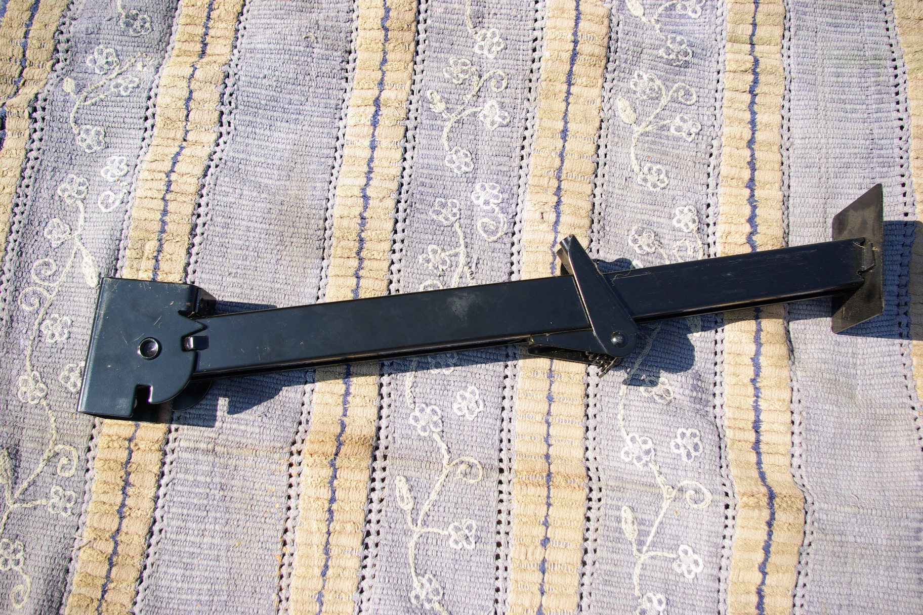

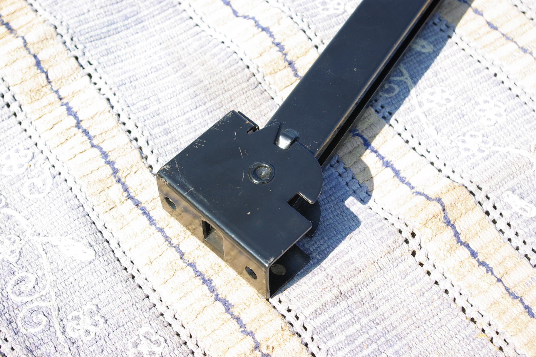

This is a travel trailer leveling jack I picked up at a supply house. Effective length is 16" to 23". It is notched in both the up and down position, but by grinding the down notch away (yellow tape), it would swing when moved. The top end of the long spring would have to be moved slightly to assist in the auto-fold mode when drug along the ground. This was marked $14 but I think I got for less. IMGP9935.JPGIMGP9933.JPGIMGP9934.JPGIMGP9932.JPG
