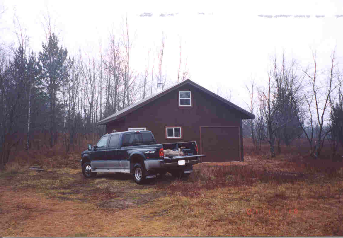

Every year at this time I get tired of carrying in water to the hunting shack. Has anyone installed a sand point or other type of well where a hand pump will be used. This is in northern Wisconsin, so freezing is a concern. So is cost and capacity. Any comments or suggestions are appreciated.

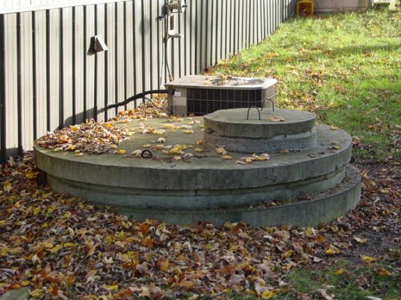

I took an old concrete culvert and layed it open top/bottom. This is buried 6 ft in the ground and that is where I started my sand point. I had to go another 16 feet to hit good water. I also had a top made for the culvert and in the winter I lay leaves over the top and for the most part now the ground temperature keeps the pump and pipes from freezing up. I wished I had pictures for you but I don't. I may be up there this afternoon and could take finished pictures for you.

Attached is a picture of my well pit made out out of a concrete culvert. This is for my cabin. The pit is about 8 feet deep. As far as freezing I have very little trouble. I usuallly put a electric heater down there on a thermostat. If the pump is used on a daily basis it won't freeze even without the heater.
