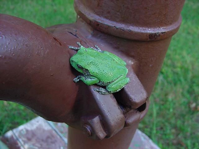

I have a well/hand pump ay my camp in northern mich. and use it year around. Have a weep hole drilled in the drop pipe, down about 5' so water will drain out and not freeze.
had this one drilled, not driven per your interest, attaching a picture of my "Hand Pump/Well Helper".
penokee /forums/images/graemlins/smile.gif
