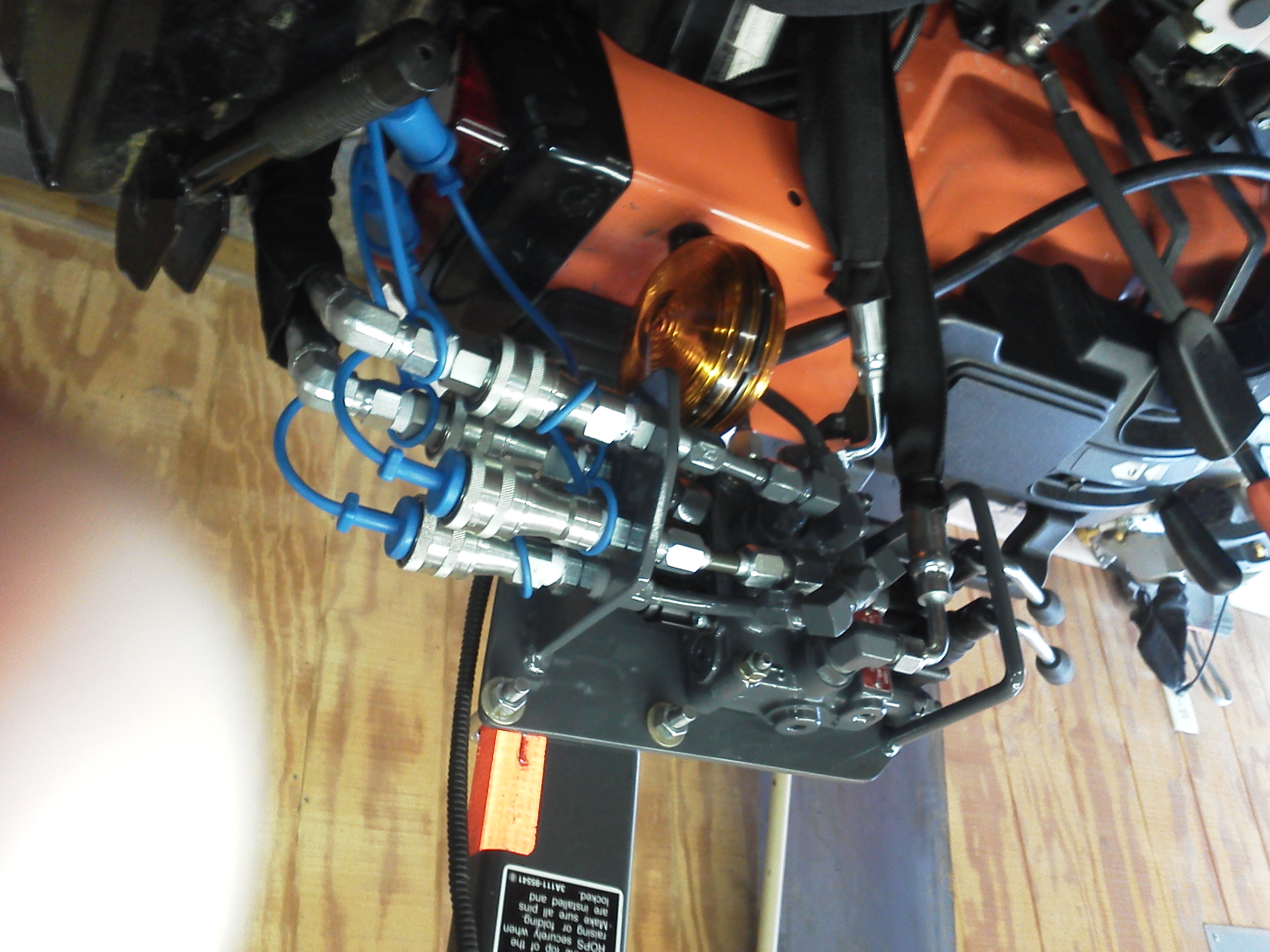

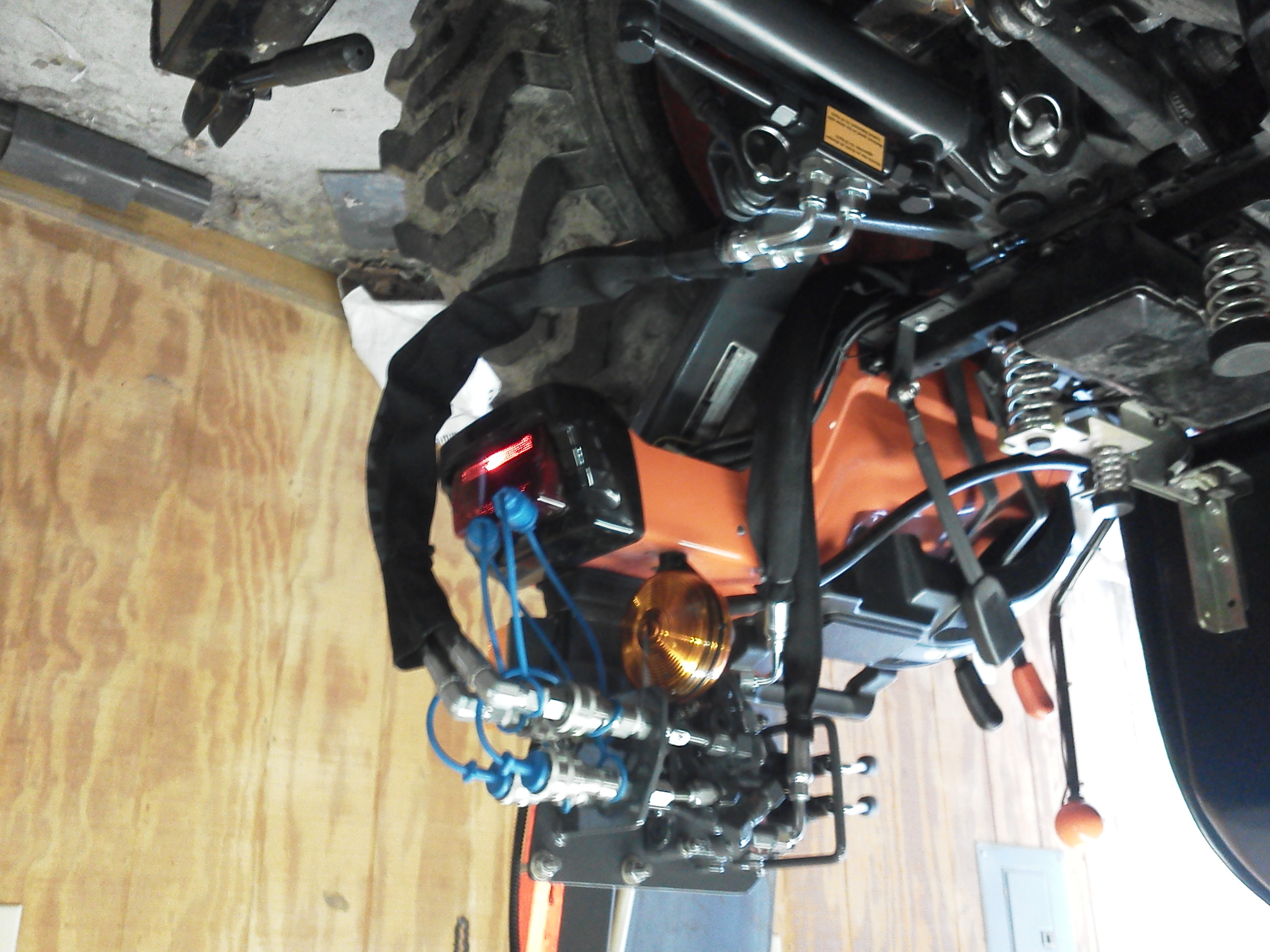

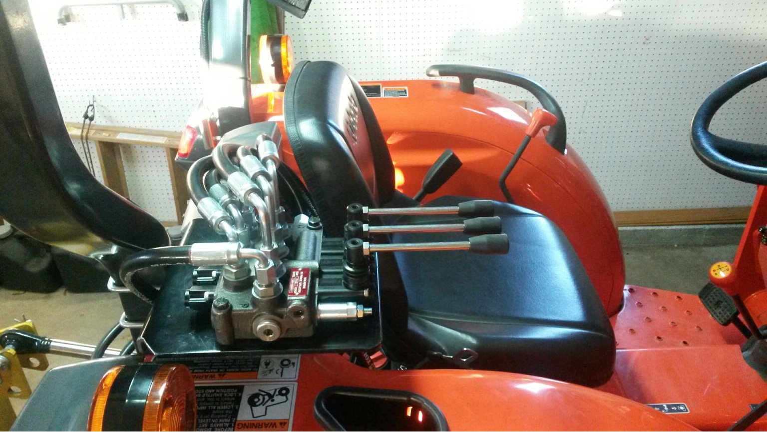

Knowing that I would be looking back while adjusting the T&T, I mounted mine on the ROPS. Reaching forward and looking backwards just wasn't going to work for me. The mount was from Brian at Fitright Hydraulics. View attachment 478378
Now that's what I'm talking about!
Given where my RR mount is located, this would be very convenient, for both the operator (me) and the hose installer.
Something more to think about....

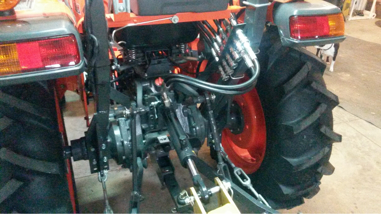

And how about pics of the rear of the tractor, showing the TNT and QD mount? BTW, is that the Chief 3 spool valve from Bailey's?
Thanks!

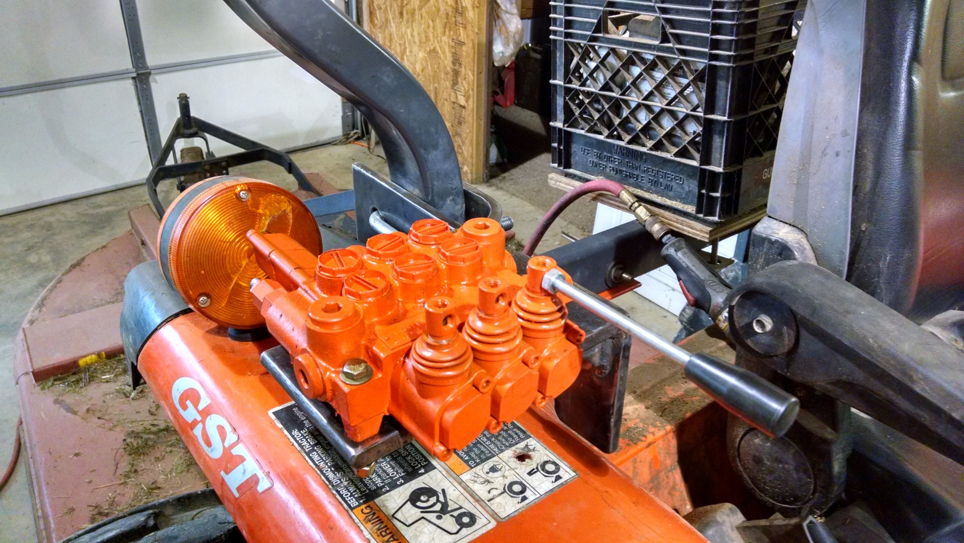

Here is the rear without the side cylinder. I got it after I took this picture. I used 3/8 couplers instead if the standard 1/2 couplers to reduce the space the 1/2 would require. They work great. ImageUploadedByTractorByNet1471916602.774541.jpg

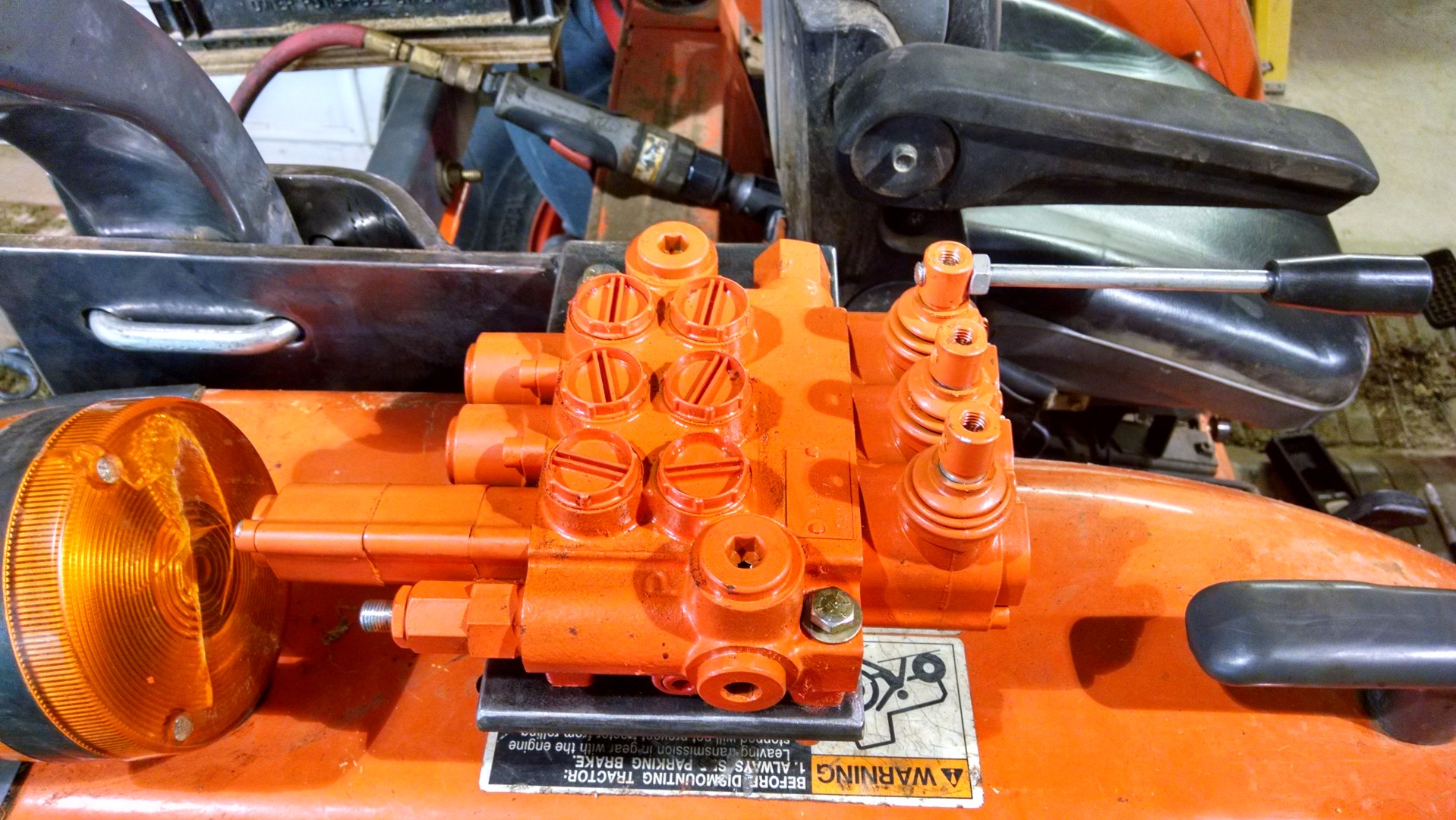

I see I forgot to answer the type of spool valve I have. It's a Prince Wolverine valve from surplus center

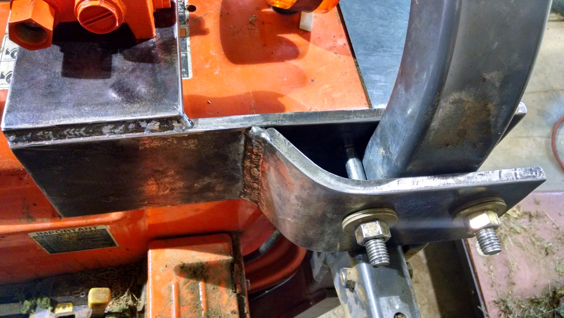

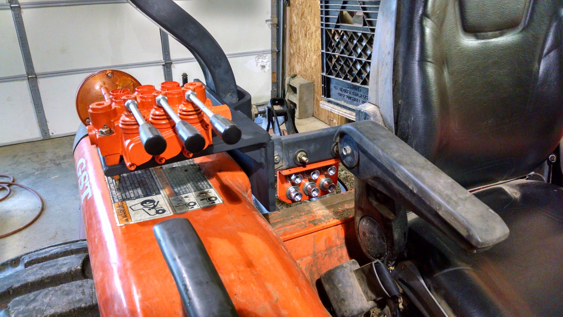

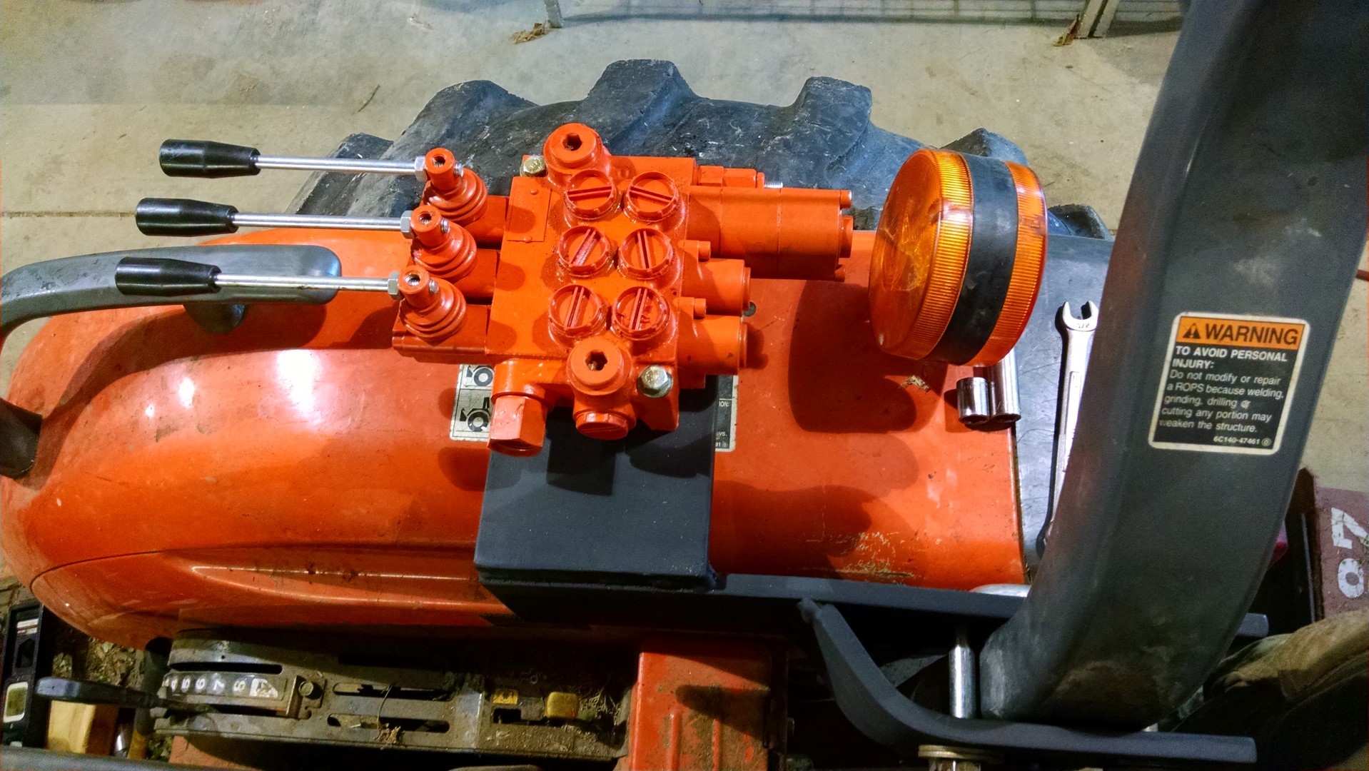

Here's mine on the B2620, I'm getting ready to add another 2 spool valve on the other side of the ROPS1472011952355.jpg1472011978459.jpg

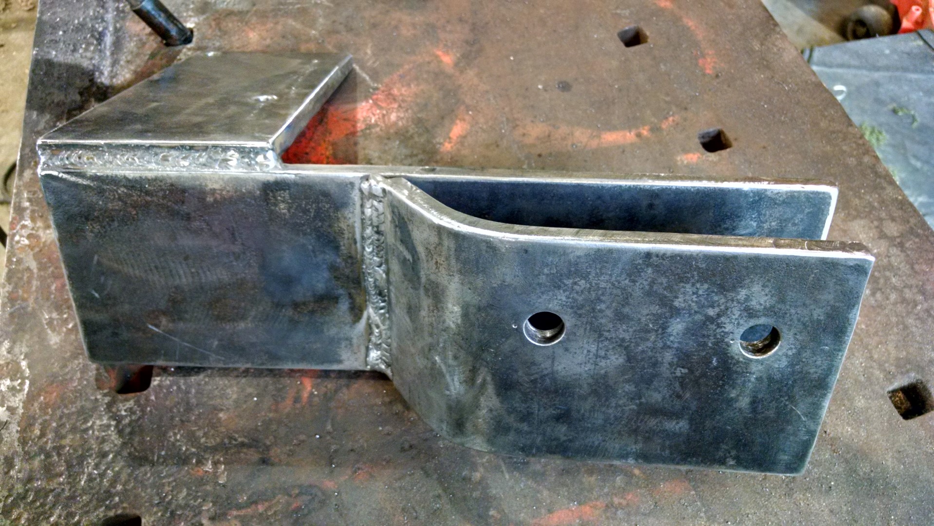

Cool! Did you build that mount? I like the guard, good idea! Thanks!
   / remote Rear Valve Controllers: Let's see some pics! #20
Re: Rear Remote Valve Controllers: Let's see some pics!

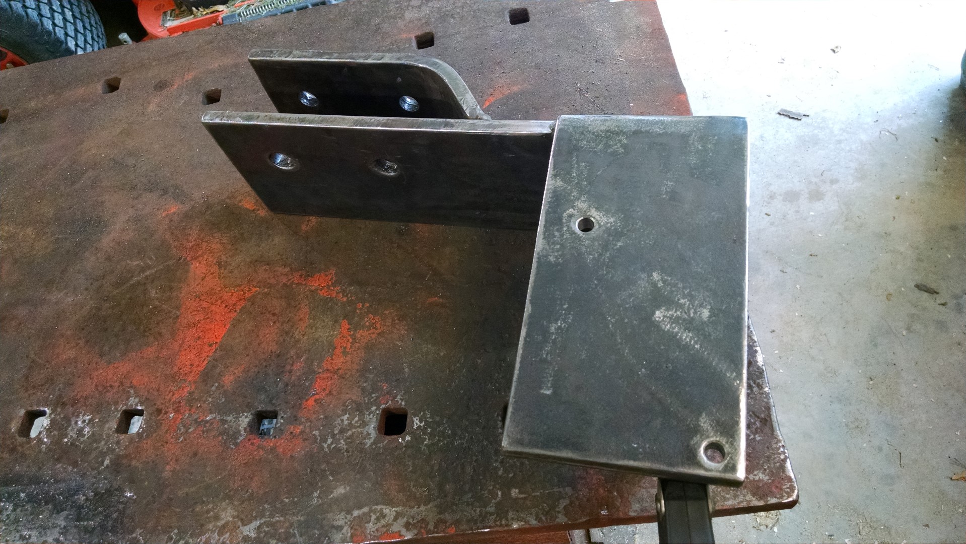

Sure did, the gaurd is partly because my arm rest on it if I turn around, that valve gets pretty toasty after some heavy loader or backhoe use.
Sorry the pictures are turned upside down. Here's one of just the mount.
