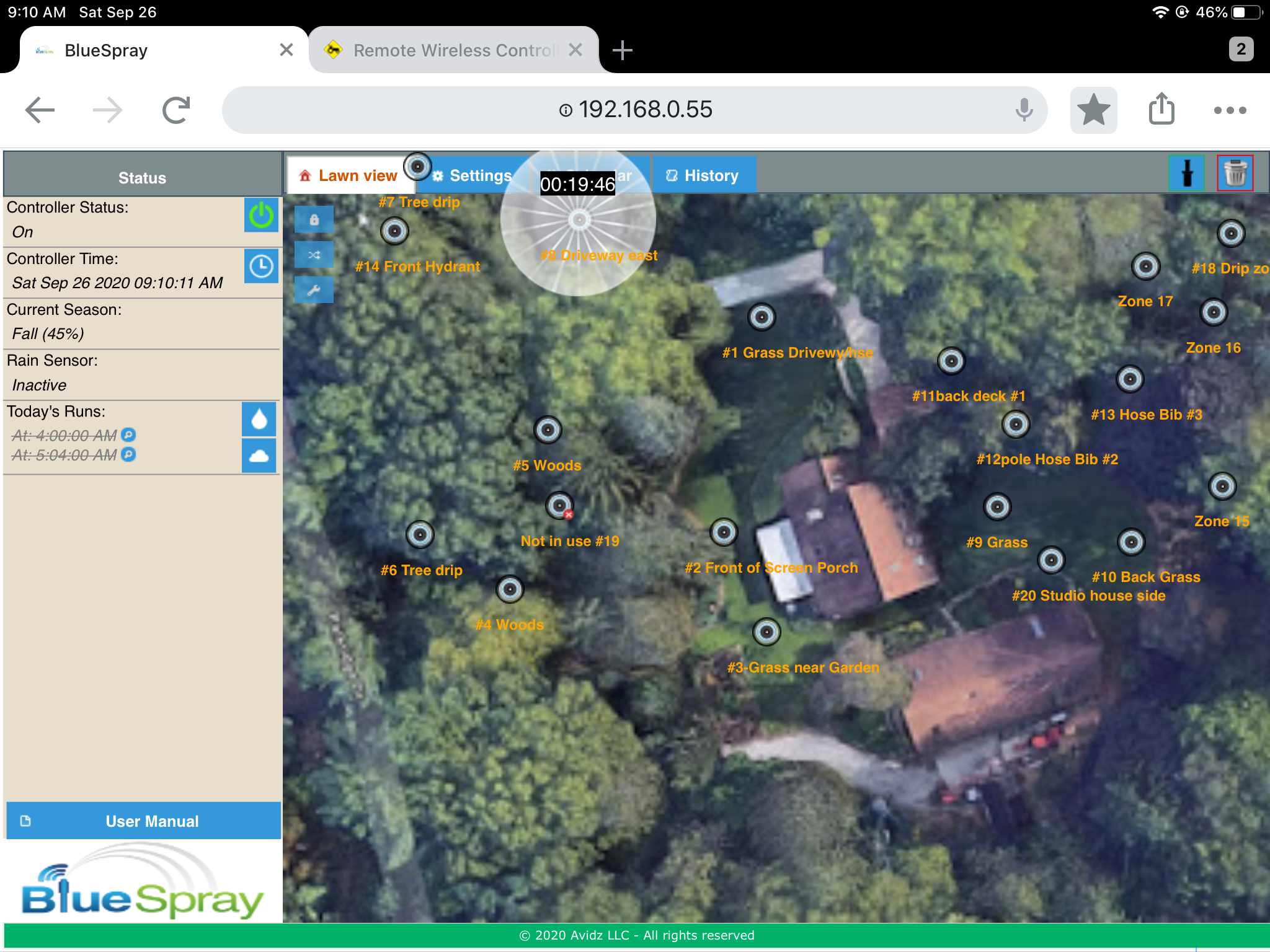

I have a 24 zone wifi controller by Bluespray connected to a hard wire mesh of rain bird valves on traditional system. My longest run is approaching 200 ft with 18 ga solid direct bury cable. In Bluespray, you set up programs of what valves and how long and then calendarize when programs run. I love that I can set up a fall blow out program of 2 minutes each zone and then time between zones at 3 minutes for my compressors to recharge tank. I hard plumbed in a quick connect air valve and the hose jumper to my air system.
I run the fall program a couple of times and walk around the yard to see that only sir is coming out. It supports a pump relay which I used to double up cable zones. Relay off, zone 9,10,11,12. Relay on, zone 13-16 . On same wire
Here is a picture of yard set up ( from google maps) . With a zone I started for this example. Just touch a valve and a window opens where you set time to run. 5C91202B-4003-4DC9-8347-13B617116A4B.png

I should add, the picture shows a zone as a sprinkler head going off. You can’t map the actual heads, only a representation of the zone.
