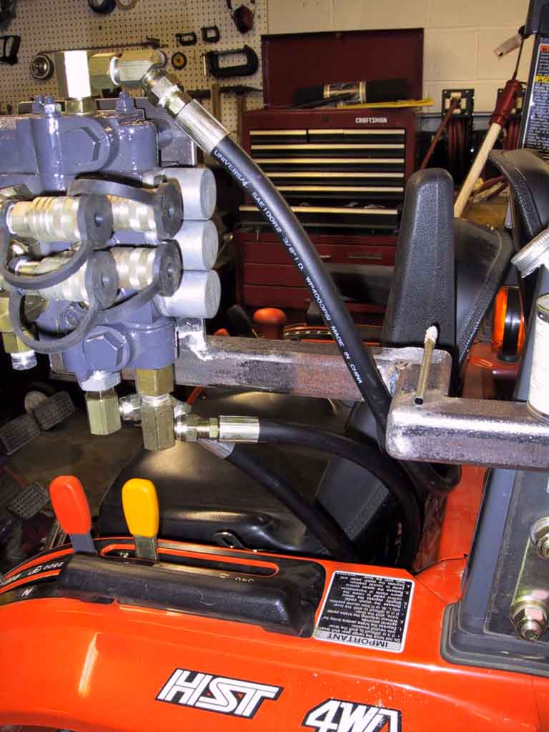

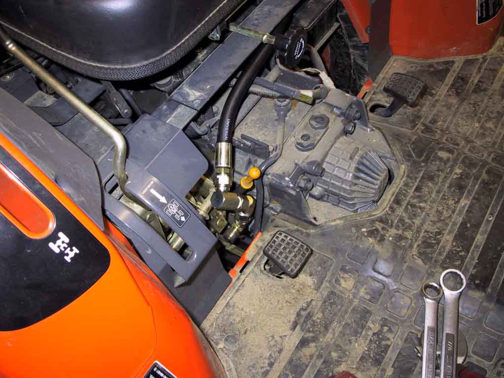

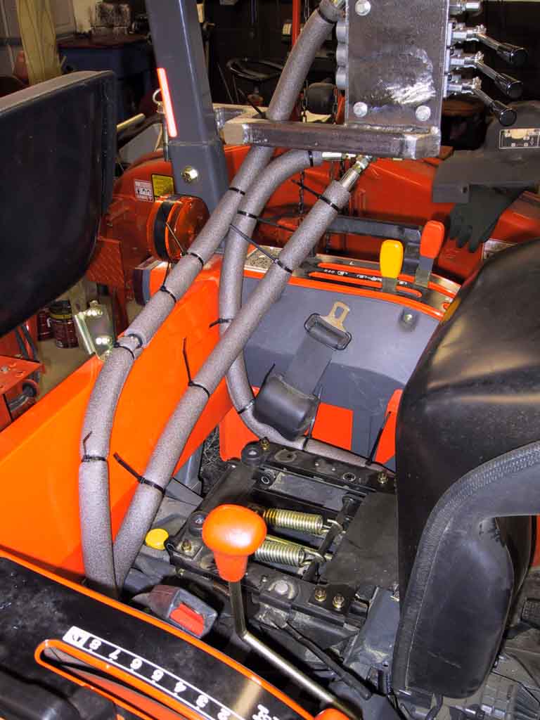

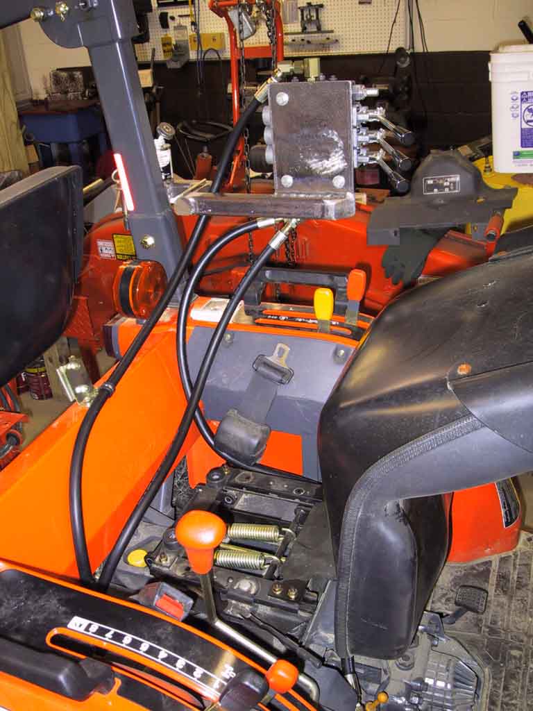

</font><font color="blue" class="small">( I hate to bust your bubble, but, that's a lot of extraneous plumbing for what could be done with electric splitters like we use on ag. tractors. )</font>

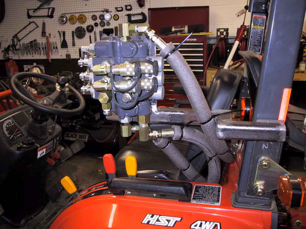

Daryl .... no problem, doesn't burst anything of mine - not exactly sure what you are referring to here as "extraneous" - can you be a little more specific ? .... the images I've attached are simply a 3 spool valve with a pressure line (48"), powerbeyond line (36"), and return line (48") - a fairly standard setup from what I've seen of the posts here on TBN, other than perhaps the location of the valve itself and the fact that on a couple of connections I have used more than a single fitting to accomplish some bends. You aren't by chance referring to my initial question about the cabled remote control are you ?
</font><font color="blue" class="small">( A 2 circuit unit is $399.99 and a 3 circuit unit is $429.99 and they come complete. We use them all the time. )</font>
I have $215 in the 3 spool valve, less than $30 in hoses, and probably less than $100 in fittings - so I'm probably in at least $100 cheaper than a diverter.
</font><font color="blue" class="small">( You have way too much plumbing. )</font>
Please explain in more detail.
</font><font color="blue" class="small">( More plumbing equates to more joints and more chances of a failure or leak. )</font>
Yeah - I have a couple of extra fittings in a couple of spots to accomplish some bends if that's what you are referring to.
</font><font color="blue" class="small">( Try www.valu-bilt.com Keyword: hydraulic multipliers )</font>
Comes up with: "Sorry .... No items were found matching your search"
I am familiar with electric splitters - wanted to stay all hydraulic.

Extraneous:
I deal with high pressure hydraulic circuits everyday in my job. More fittings, hoses, terminations, etc., mean the chance for more failures. I'd not want a 2500 psi hydraulic line wrapped with pipe insulation right next to my physical presence. I have had a close up and personal encounter with ruptured hoses before and though the GPM rating of the equipment I am referring to is in the area of 26gpm, the static pressure is about the same. We go as far as to install lexan spray shields between the hoses and fittings and ourselves. Matter of fact, that is an OSHA requirement.
I don't want any high pressure lines that close to me. That is, in my opinion, asking for trouble. I think, that if you look at any OEM setup on any tractor, there is no physical presence of any hydraulic line within the operator presence area. If there are, they are sheilded either within a housing or by some other containment means.
I am not here to try to disembowel your installation. Just consider the safety aspect of it and what the next owner might be dealing with.
That's why my suggestion would be (rear mounted) splitters.

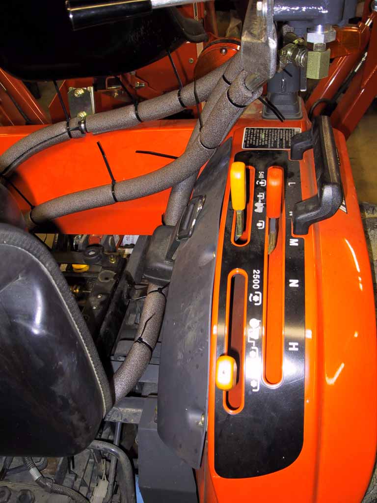

Daryl,
The proximity issue of the lines being so close the operator was one I struggled with when I was deciding where to locate the valve for the very reasons you cite. The lines are only 1992 psi and about 5 gpm, not 2500 - but I know that the 500 psi difference ain't all that much of difference /forums/images/graemlins/grin.gif
The pipe insulation was mostly to cut down on the chance of getting burned from hot hoses - more than to really protect against a leak. I might try and come up with some additional covering of some sort to cover the hoses up near the valve, which would be the only place where they have a clean shot at me.
The issue you raise is certainly a legitimate one.

I'd suggest getting a sheet of T3 aluminum, say 28 gage and forming a cover for the hoses and the termination. Either that, or run them in conduit, which you can bend. Especially the hoses right next to your shoulder. A blind side rupture could blind you. A pinhole leak can be almost invisible, but could penetrate your eye with no problem. You don't want to loose them.
Besides, you need to be around to challange my posts. /forums/images/graemlins/grin.gif

I was too - I wasn't sure whether Daryl was replying to my postings or your post initially - but I'm fairly sure he was replying to mine and was talking about the points where I used multiple hydraulic fittings chained together. For example to tie my remote valves into the loader return line I used a JIC run tee, a female JIC to NPT adapter, then a 45 swivel into that and then another 45 swivel on the first 45.
Would have been nicer to use a single steel line, but I didn't.

</font><font color="blue" class="small">( I'd suggest getting a sheet of T3 aluminum, say 28 gage and forming a cover for the hoses and the termination. Either that, or run them in conduit, which you can bend. )</font>
I think I would be inclined to go with the aluminum - should be easy to form and there's an aluminum wholesaler within 5 minutes of my house. Conduit sounds like it would be a PITA.
</font><font color="blue" class="small">( Especially the hoses right next to your shoulder. A blind side rupture could blind you. A pinhole leak can be almost invisible, but could penetrate your eye with no problem. You don't want to loose them. )</font>
No - I definitely don't. Realistically, to guard against hydraulic injection, I should only need to shield the hoses on the side facing the operator correct ? You have any idea on what the pressure decrease over distance is for a pinhole rupture ? I know that to check for hydraulic leaks you're supposed to use a piece of say cardboard and not stick a hand right up next to a hose ..... but at some distance the pressure has to fall off dramatically.
