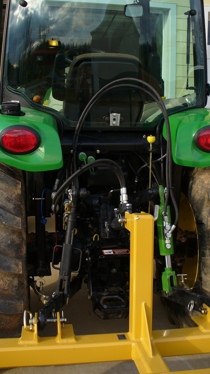

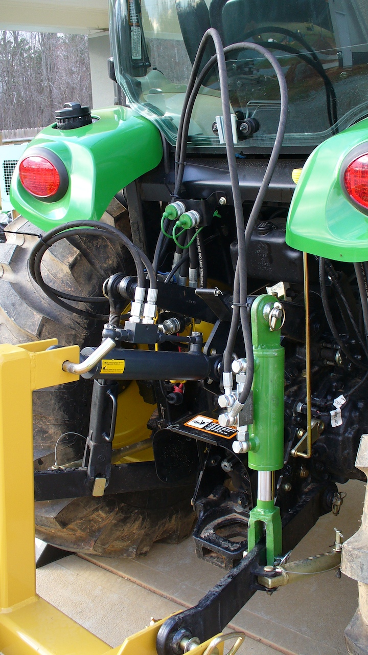

Got my JD 4520 from the factory with the 3rd rear SCV, it has a float position on it.
For $230, added a top link with check valves (CCM), ran it on the 3rd SCV. TnT sounded like a good idea, jenkinsph (aka Steve) was seriously in favor of them so I wanted the TnT on the joystick. Got the sidelink with check valve for $310 (CCM). While the tractor was getting a few repairs done, I paid dealer about $500 to re-route the hydraulic lines to the rear, used the QCs from the front and put them on the back (don't have a loader on the 4520). So for a little over $1K got TnT on the joystick, see enclosed pix.
No good way to route the sidelink to the QCs, have the hoses cleaned up a bit from when I took that pix. If I ever want to add a loader, I'm out the $500 to move the lines (still have the steel lines that came with the tractor). It would cost about $1800 to have the dealer install the diverter, so adding a loader with skid steer quick hitch and grappler and diverter is probably a $10K event, which I would only do if my B21 TLB died.
When I get on to some grading projects, I'll see if the check valves on the toplink are a problem. The joystick has a float position, but with the check valves of course it doesn't do anything for me. Just have to play with it and see, should only be an issue with the land plane. Worst case, buy a non check valve top link. It will take some seat time to figure out if I want to add some sort of restricting orifice to all this. Top link is OK, side link is very touchy. But it's pretty amazing what you can learn to do, so again more seat time needed. Side link sensitivity might also be not enough load on it, so it may behave very differently when there's a box blade or land plane on there. I really got to get out and do some grading...
The usual "if I'd known them what I know now", but that's how it goes. Anyone buying a 4x20 and who plans to use it for landscaping type ground work, should get the diverter, factory TnT, and iMatch. Got lots of good help from Steve and others on the path to the TnT. BTW, also have a iMatch on the 3PH now :thumbsup:

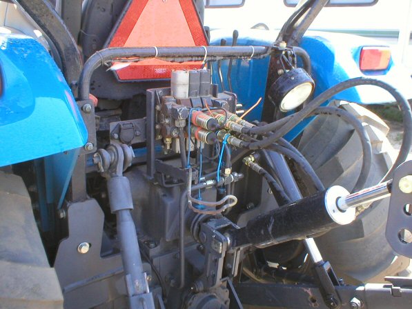

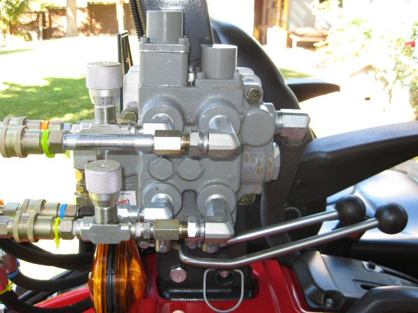

My Mahindra 7520 comes from the factory with two rear remotes. They both have float and are detented in all active positions. I added an OEM factory 3rd rear remote to the std 2 that the tractor comes with. It cost $500 and it too has float and is detented in all active positions. Before I got the tractor from the dealer, I had them install the electric over hydraulic front remote for my grapple with the button control in the loader joystick handle. That cost was $900, so that would have been a few hundred dollars less if I had done that myself. Each of those costs included whatever lines, hoses and QDs that were needed to have a complete circuit ready to use. My use for these remotes is for my grapple, "TnT" and for angling my rear blade and rake.
My Mahindra 3215 has an option of one OEM rear remote. It comes with a float position and is detented only in the float position. I paid $500 for this OEM valve as well. I also added two aftermarket valves for my "TnT", one of those valves has float position. I do not remember the cost, as I was doing several hydraulic projects at the same time. With fittings and what not, I'm sure that it was less than $500 though. The OEM valve will be used for angling my landscape rake and smaller rear blade whenever I am able to get one.
