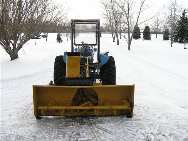

Like many others this year,I wanted to get out of the wind & blowing snow.I got some ideas from others on here that made their own cabs.I didn't want something permanent.During the better weather,I just wanted the regular tractor for mowing,blading etc.

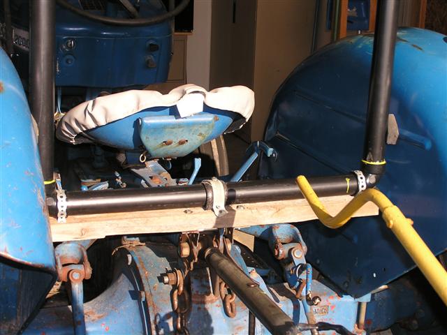

I used 1 1/4 in. ABS pipe for the frame & mounted it on a piece of 2x4 which I connected the to top hole where the top link connects.(not sure what that is called) I used a piece of angle from an old shelving unit & bolted it on.At the front I used some threaded rod with a steel end from an old bungee cord.I hooked the end under the tractor sheetmetal & ran the top of the threaded rod thru the front windshield part of the ABS frame.To remove the cab,I undo the nut & bolt at the back & loosen the 2 wing nuts at the front.
I used a heavy guage clear vinyl from a hardware store & attached it with duck tape & plastic wire ties.It gives good visibility in all directions.I have named it my "Pope-Mobile".I also left about a foot at the back not taped down to act as a flap so I can reach out to rotate the chute.
I had originally planned to use a golf cart cover as others had done,but I thought this would give better visibility.
So far it makes a big difference.

Looks good :thumbsup: anything that keeps the snow out of your face is a good thing,, It always seems that with a blower it always blows back at you ,:D

Hi! The left side of the plastic is not taped all the way down.It is used as a large flap to get in & out.I fastened a piece of velcro to the edge of the plastic & the other velcro piece on the post of the windshield pipe.When I get in I snap the velcro together to keep the flap shut. The back part of the flap is on the inside part of the fender so it doesn't blow open.
I've used it many times & seems to be like a greenhouse in there.I don't wear a touque & hooded sweater anymore just my ball cap.(Besides the rest of my clothes)
Total investment was about $70.No more looking like Frosty the Snowman when i'm done clearing snow.I do my 1/4 mile drive & 5 more of my neighbors.Should have done this years ago!!!

That's a great looking job. It is way better for outward visibility than a soft side golf-cart type cover. I used one of those a few seasons but a near-miss with a pedestrian got me looking for better see-thru. Does the solvent welded ABS hold up in cold temperatures? I'll bet when the wind swirls snow around your tractor now, you just smile in there. Good job :thumbsup:

Hi thclimber! There was no preference for me on the type of pipe.I have used ABS in the past for various projects & had no problems. I used 1 1/2 in. dia. & it is makes a solid,rigid cage for the rest of the enclosure. I put a piece of 3/8 plywood (left over from a roofing project) on top & secured it with nuts & bolts.
The vinyl I used was also 54 in. wide,but could be purchased by the yard.I bought 6 yds. & had very little left over after a bit of trimming.I don't recall the exact thickness,but there were 3 available & I took the thickest.
I just poked a tiny hole in the vinyl & then in the velcro & put a small nut & bolt with washers thru & tightened em up.

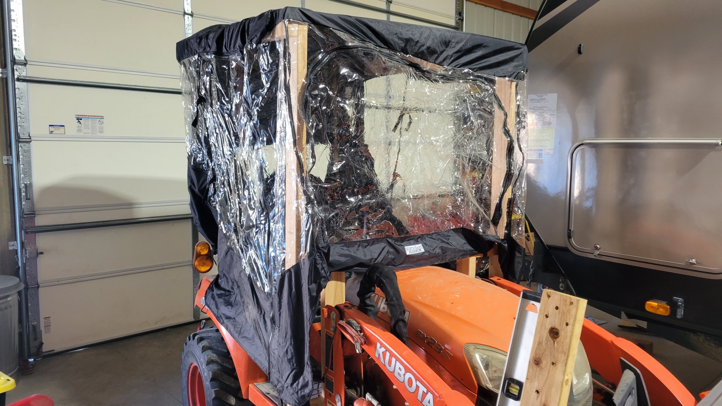

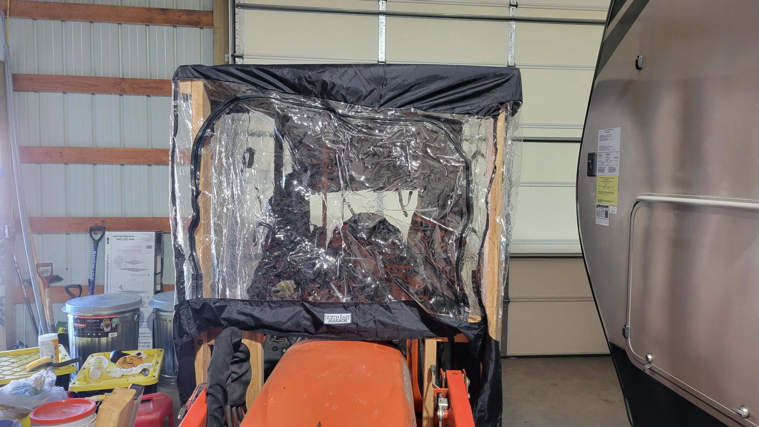

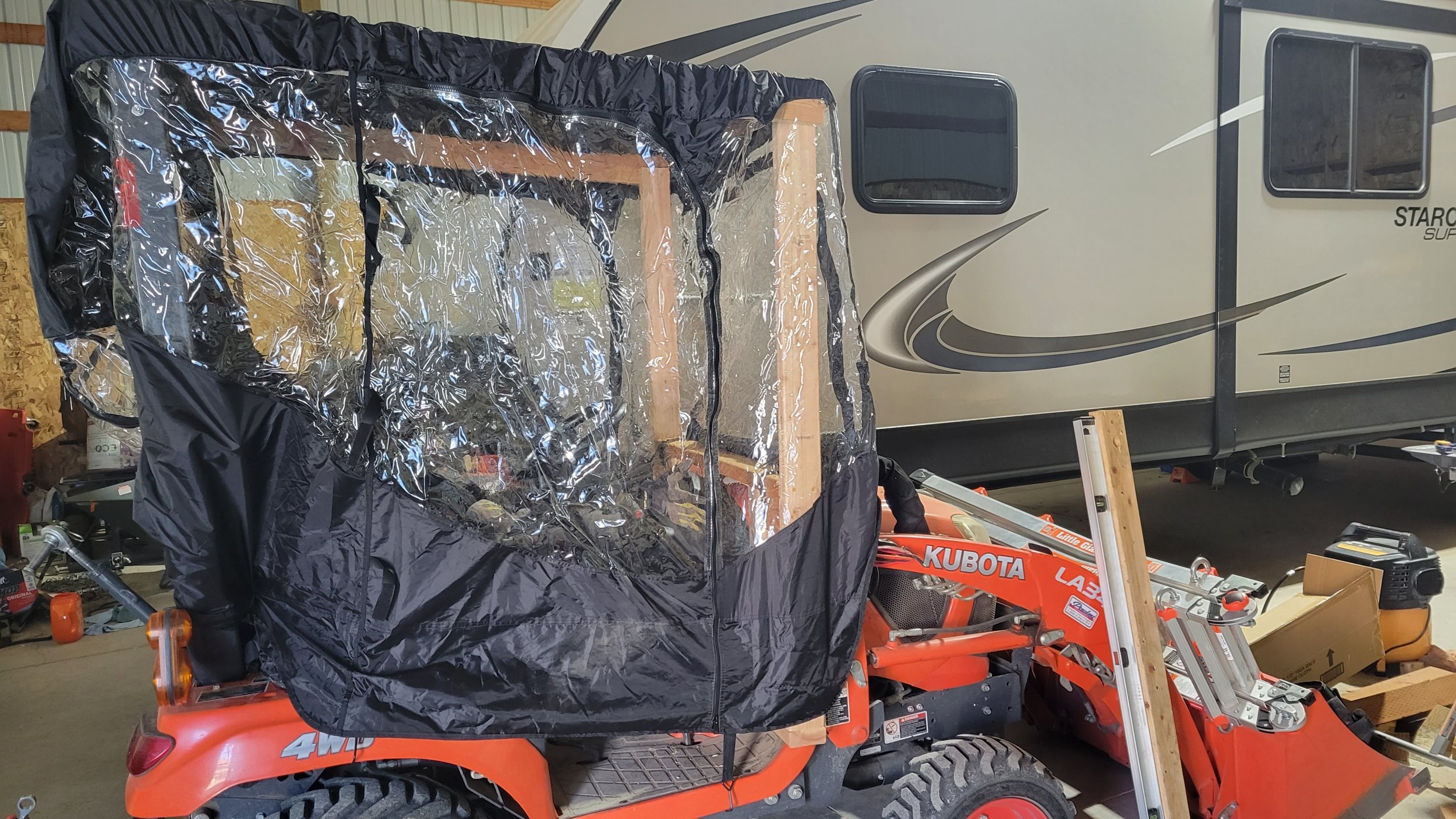

Looks good. I ended up buying a golf cart enclosure and building a simple wooden frame. Once perfected, I'll build one out of steel.
/ Removable Snow Cab #14
This is the test fit.

The wood frame will allow you to make easier modifications than steel that's for sure.
I was surprised how sturdy the PVC pipe frame that I made was. I used it for a few years and then got my cabbed Massey 1736 with a front blower, what a luxury.
