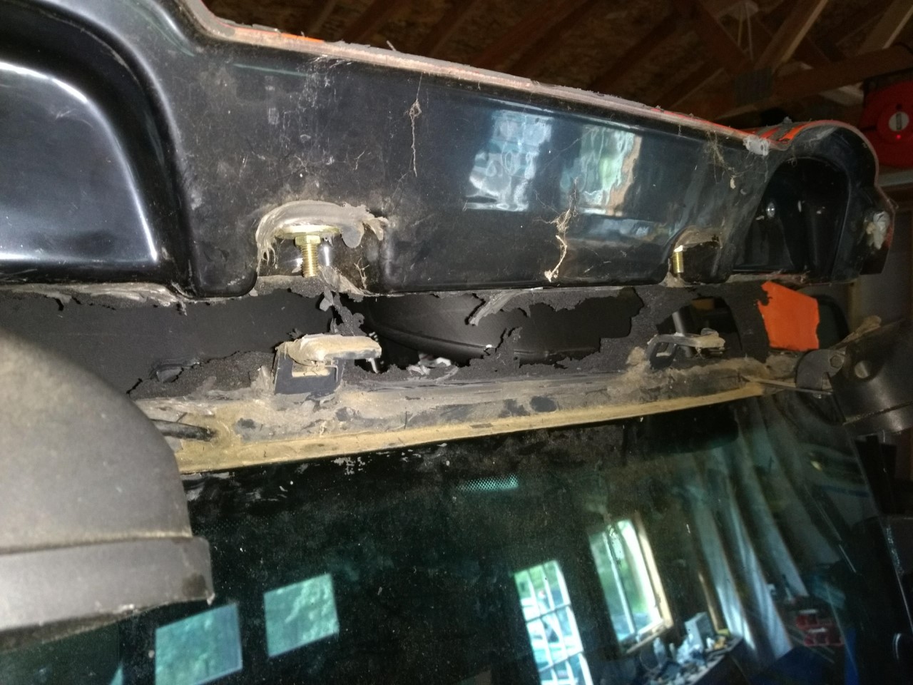

RTV and foam. A HUGE mess:

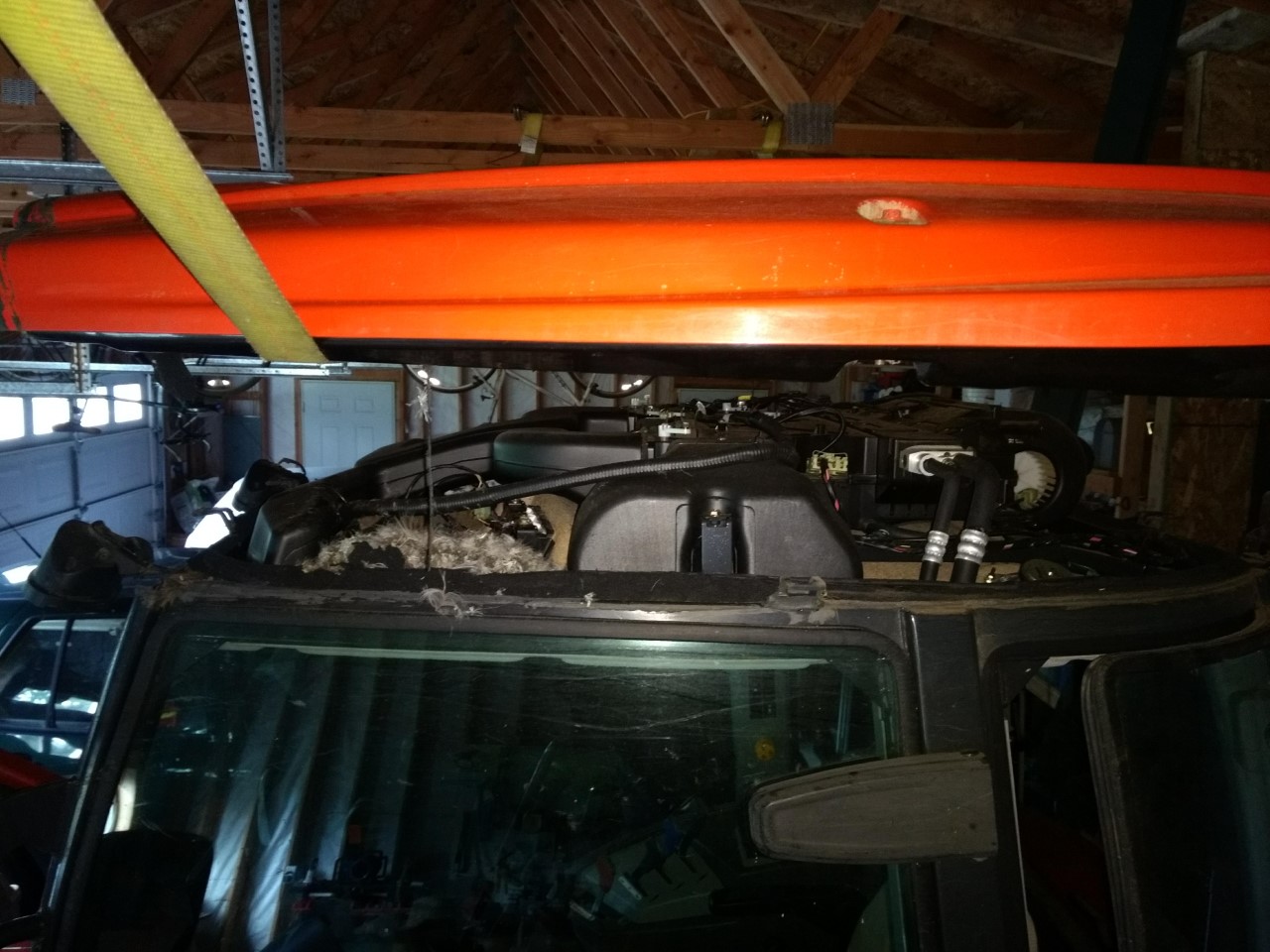

After about 2 1/2 hours of work. Roof lifted. Have yet to clean things up (mouse nest should be obvious):
What a mess. Ask your dealer what on earth they thought they were doing?
   / Removal of NX cab top
#12
My e-mail exchange with the dealer:
Me: Did you guys RTV the top (on)?
Dealer: They use a sealer from the factory, but we added RTV - yes.
Me: No one that I've run across has had to seal their cab tops like this.
I'll scrape off everything and then go with the type of seal that Country noted: I've already ordered some; hoping that it's width of about 1/2" will be sufficient.
Oh, and to answer your question/comment on the use of straps to suspend the cab top: yes, I have the straps set up such that they should stay OK; just need to be easy with not knocking the top off the straps; probably use the loader to take down for cleaning and to raise back up (need to drop off the grapple and put the forks on).
Will be taking a close look on how to seal up things so that I don't have to chase mice out again. I'd be appreciative for any input on specific points to seal up and materials to use for such. I know that someone noted there's a hole in the firewall: I'll be looking for that; hoping that it wouldn't require removing the hood (my bandwidth at this point is severely stretched).

I was thinking the same thing on the gasket as Eric, it’s a full rubber type than a foam. As for sealing up the cab , the pillars are open from top to bottom, Along with a few other places. Curios as to what you come up with to seal them with, as a few have wires and such running in them.

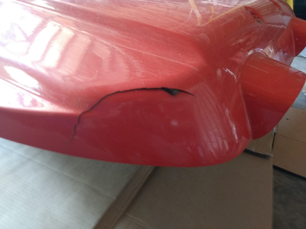

I am currently contemplating how to repair the crack in the lid. I've extracted the piece of wood. I'd like to know what kind of plastic this is as I have a plastic welder that I'm thinking would work OK to, at at least, repair from the inside (maybe apply some sealant to help fill from the outside?).
When I get around to popping my top off to fix it and diagnose and sort out the shorting wiring that is draining my battery, I plan to shove a pile of stainless steel wool down the pillars from the top. I don't think piles of mothballs in the top has played out well.

I shoved steel wool in the tops of the rear pillars. The fronts are capped off by the cab top (they're not open to the inside of the roof).
