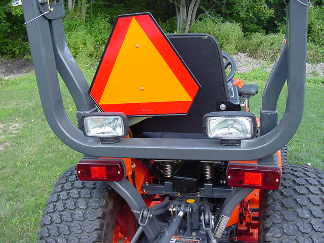

   / Remove My Hazard Lights????? #9
I mounted 2 Blazer lights on the rops of my 7500. Check it out.

BX2200 also has wiring for lights under the driver's seat with connectors already attached ... for those that are interested.
I would use the pre-wired circuit and add a switch; many have put the lights on the ROPS and mounted the inline switch on the ROPS as well so you don't deface the instrument panel.
