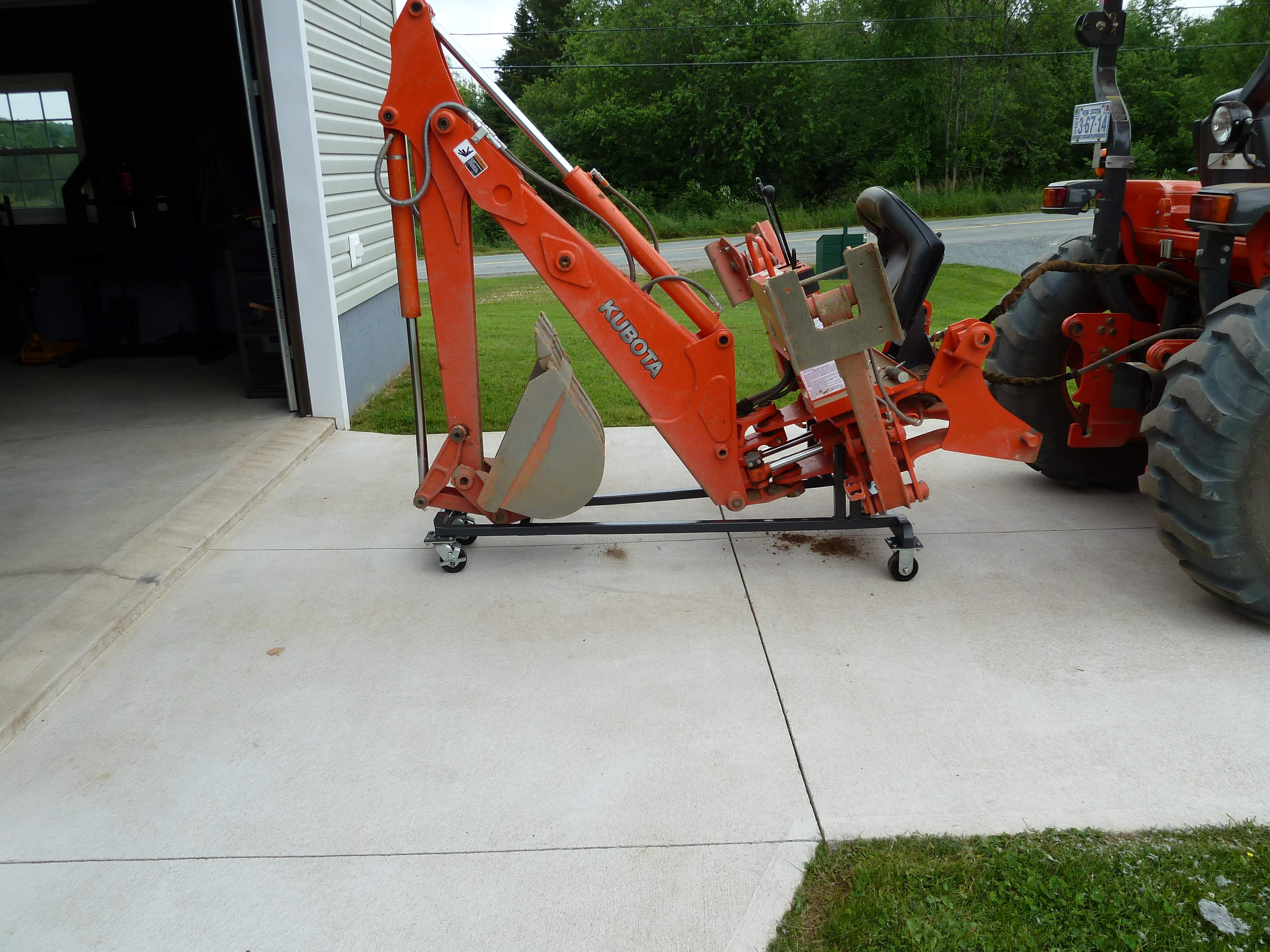

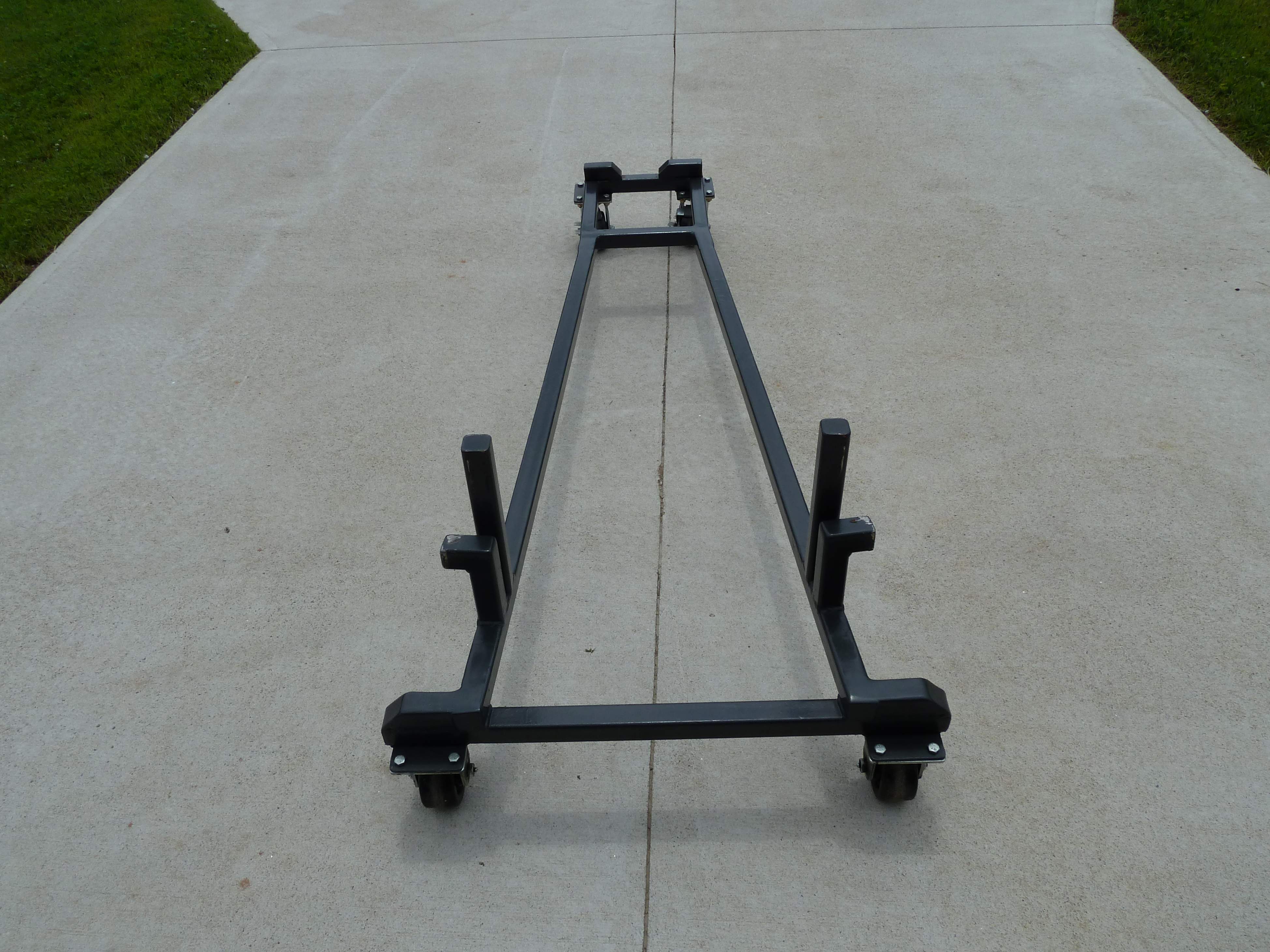

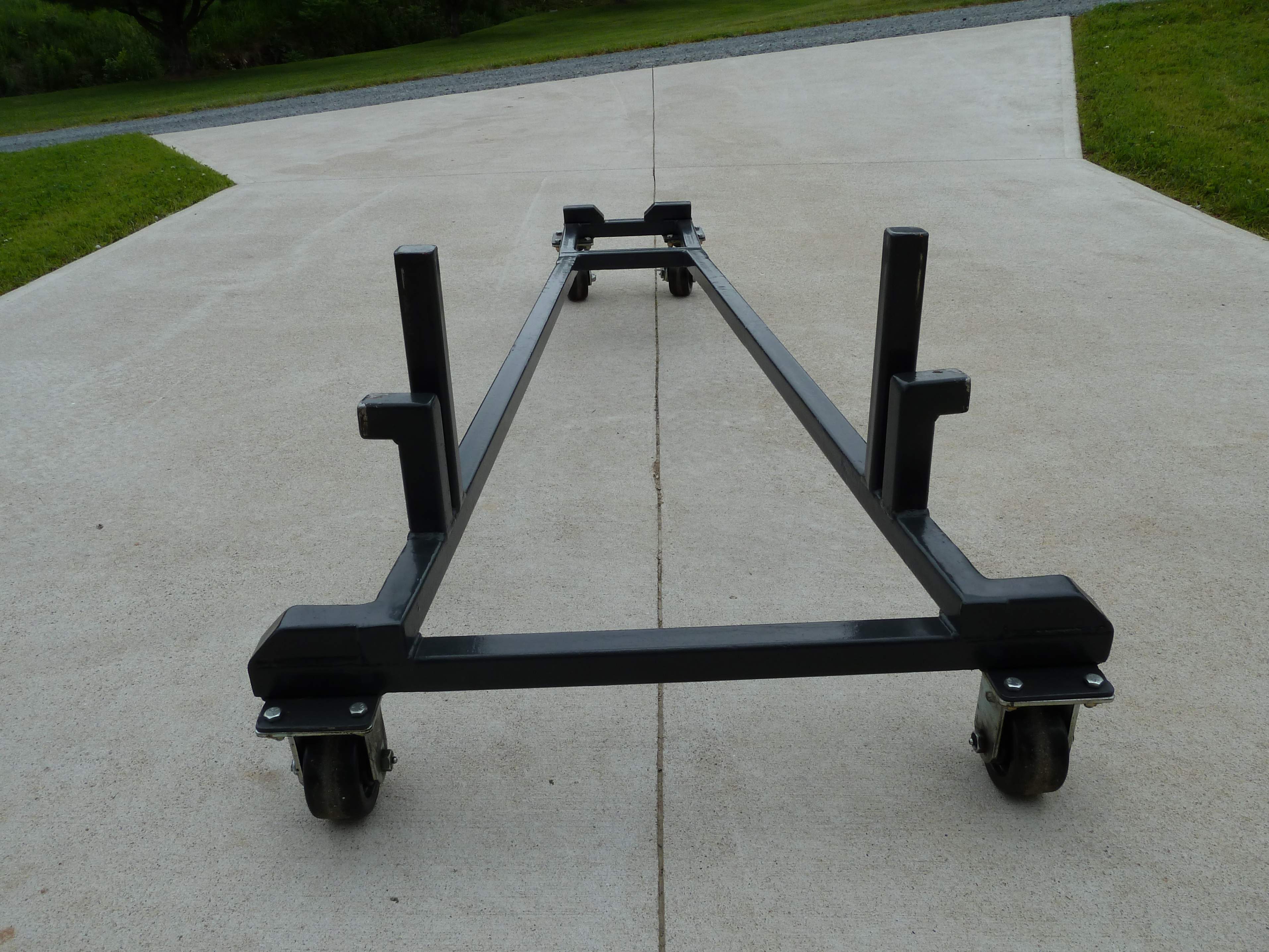

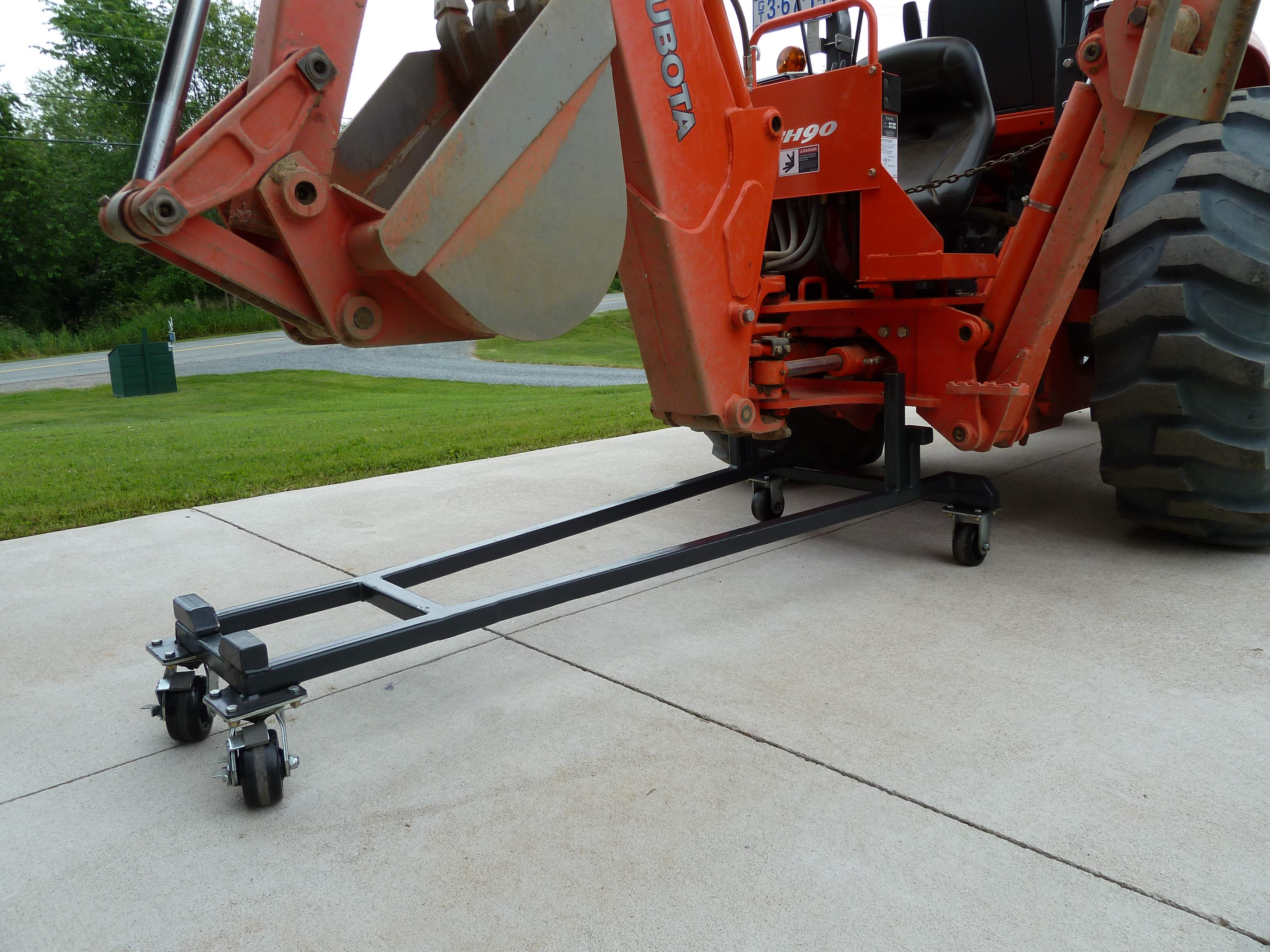

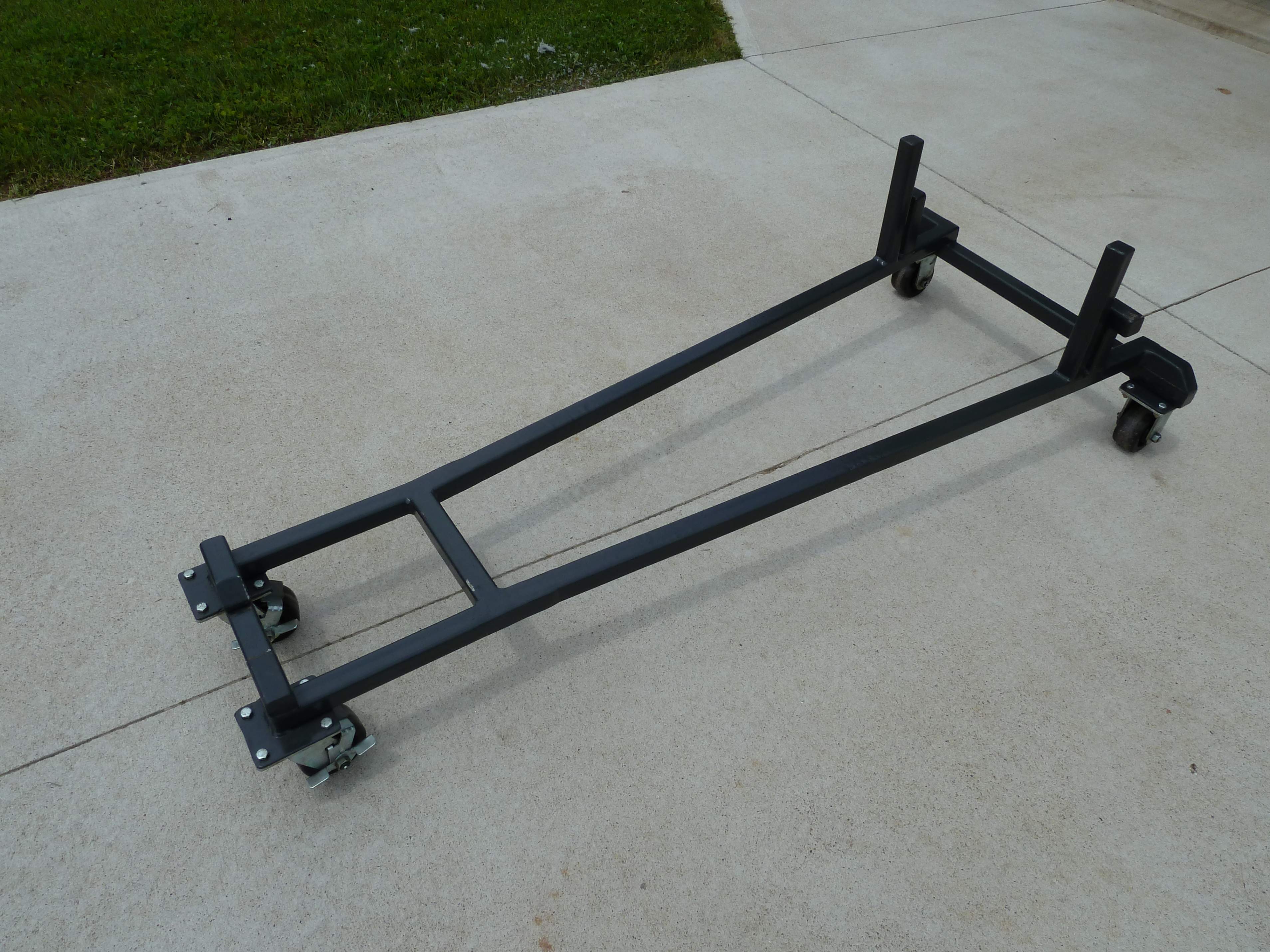

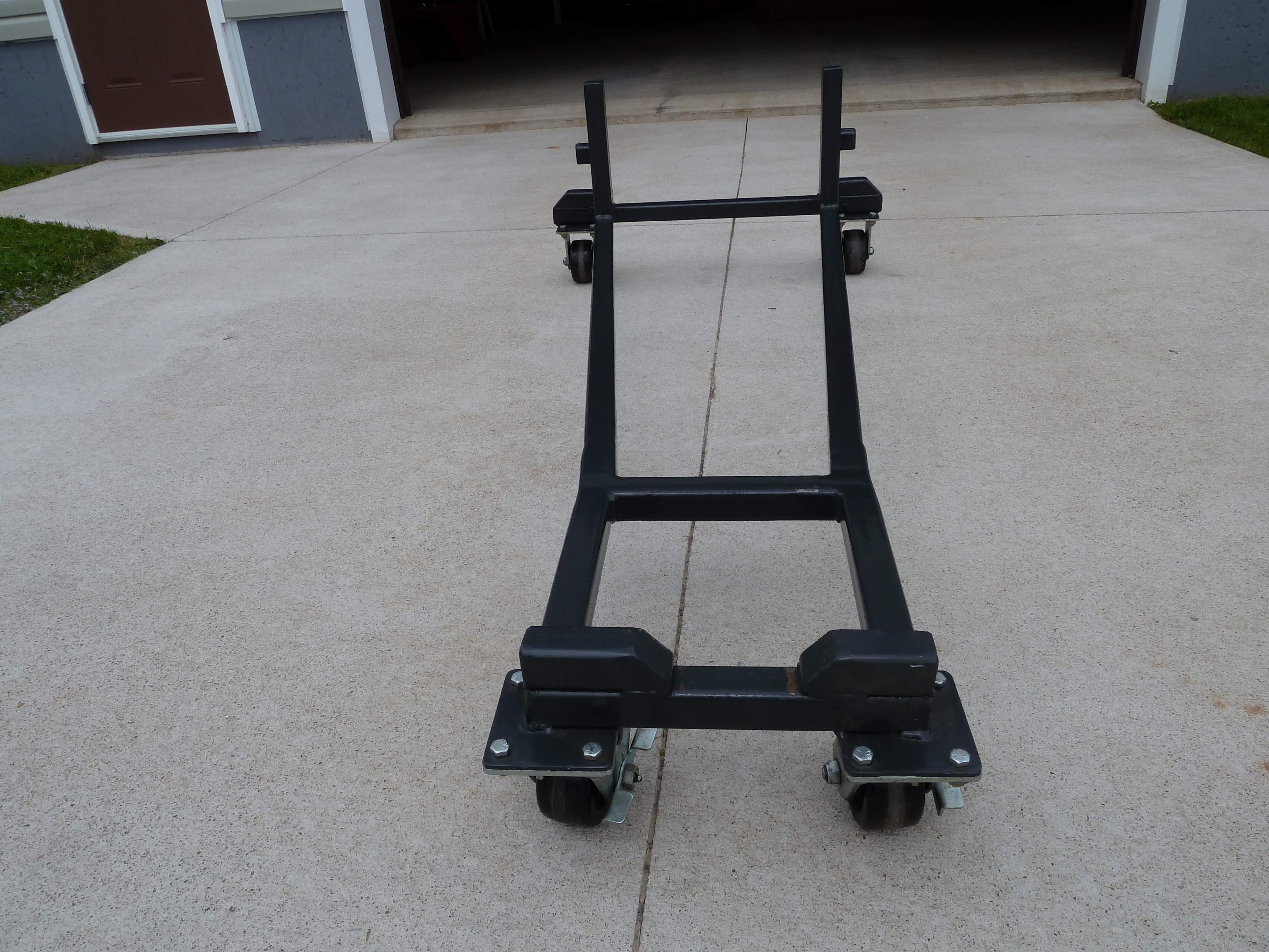

Could you please post some pictures of your BH dolly??
I finally got some pictures of the dolly,been kind of busy.It is made of one and a half inch square tubing with three sixteenths walls.The casters are four inch because I already had them but they could have been six inch.There are different ways to make a dolly but this is my version which seems to work fine.
