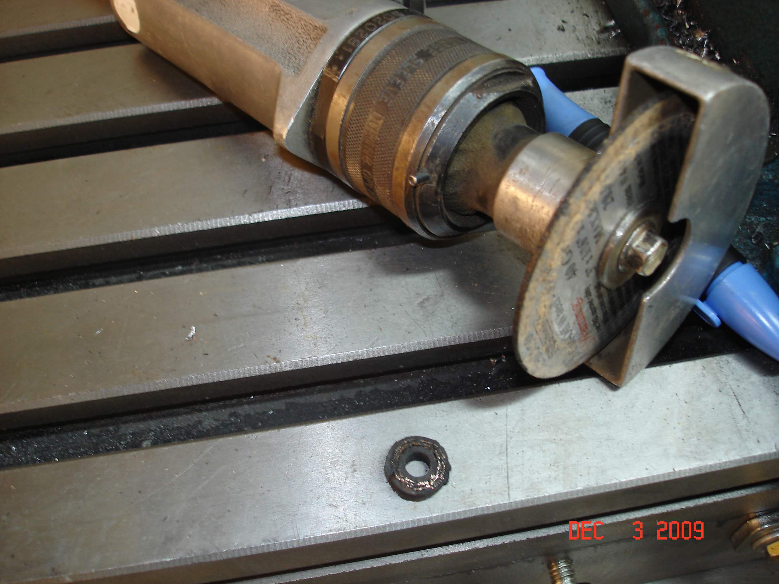

Die grinder with a cutoff wheel, AKA wizzer wheel.
