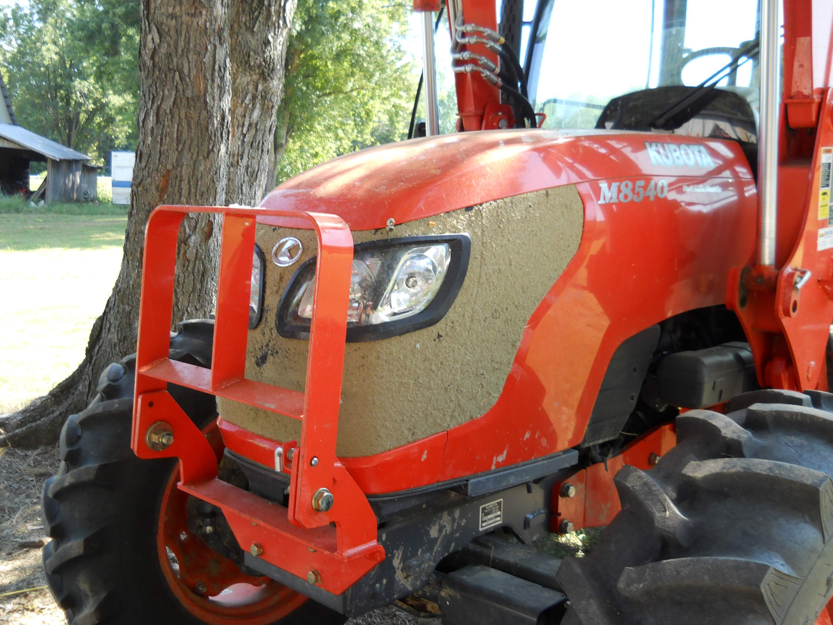

I use a combination of brush and leaf blower for in field clean outs, works fine. When I am near a shop, I use compressed air with a want with curved end or side ports.
Sometimes I can't mow for a full hour before a clean out.

Mine gets a mask like that too... looks like my tractor grew a beard. Yours looks like a superhero mask... 'I am tractor man!'
I do my best to just keep the grill clear by hand one an hour or so and air hose when I get back to the barn. The gas leaf blower might work if you can get a flexible end of the hose to get behind the rad to blow chaff back out the way it came in. Anything is better than nothing... even if its just a few minutes at idle to cool then hand cleaning with the brush idea once you shut it down for a few minutes. Gives your ears a break from the ear plugs too....
