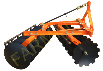

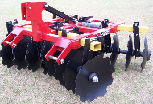

with disks that are angled in both directions in an X and "meet" in the center (as opposed to the ones where the front and back are a single straight run) the front one is angled so that the pans roll dirt out, and the back ones roll it back to center, so him running it weighted to the back makes perfect sense to me...? I am not sure how you'd get the "X" frame ones to pull in at the front?
This style
rather than this
...that last one I could see working especially if you had the more aggressive notched disks.
/ removing 'ditches'? #30
With disks that are angled in both directions in an X and "meet" in the center the front one is angled so that the pans roll dirt out, and the back ones roll it back to center, so running it weighted to the back makes perfect sense to me...?
An excellent point.
