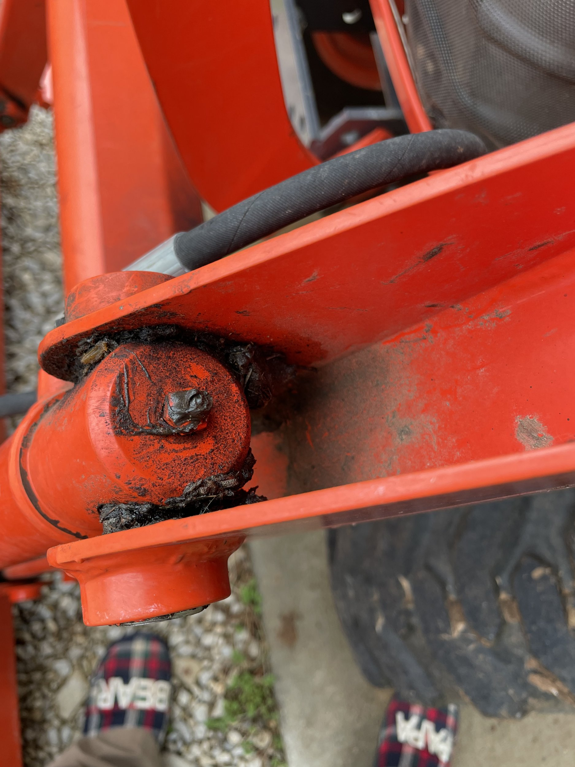

Hello to all,
Saw a post if you need to grease a tractor/FEL every 10 hrs w low usage. I didn't want to hijack that thread so here we go.
I am for sure guilty of not greasing every 10 hrs, esp w a FEL. I did just reload my grease gun yesterday and hit every zerk. Two questions:
  • What is the best way of removing the caked-on grease, sometimes in very tight and hard to get places?
  • If a zerk gives you resistance, but finally gives way to extra pressure from g-gun, is the zerk bad or area really clogged?
Just guessing, would spraying some kind of solvent work, then hit w power washer [w lower fan/psi setting]? Don't want tp compromise the paint or infuse water where it should not be....
Thank you very much,
tstex
I leave it alone. Grease is never bad to have on and around moving parts that are put under a load. It’s keeping water and dirt away from the fitting when I’m out in the field. I wipe it off with a shop rag before re-greasing but that’s it. Have you ever seen a rusty zerk? Not on anything I have. Never had one clog either. Did have one fall out once that wasn’t tightened at the factory. I think when they’re clogged, most times it’s because old grease has solidified. That’s hard to clean out. It’s also a good idea to lube all the fittings on attachments before storing in the off season, especially if they sit outside.
