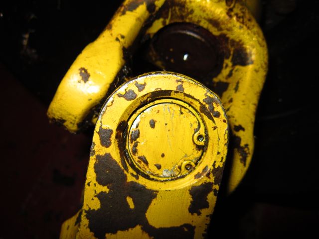

I can't feel a pin or button. I will spray the whole thing with PB Blaster to see if I can get something to rotate or slide. Thanks a bunch for the info. I was almost afraid I was going to have to go into the gear box itself with the way my luck goes :laughing:
Well. is it splined or smooth?

A couple of good pictures would be worth ..uh... well a lot!

Here are pics of the cleaned up mower joint. Have a feeling it is those C shaped springs I don't have the tool to remove. There are two of them, one on each side. PTO joint.jpgPTO clip.jpg

No.. it is not the "C" shaped clips on the ends of the yokes. Look at the end of the shaft that comes out of the mower. The rusty brown shaft.. Look at the very end for a wire type clip in a groove. pry it out, I can't quite see it. I need a better photo to be sure, but it is not the C clips, that is how you take apart the yoke, and you need a vise and sockets or a press and special pliers like you said, But this is NOT what you want to do. Also the yoke may be rusted onto the shaft. I believe your shaft is a smooth shaft, and I cant tell if there is a roll pin or what going thru the shaft. Normally it is a shear bolt, but I didn't see one.. Is there a hole in the black outer shroud to line up to put a drift punch (roll pin punch) thru the hole.? The idea is to get the yoke off of the mowers shaft so you can get a complete new shaft right?

I removed the shear bolt. The hole in the black shroud lined up with the bolt I removed.
The purpose is to get this off so I can replace it with a new PTO shaft assembly. Guess I need to give it a few whacks with the trusty ol' hammer to try and break things loose.

Before you whack, look carefully for that wire clip on the very end of the rusty brown shaft. look for a "break" in the wire and flip it out with a screwdriver or something. I have never seen one without one.. or at least look for the groove. maybe the clip has let go or maybe there isnt one. Your there and I am not.

Went out and removed the bolts holding the black cowling on so I could get to the back of the yoke. See no clip in the grove on the front of the rusty old shaft so I hosed everything down again with PB Blaster. Hopefully by morning it will be more cooperative. One thing is for sure, the seal at the grease fitting was shot. In fact, I expect all of them are. At least the tractor is in really good shape.
Once I get the dang thing off, I will be better able to know what to order. I sure won't be getting it from Tractor Supply. Yowza! :greedy:
