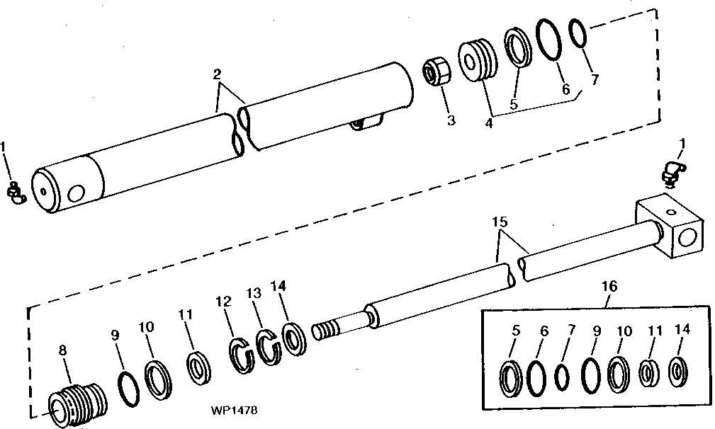

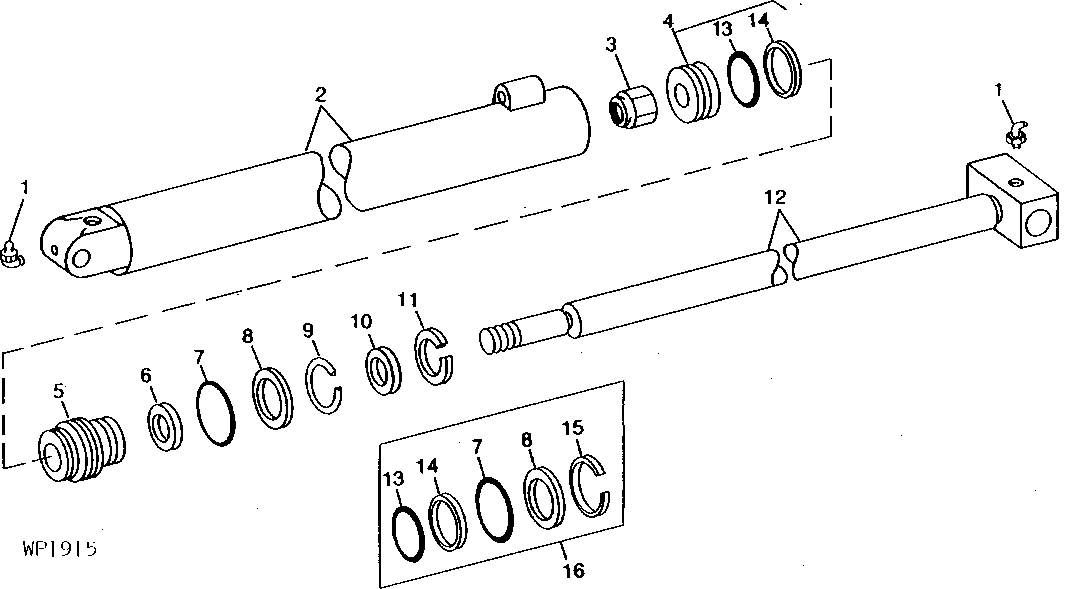

I have a JD 100 loader and I'm trying to replace the seals but I'm having trouble removing the rod guide from the cylinder. I have removed the snap ring, but can't get the guide to come out. It will spin freely on the rod, but apparently it's not threaded because it will not unscrew. I have also tried to use the rod as a slide hammer and it still won't come out. Is there some kind of secret to remove the guide?

My cylinder doesn't look exactly like the one in the link, but I will see if the seal kit has something similar so as to remove the guide. It didn't appear to just looking at the package. I will look again. The diagram for that cylinder in the loader manual shows an outer split ring that I have removed as well as one thats up inside the tube around the guide. I tried to shine a light up into the crack between the guide and the tube, but I could not see the ring. Also, don't see a way to get a tool into the narrow opening even if i could see it. I really see nothing else on the diagram that could prevent the guide from coming out other than that ring.

Your cylinders may use a "retaining wire" and not the internal expanding ring that we assumed they did...a picture would confirm for us.
The plastic thingy (technical term) goes inside the bore. After removing the external ring, the guide is pushed down into the bore, then you would see the groove that catches the internal expanding ring. Filling this groove with the plastic thingy allows the ring to slide past the groove.

The manual for the loader shows a diagram with a second ring attached to the guide, but I just can't see it up inside the tube. I will check the package when I get hope and see if there is a "thingy" in the kit.
