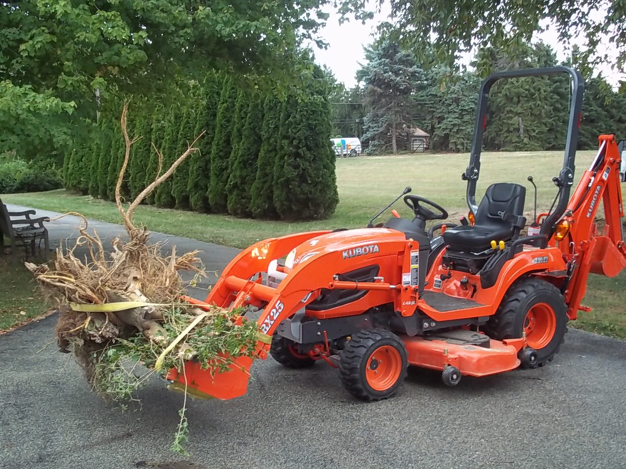

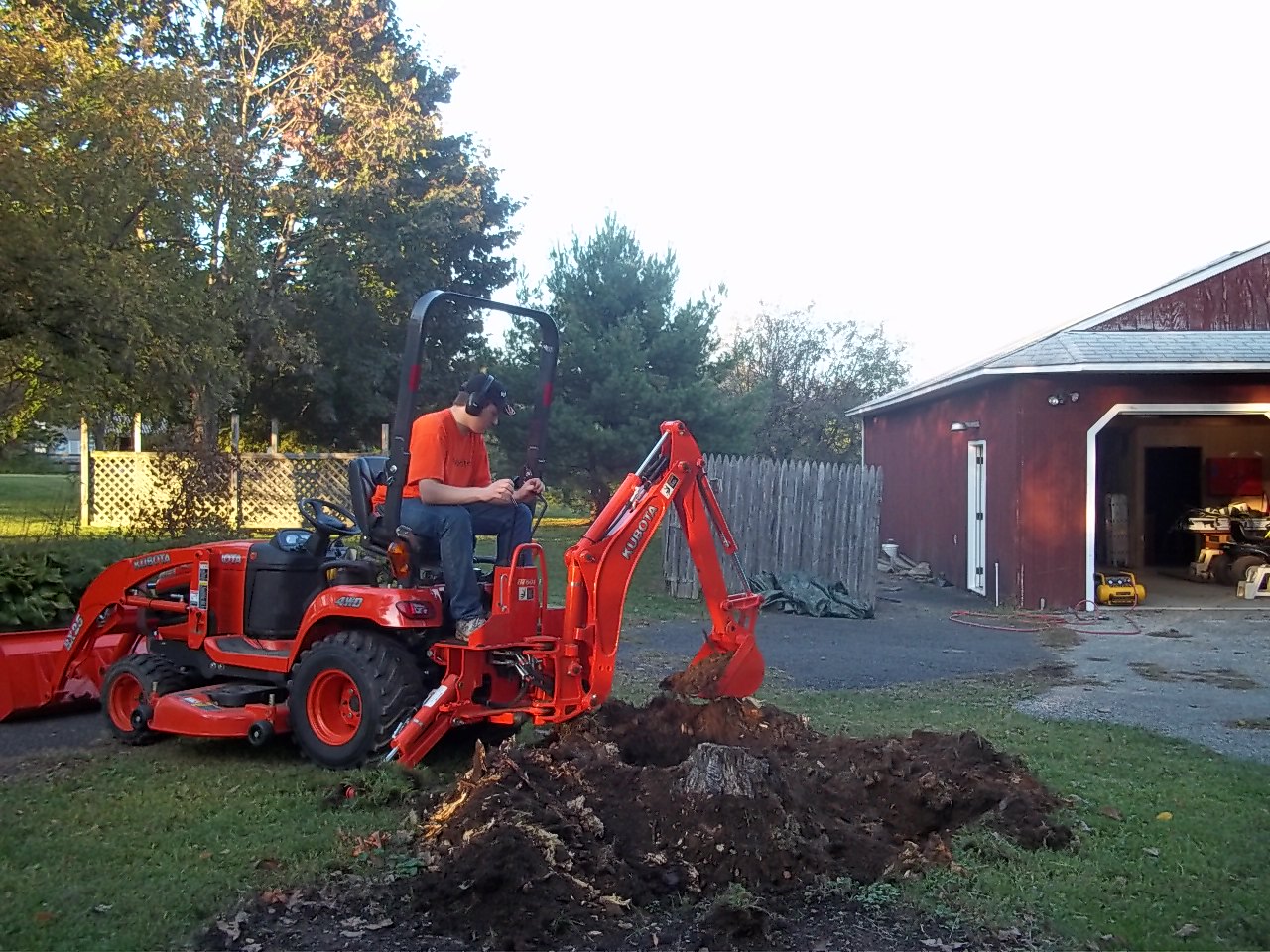

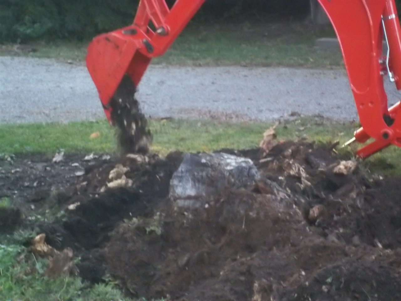

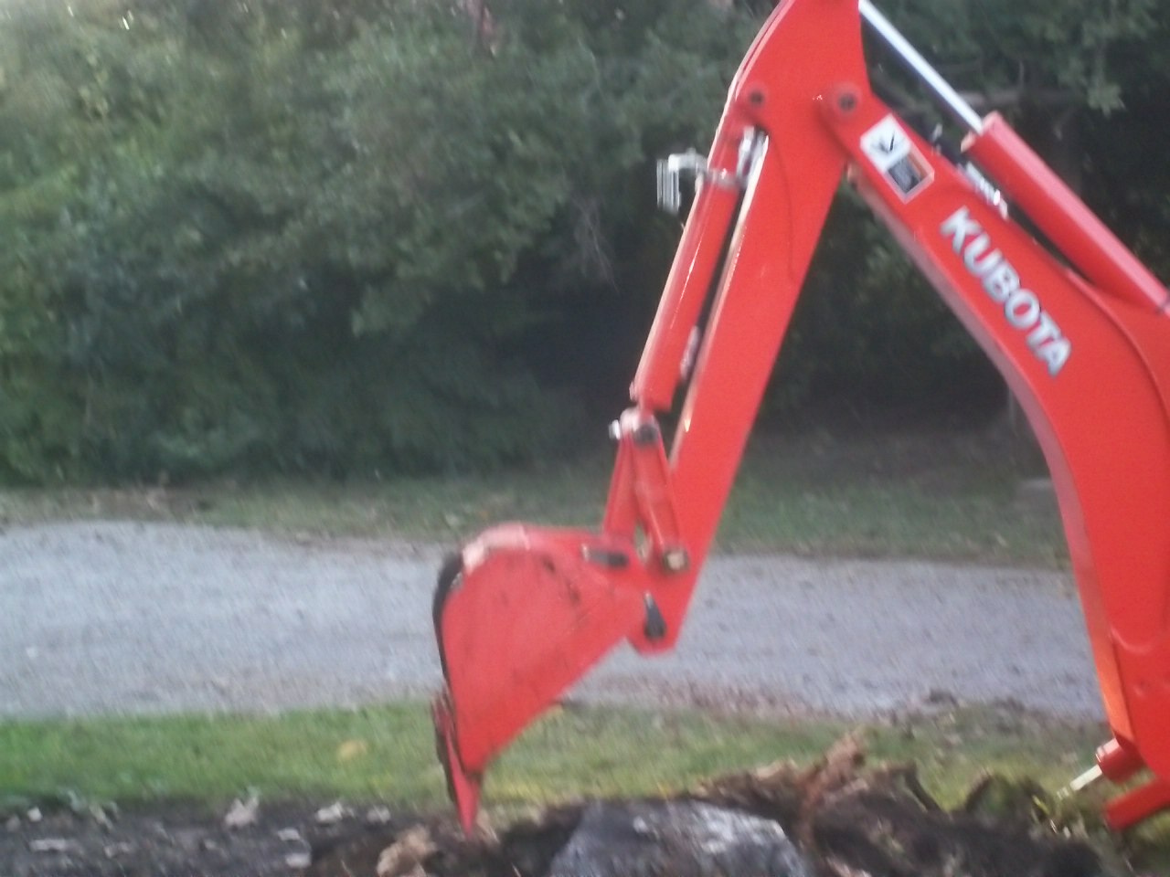

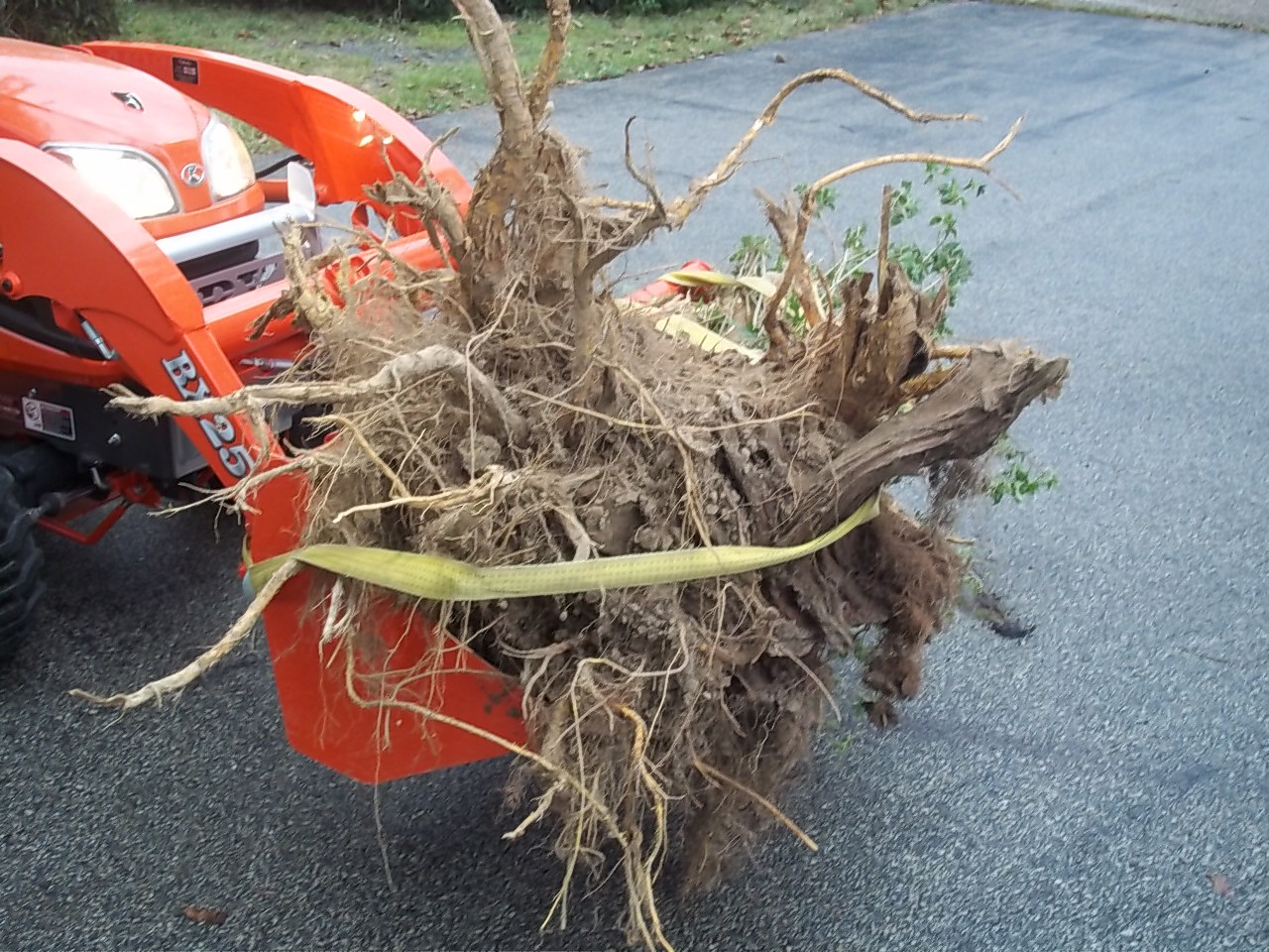

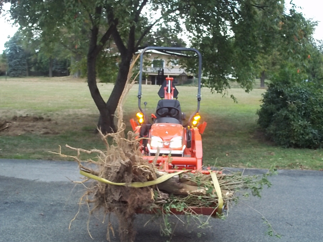

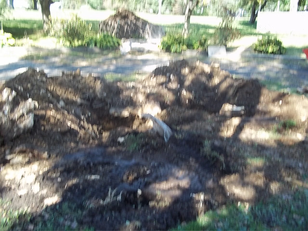

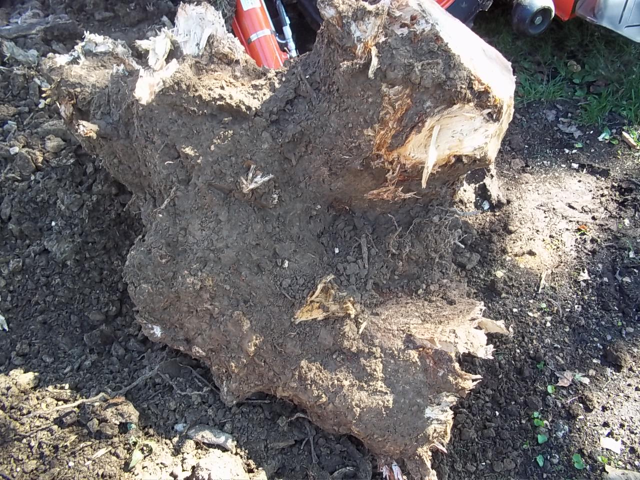

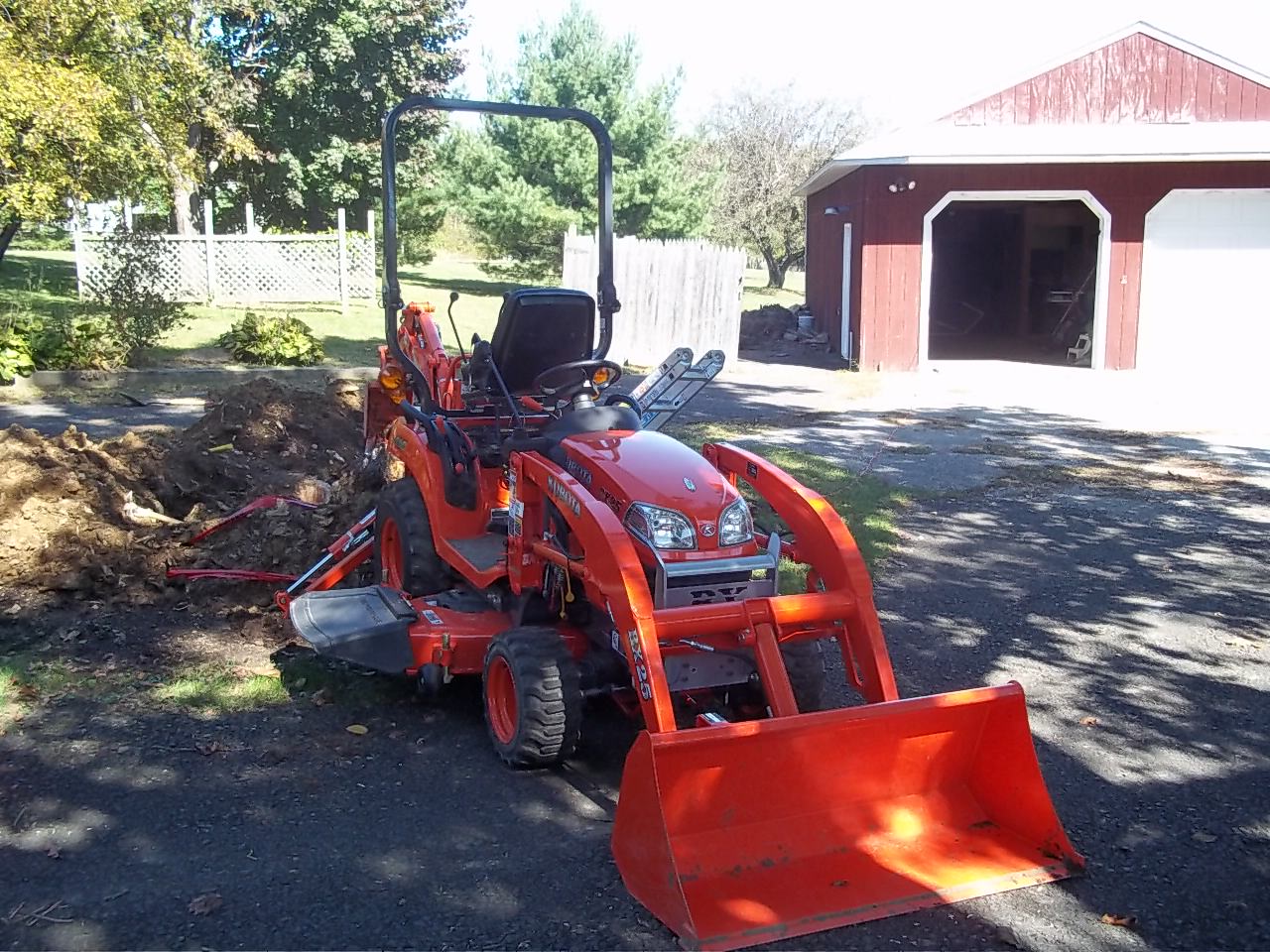

Here is a stump I removed yesterday. It only took about an hour or two using the backhoe and a tow strap.

Looks like you're putting that machine to good use!
/ Removing Stumps #3
First One... Good JOB! :thumbsup:
/ Removing Stumps #4
By the looks you got good feel of your BX,got feeling your project list shall grow. :)

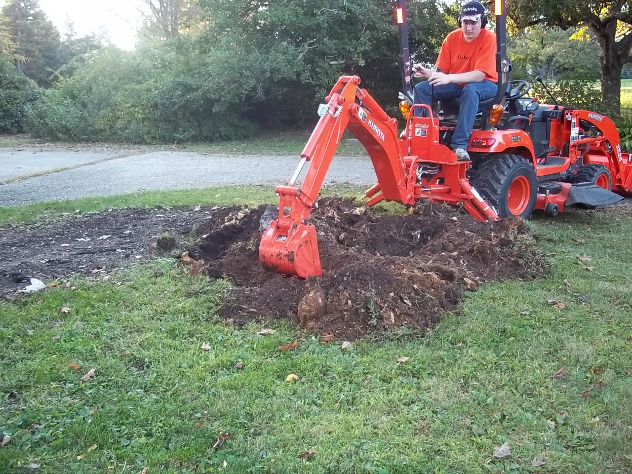

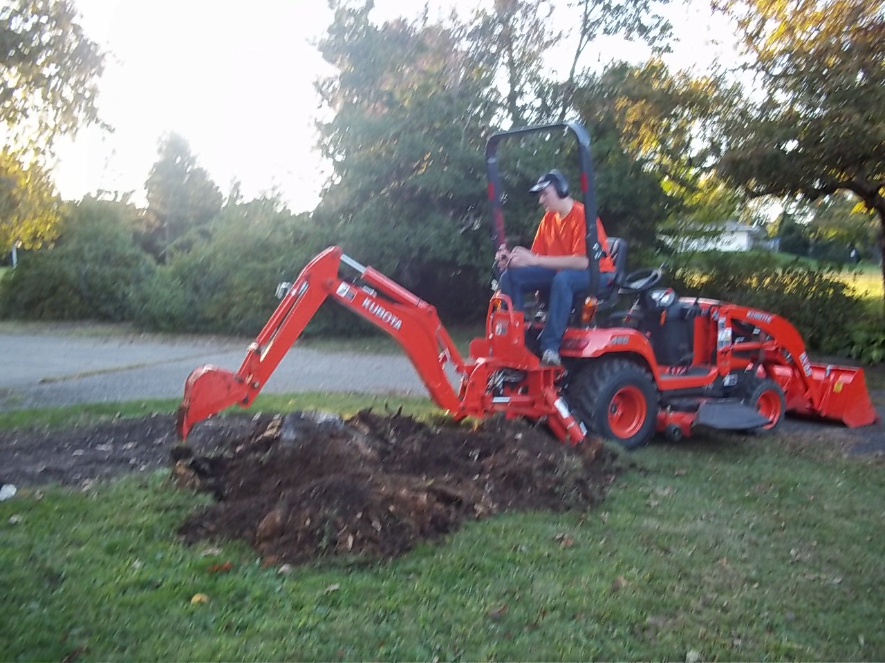

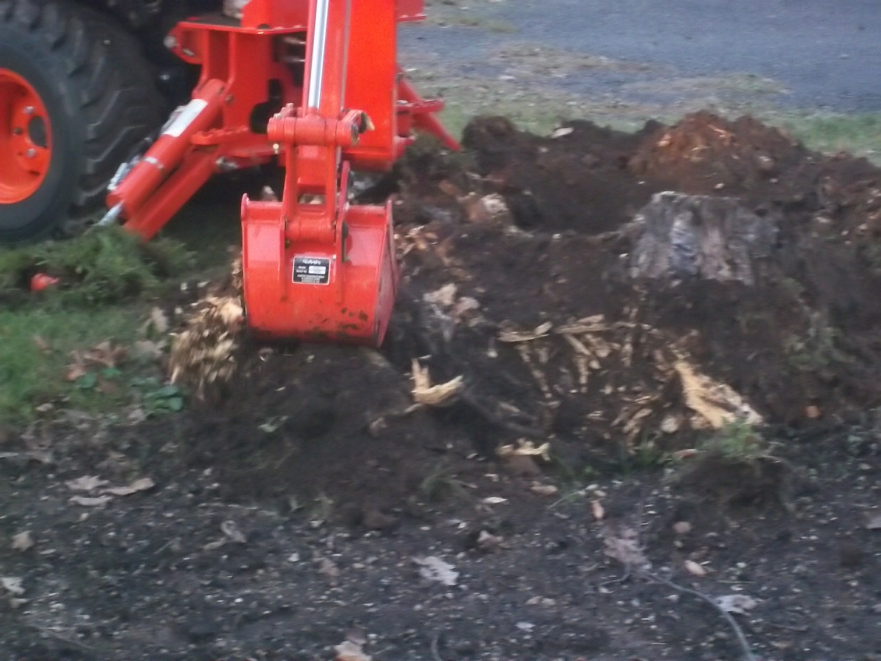

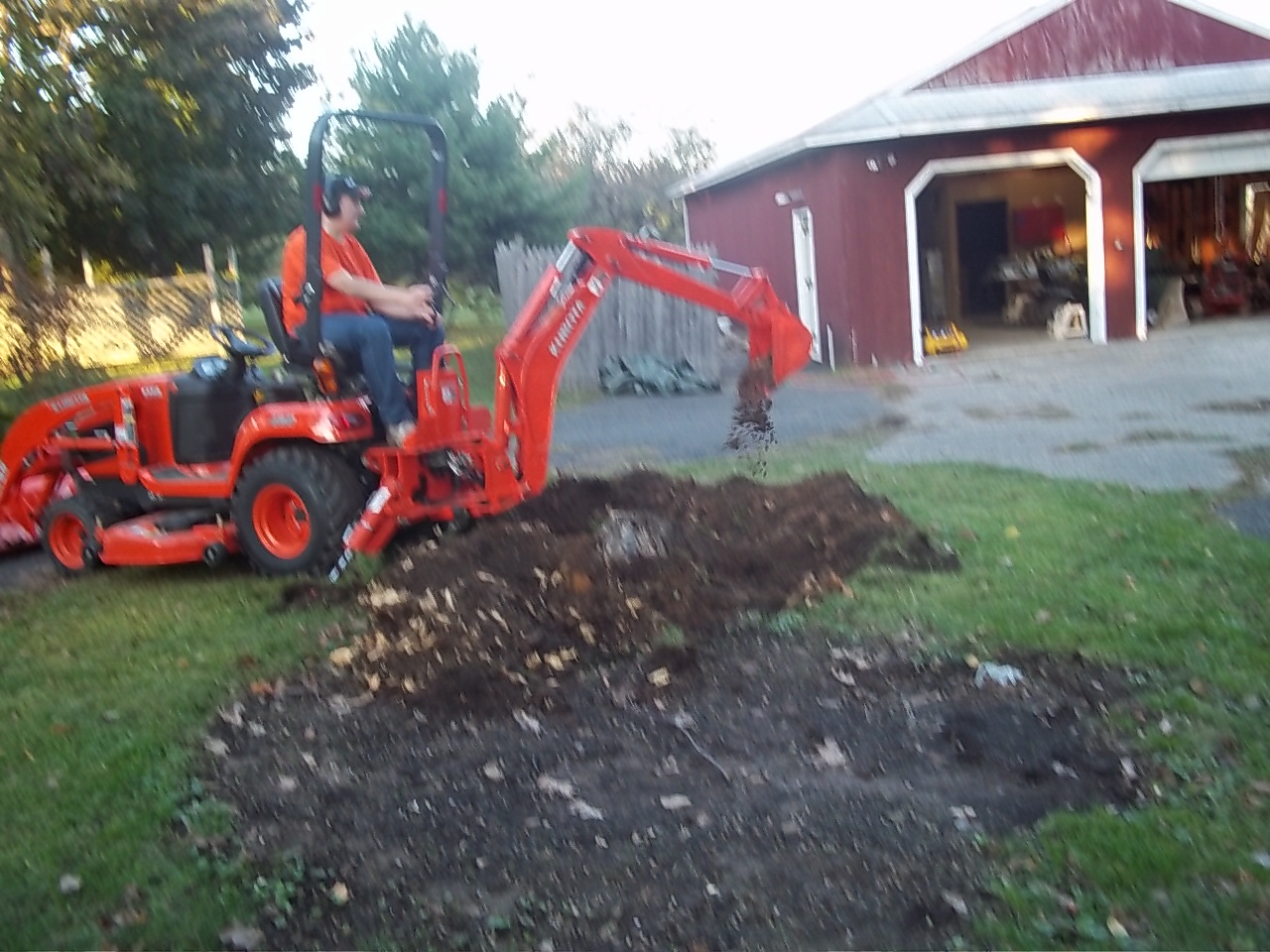

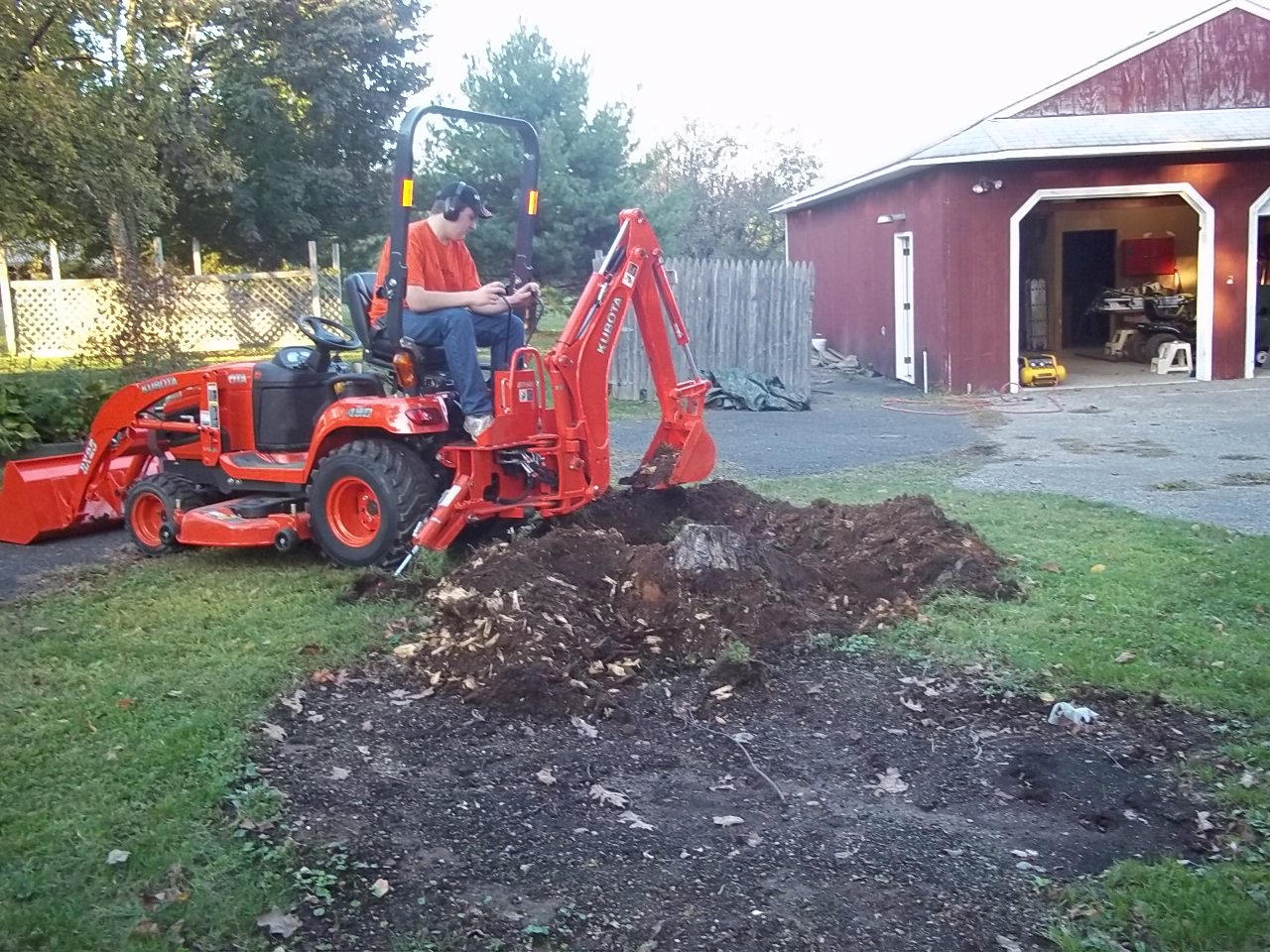

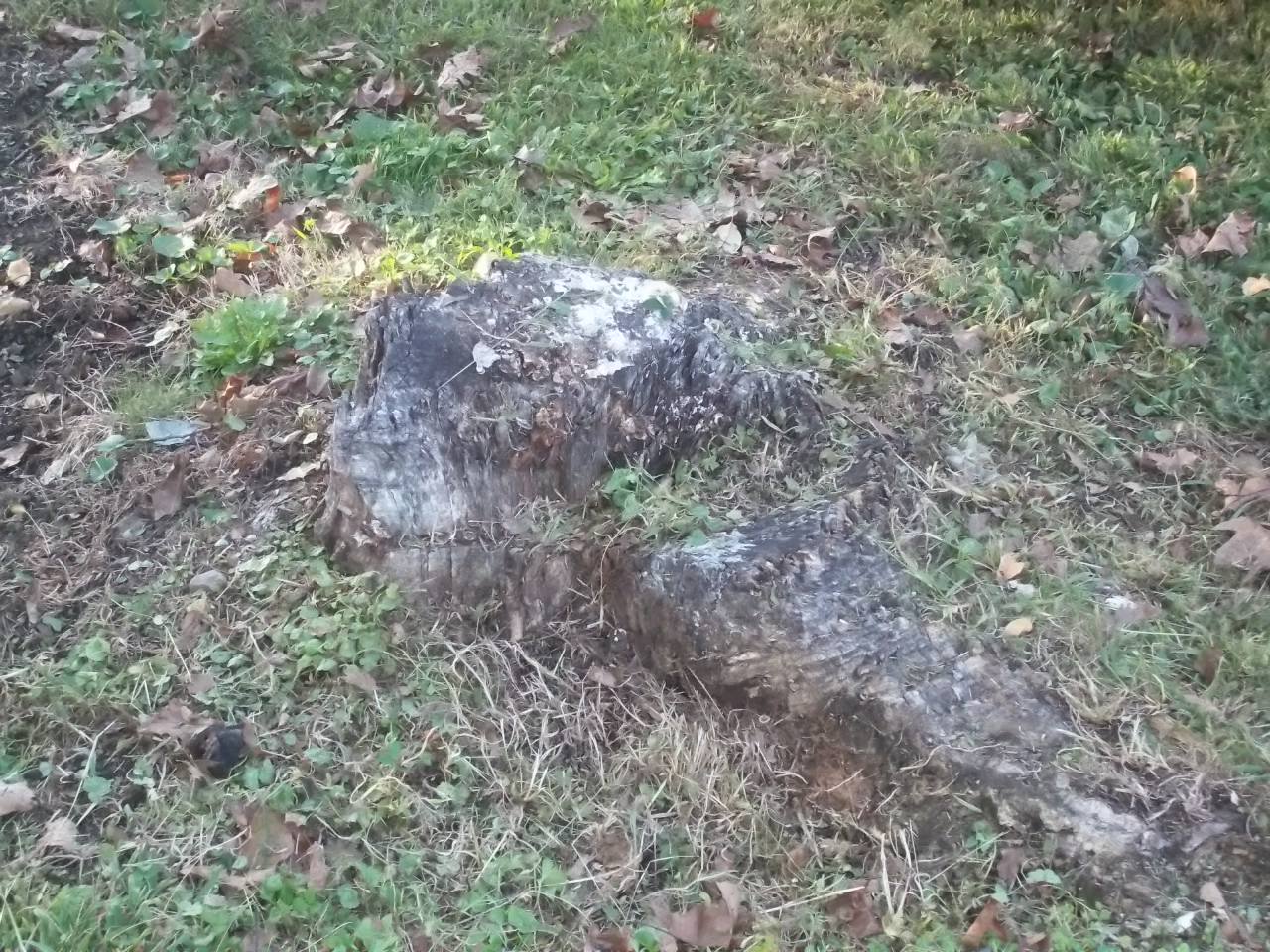

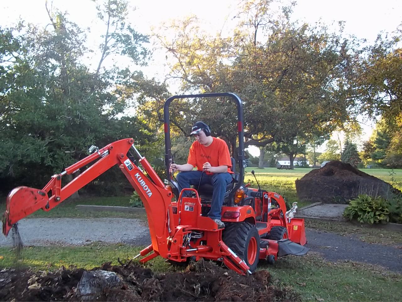

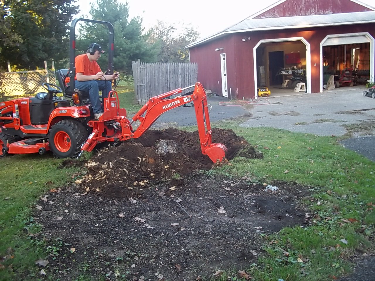

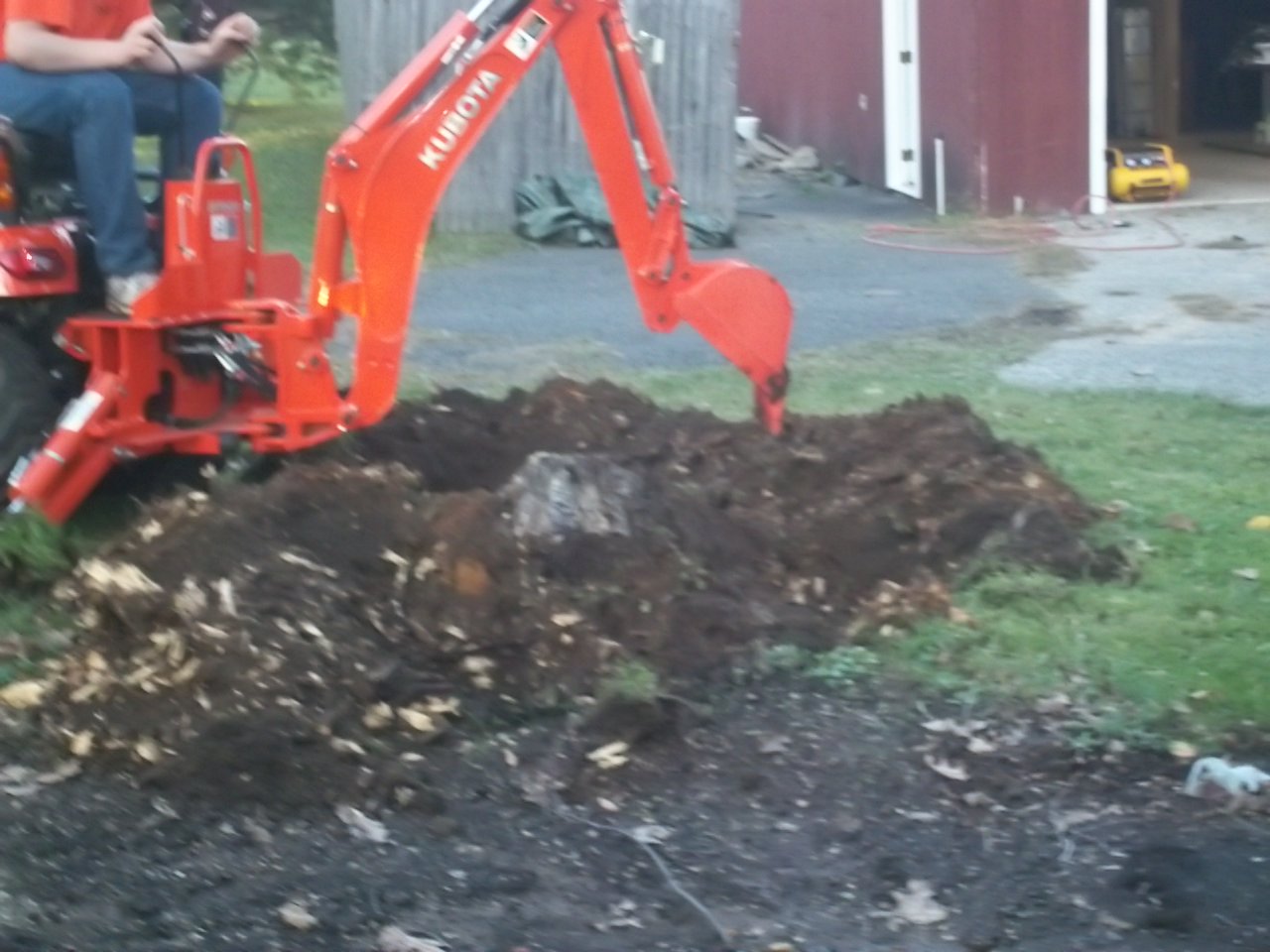

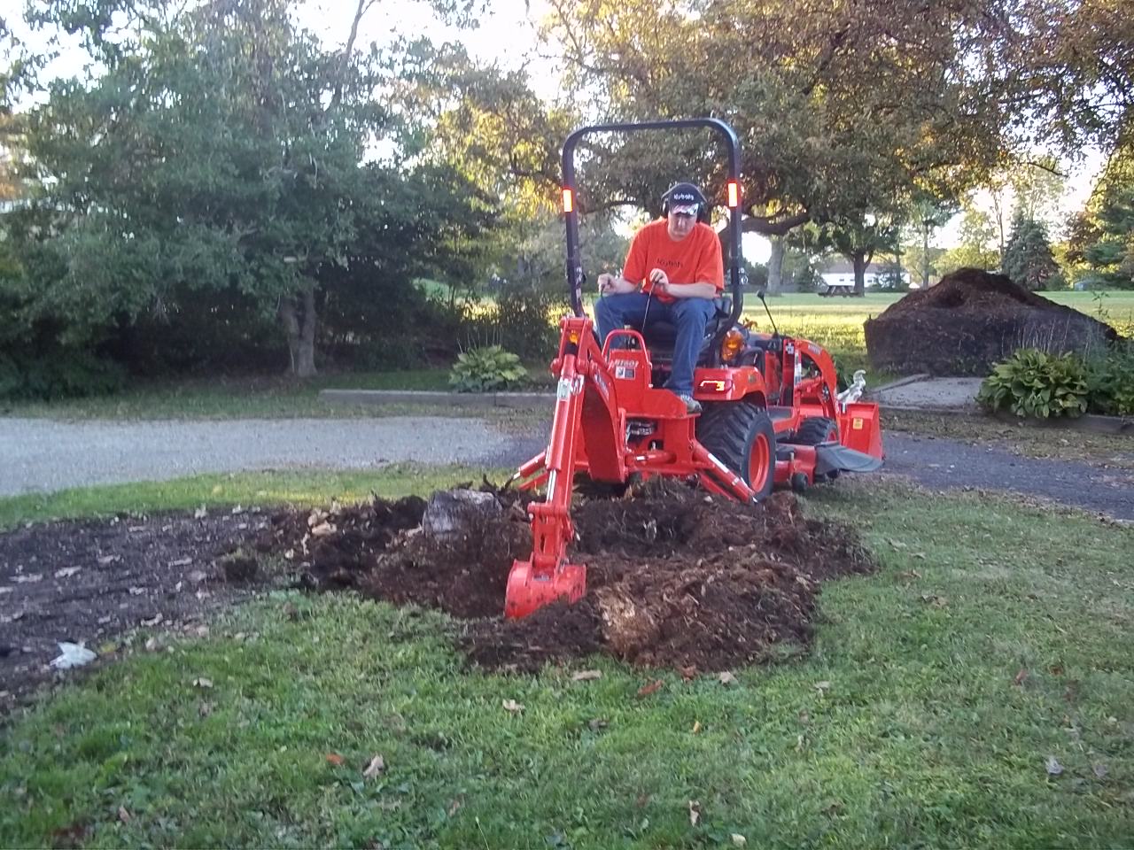

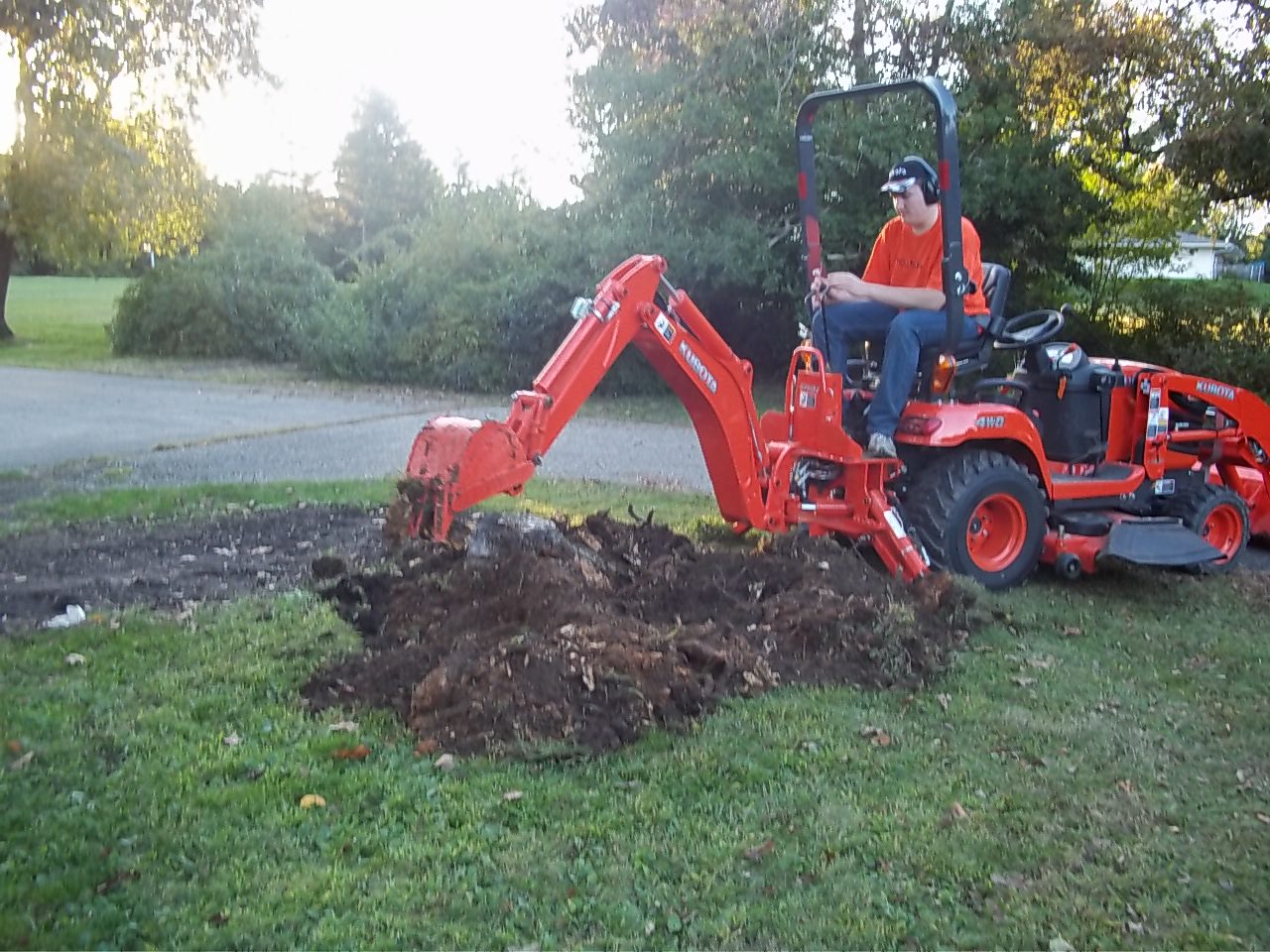

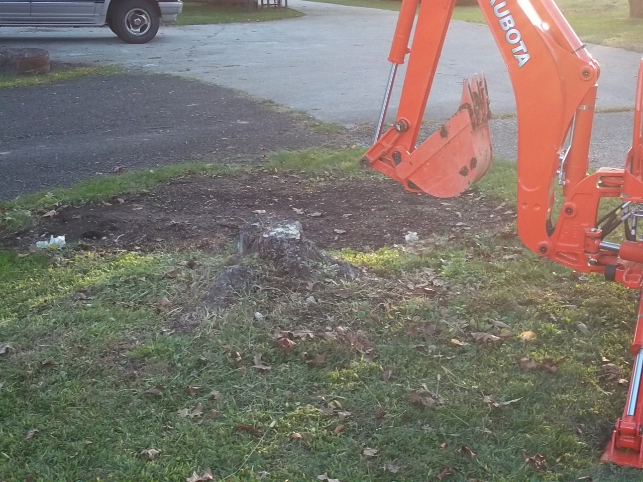

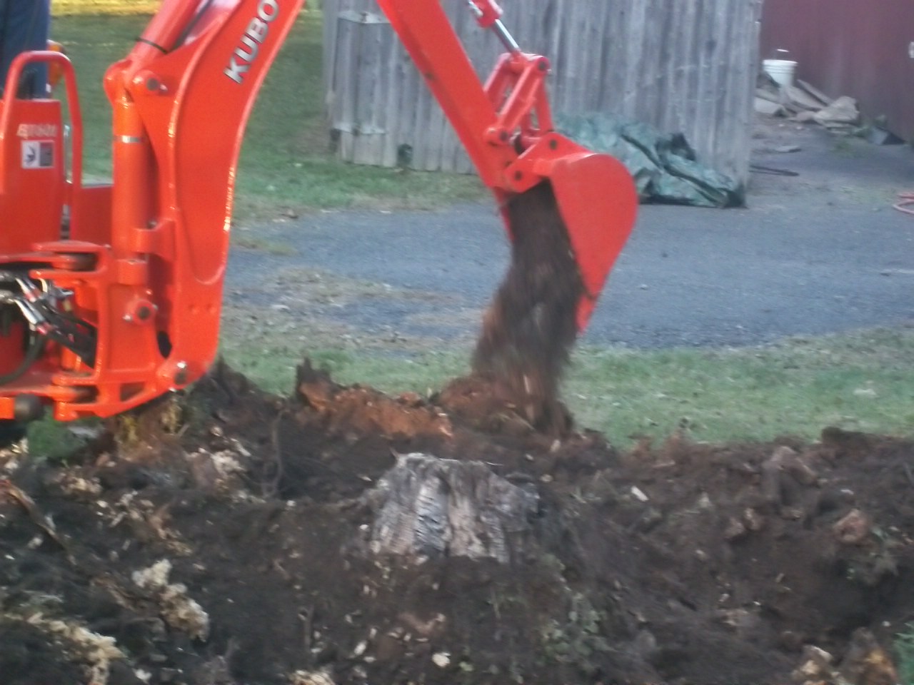

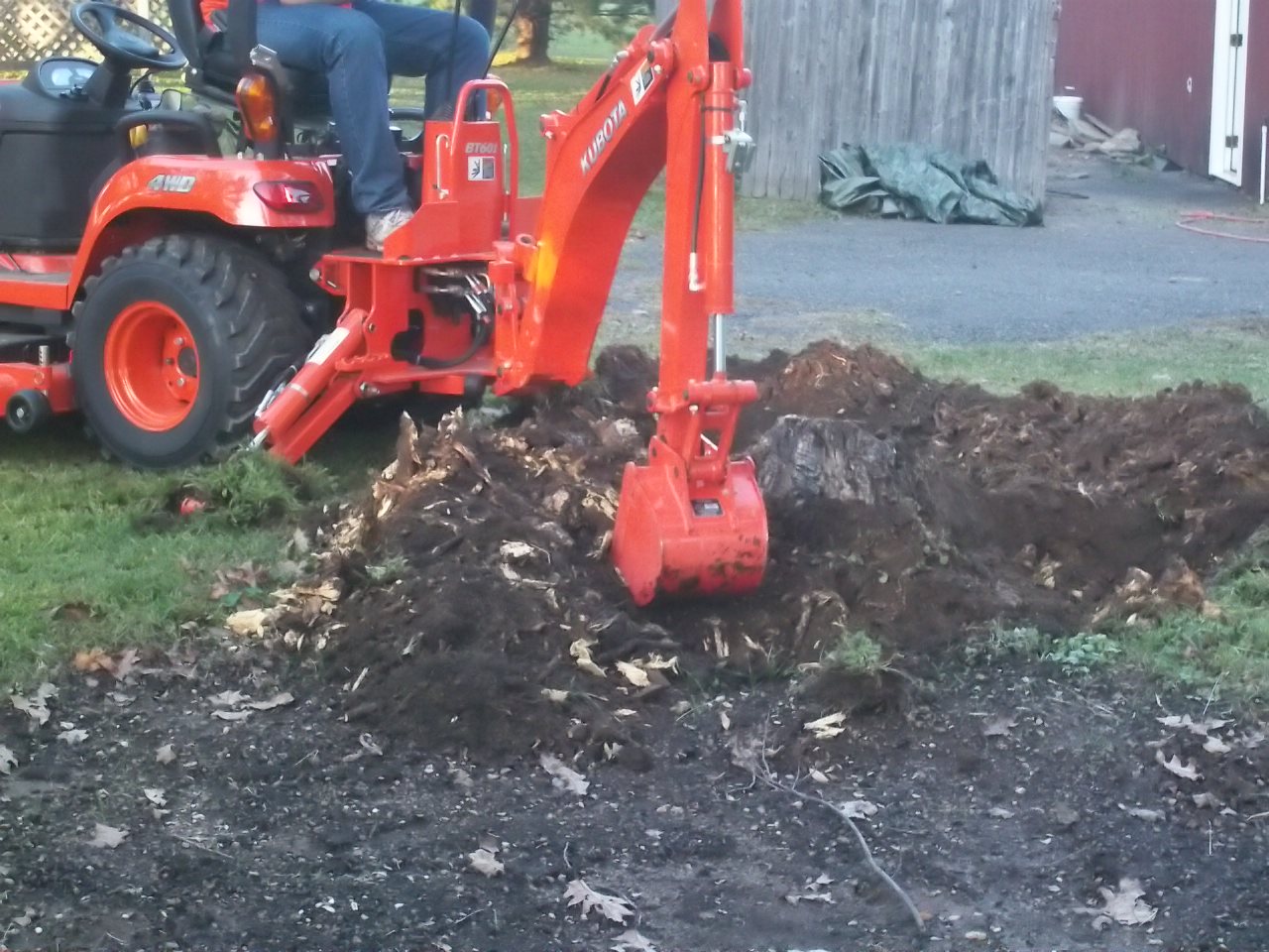

Here is the biggest one yet...It may take a couple of days...
Yes, that is me in the pictures. :)

Nice pic's I'm jealous. And want a backhoe for my tractor . I use a backhoe at work and don't think there's anything better to do than dig out stumps and rocks out of the fields
(the bigger the better). Looks like your having way to much fun !

Believe it or not, it was fun...:laughing:
/ Removing Stumps #11
Look like you have learned the right technique to getting those stumps out. Good Job.
Just curious, is one of those garage doors the one that jumped it your way?
/ Removing Stumps
#12
Yep, the one on the left. If you can see the one on the right, it is down just like the left was when I hit it. The one I hit will be replaced next week. :)

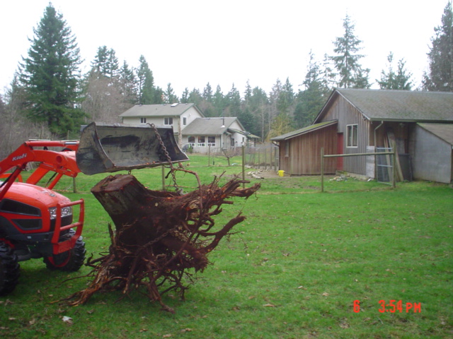

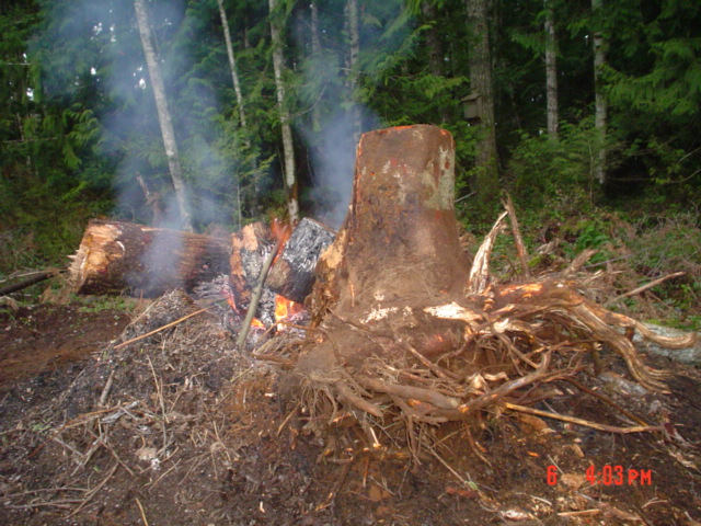

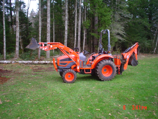

I have dug out a few stumps, most I didn't need to but what the heck, it was seat time. :licking::licking: Got some time on the backhoe and learned a bit on the best way to dig up stumps. Found that I need to dig a bit a way from the stump to be able to break the roots, doesn't work to well if you dig right next to the stump.

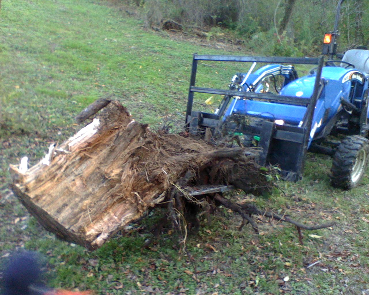

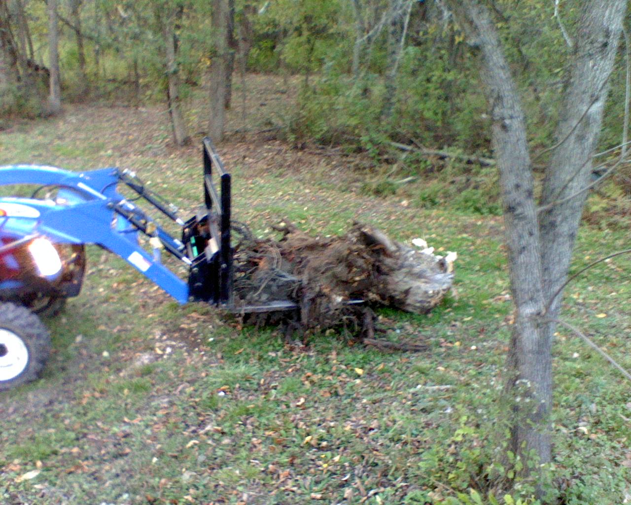

Funny I came across this thread while hunting for "todays seat time". I've been recovering a small piece of land that is on a steep slope. It was all small trees and a bunch of some thorny, nasty, flowering things. Anyway, at the bottom, just right to make me always have to turn on the hill, was a 24" pine stump that blew over 4 or so years ago.
Had the forks on to set a new snowmobile bridge for the ITS trail that crosses the property and got a little side tracked with the stump. I don't have a backhoe, but the forks work just as good. Work around the stump and break any roots by inserting the forks under them and lifting, rolling the forks forward, and driving forward slowly. Then get under the stump itself and do the same thing. This is the biggest I have done so far. Don't think I could've done it with a fresh kill.
Wow! That's a big one...:thumbsup:

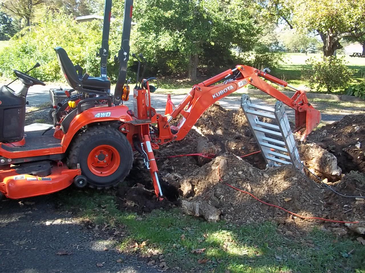

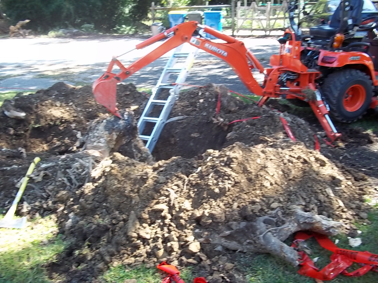

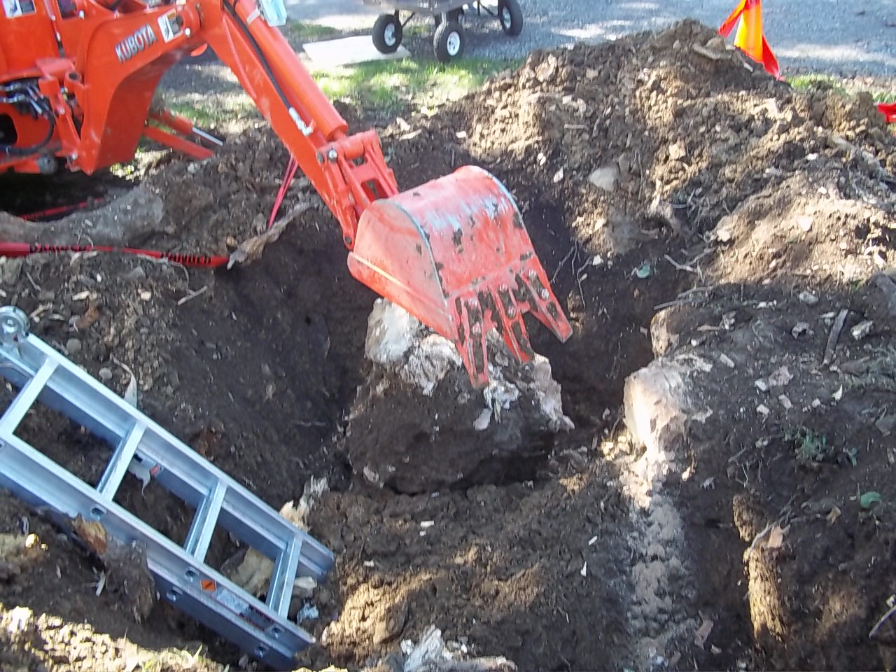

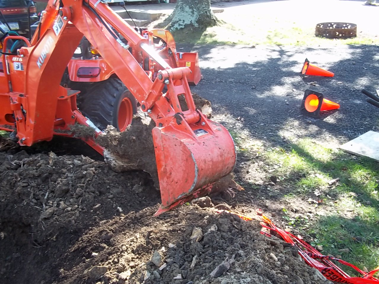

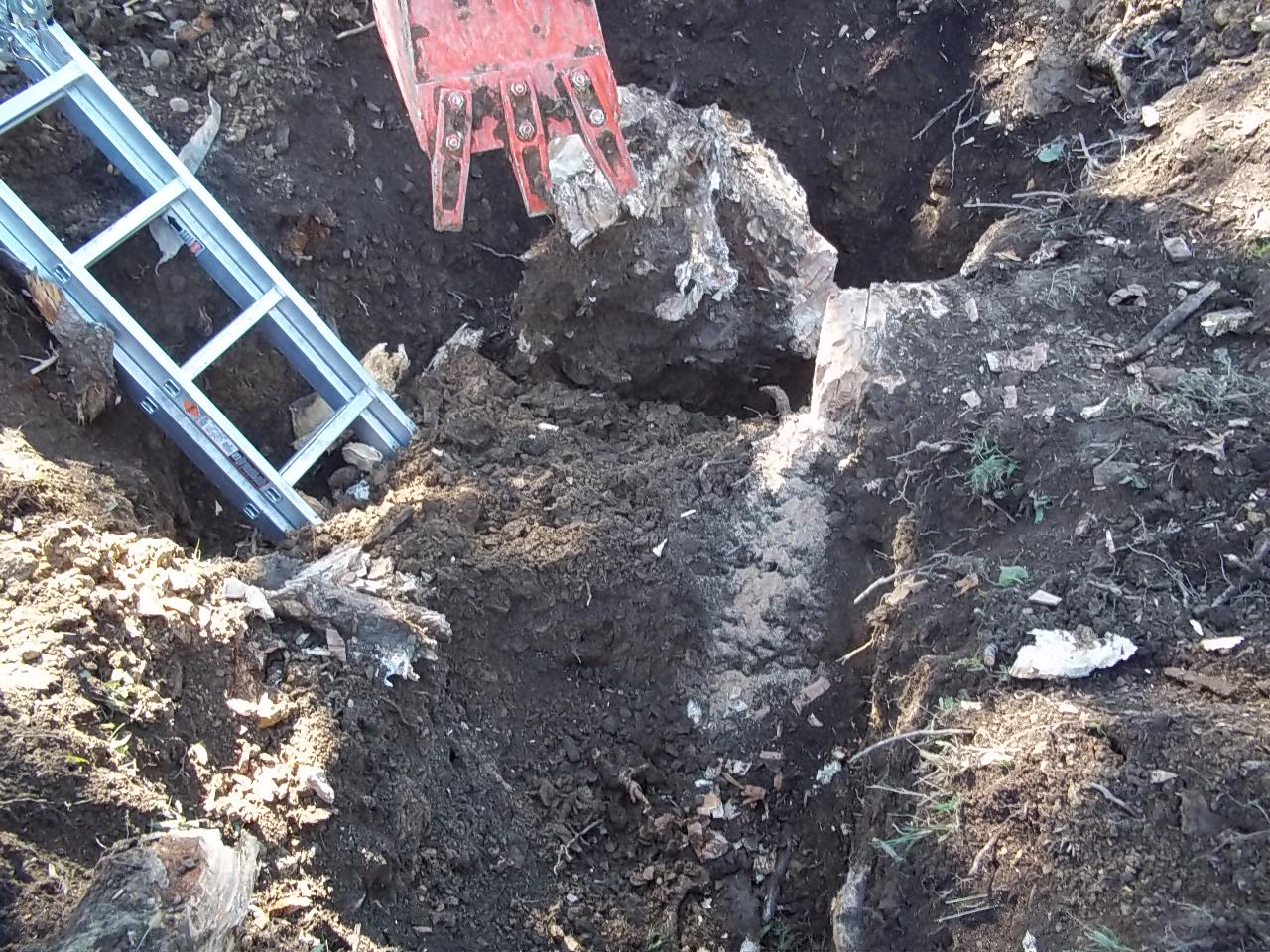

Here is today's work. I finished it in about 3-4 hours total.
