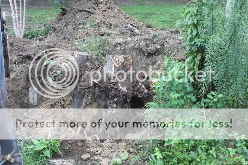

I finally got back to the stump project this weekend, but the excavator I planned to rent was not available. So I rented a JD310 backhoe. Not as much fun as a big excavator, but it is doing the job. I got them to put on a 12 inch bucket, which I thought would be better at breaking the roots and digging a trench around the stumps. Most of the single stumps came out OK, and I was able to hook the 12" bucket around the stumps and carry them to the burn pile.
One of the stumps was much larger--a double stump about the same size as the one my friend had removed. This shows the double stump after I had about finished the basic trench around it.
http://i823.photobucket.com/albums/...rm/landscaping/StumpRemoval/IMG_5444_800w.jpg

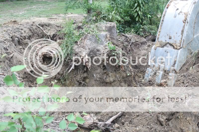

Next I started working to pick some of the dirt off the bottom. That was pretty difficult, because the bucket would not extend enough to get under the stump unless I positioned the machine pretty far from the stump. This required moving the machine several times. By the time I finished this, I could wiggle the stump and break it loose. This is how it looked after this step.
http://i823.photobucket.com/albums/...rm/landscaping/StumpRemoval/IMG_5448_800w.jpg

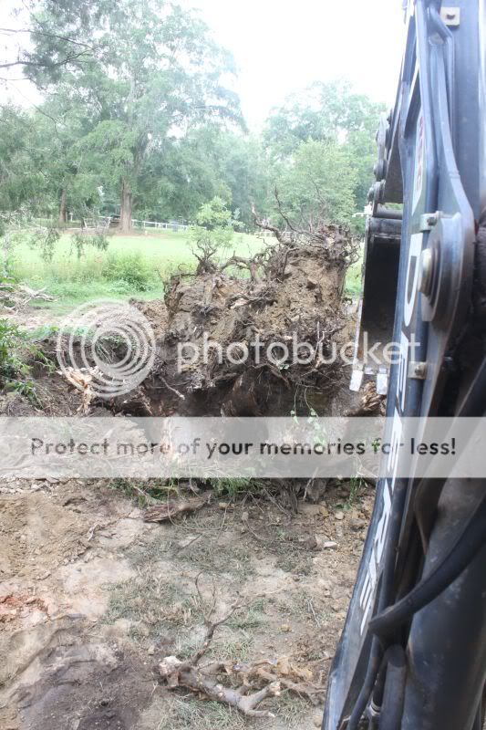

Then I moved to the other side and managed to roll it out of the hole.
http://i823.photobucket.com/albums/...rm/landscaping/StumpRemoval/IMG_5452_800t.jpg

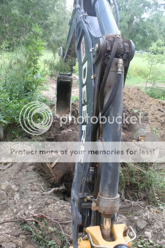

Here it is upside down just barely out of the hole.
http://i823.photobucket.com/albums/...rm/landscaping/StumpRemoval/IMG_5453_800t.jpg

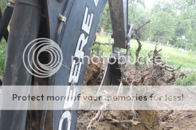

It was still way to heavy to move, so I kept picking at the dirt between the two stumps.
http://i823.photobucket.com/albums/...rm/landscaping/StumpRemoval/IMG_5455_800w.jpg

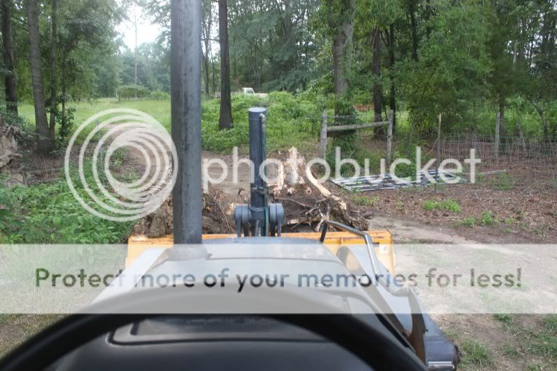

It was still too heavy to pick up, but I was able to push it to the burn pile.
http://i823.photobucket.com/albums/...rm/landscaping/StumpRemoval/IMG_5458_800w.jpg
