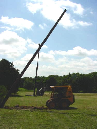

Nothing but a thing.
First you dig a hole seven feet deep besides the pole.
Then you grab the pole with your tractor.

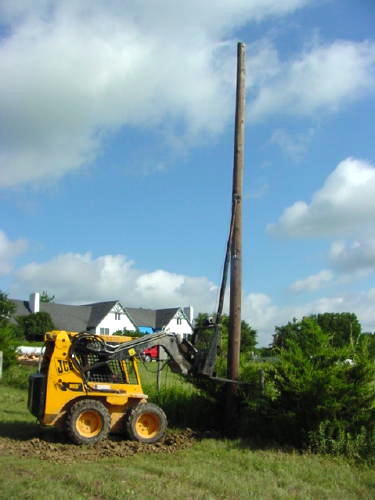

   / Removing unused utility pole -safely #7
Then you carefully pull it out of the hole.

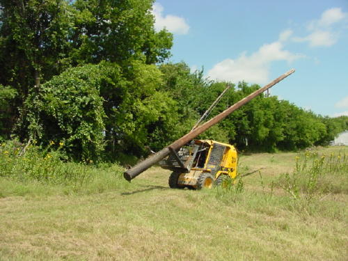

   / Removing unused utility pole -safely #8
Of course traveling with it does present an exciting ride. /forums/images/graemlins/grin.gif
