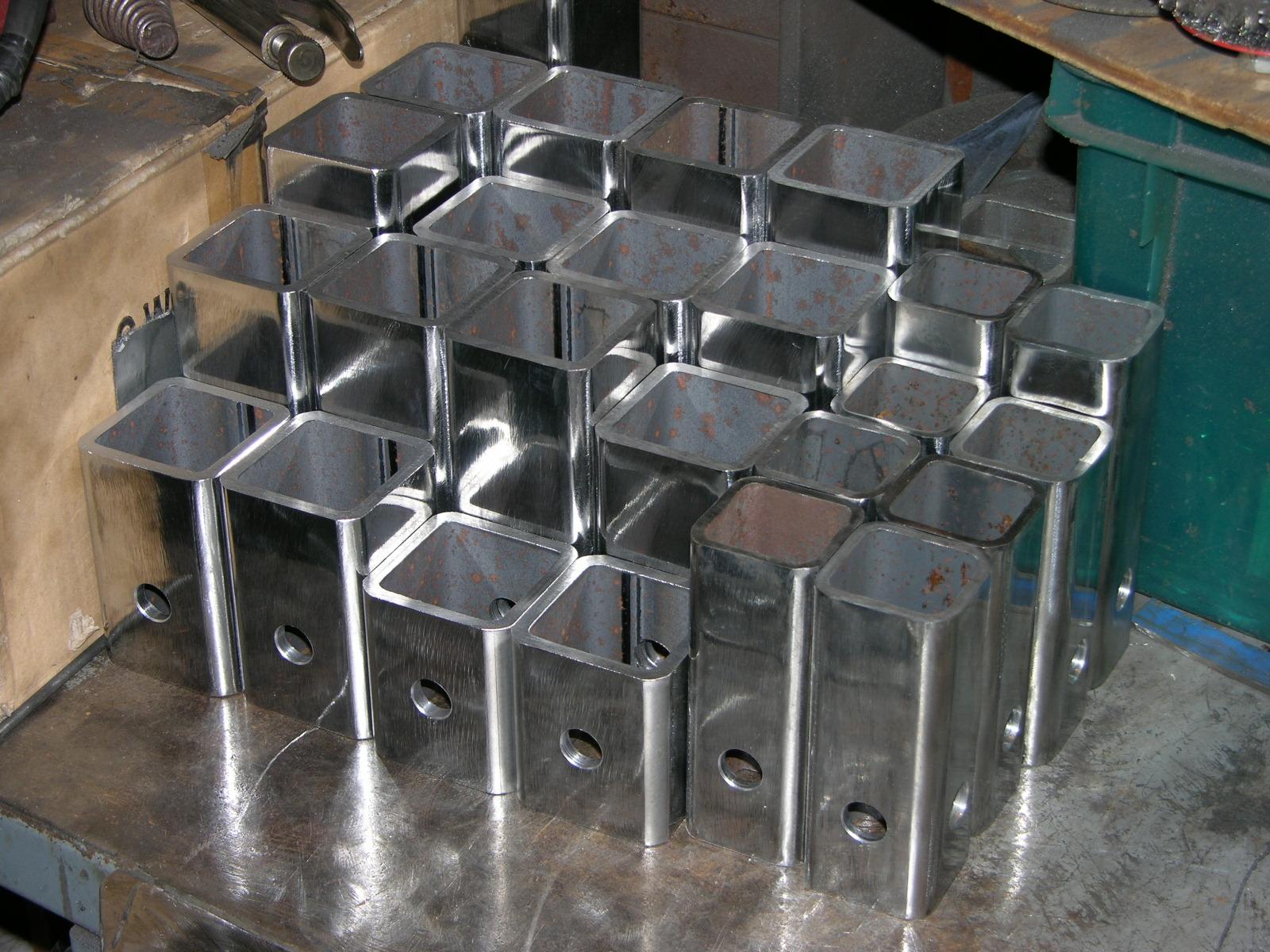

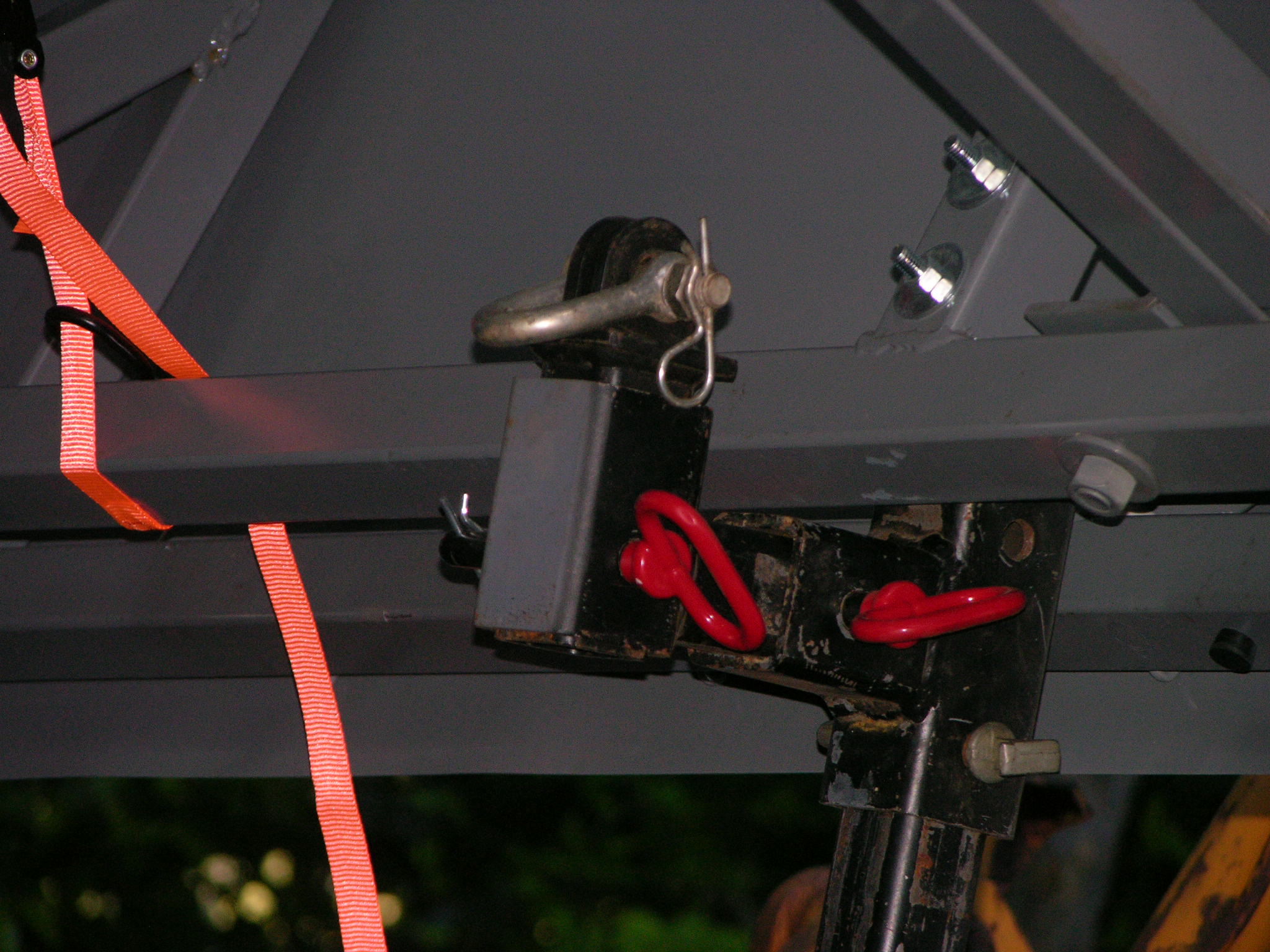

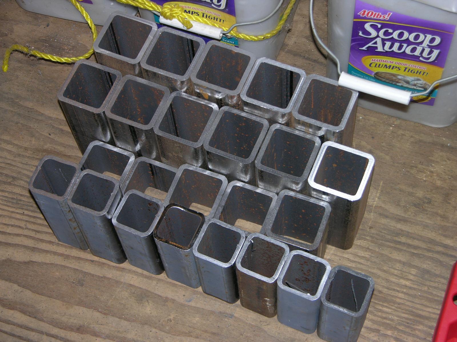

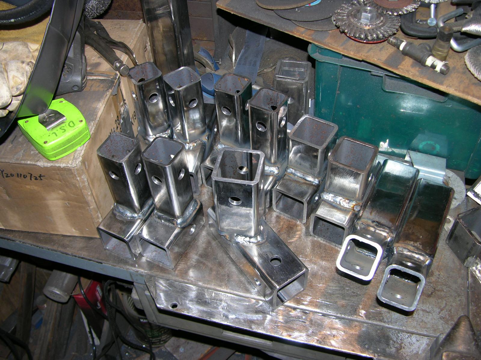

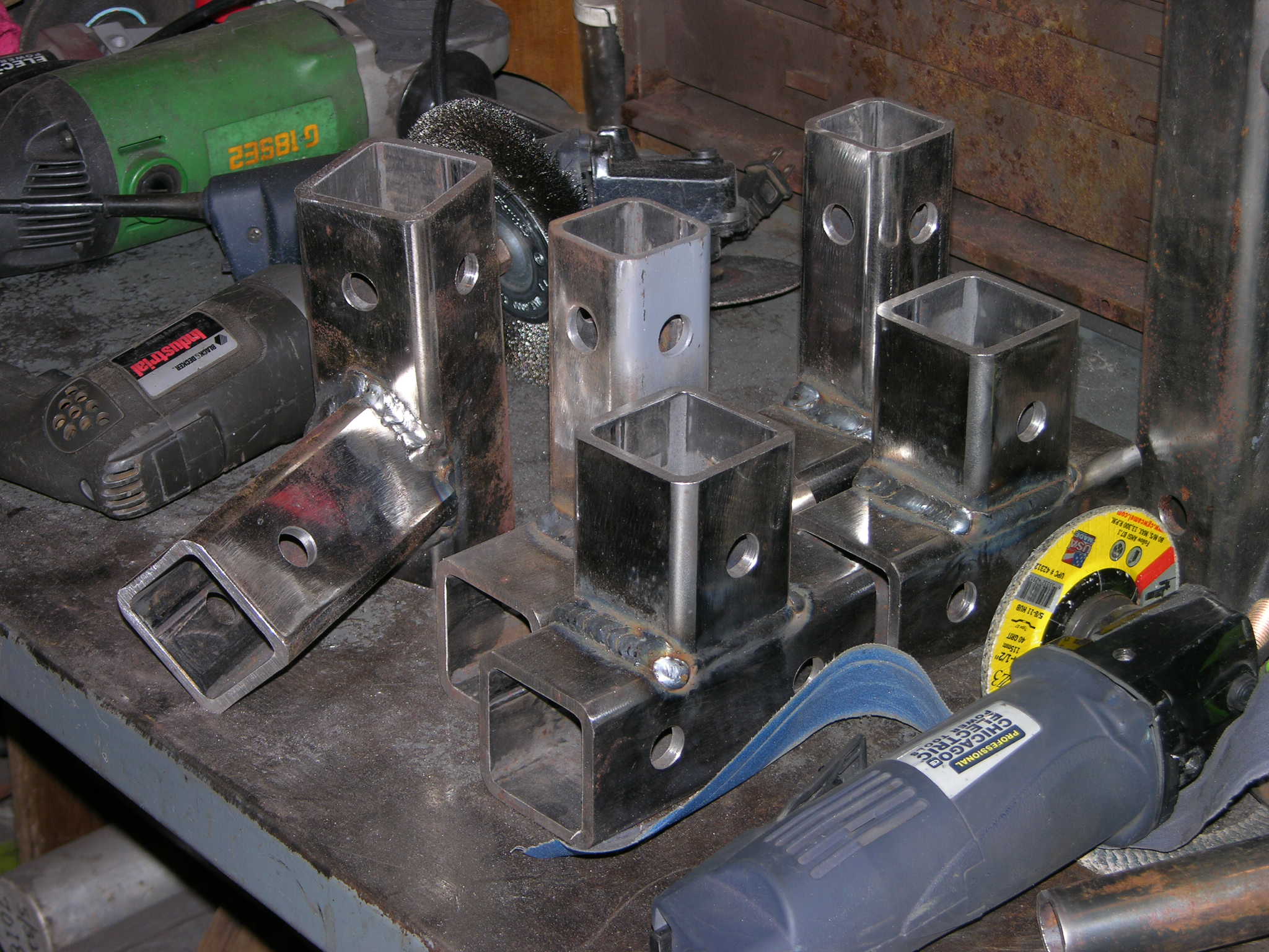

Buying by the 20' stick my cost for the receiver tube is right at $8.25 per foot - The 2x2x.250" wall runs about $5.50. If you're actually gonna be in the Albany area and want some, PM me here ahead of time and let me know how much you'll want; I usually don't reorder til it's down around 2-3 feet left. During the week I get orders within 2 days (usually the NEXT day) of calling it in.

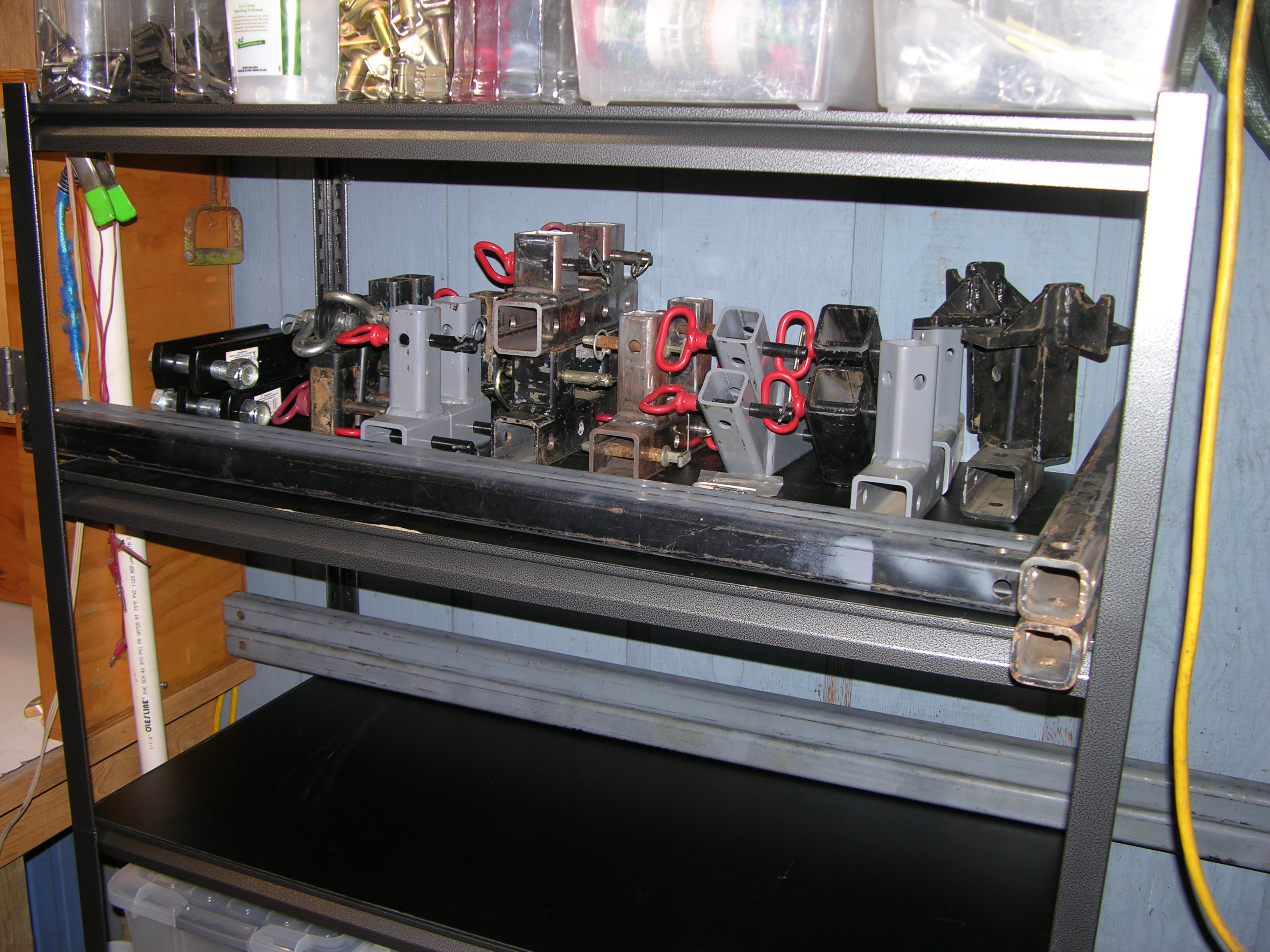

BTW, the HF 18" piece weighs 6# per foot, the tubing I get is just over 8# per foot, so basically 3/16" wall vs. 1/4" wall. Realistically, if a person isn't using a LOT of this stuff (or doesn't need the extra strength of the thicker wall) it probably isn't worth messing with.

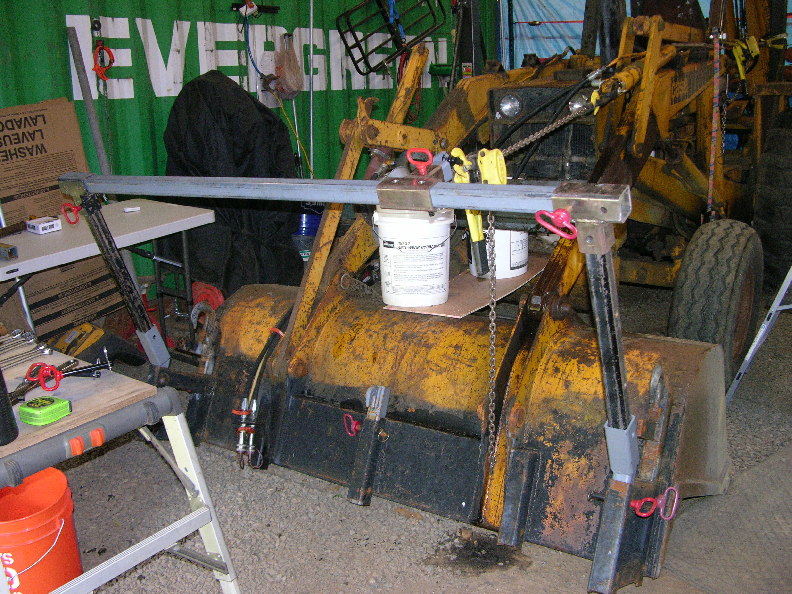

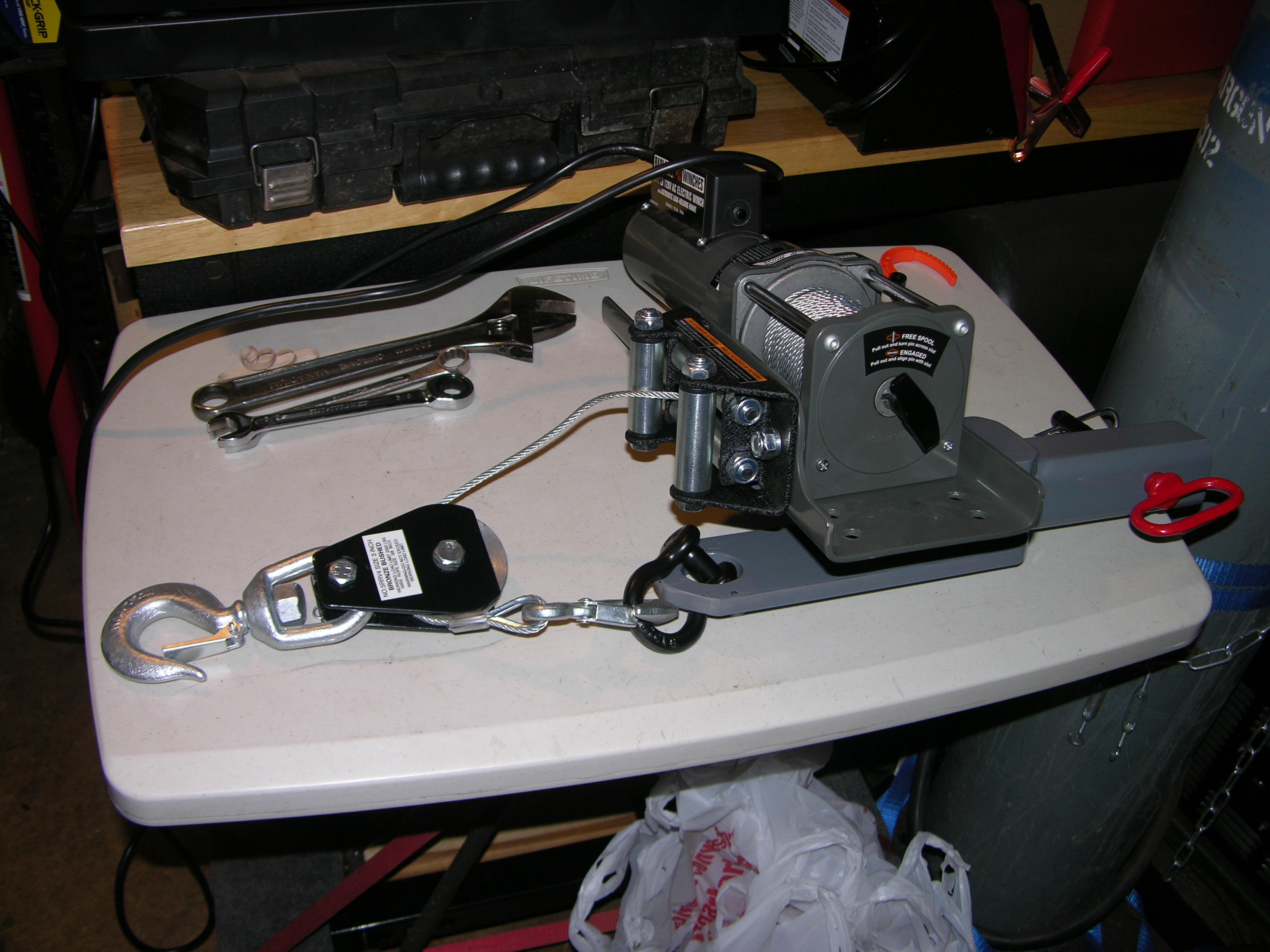

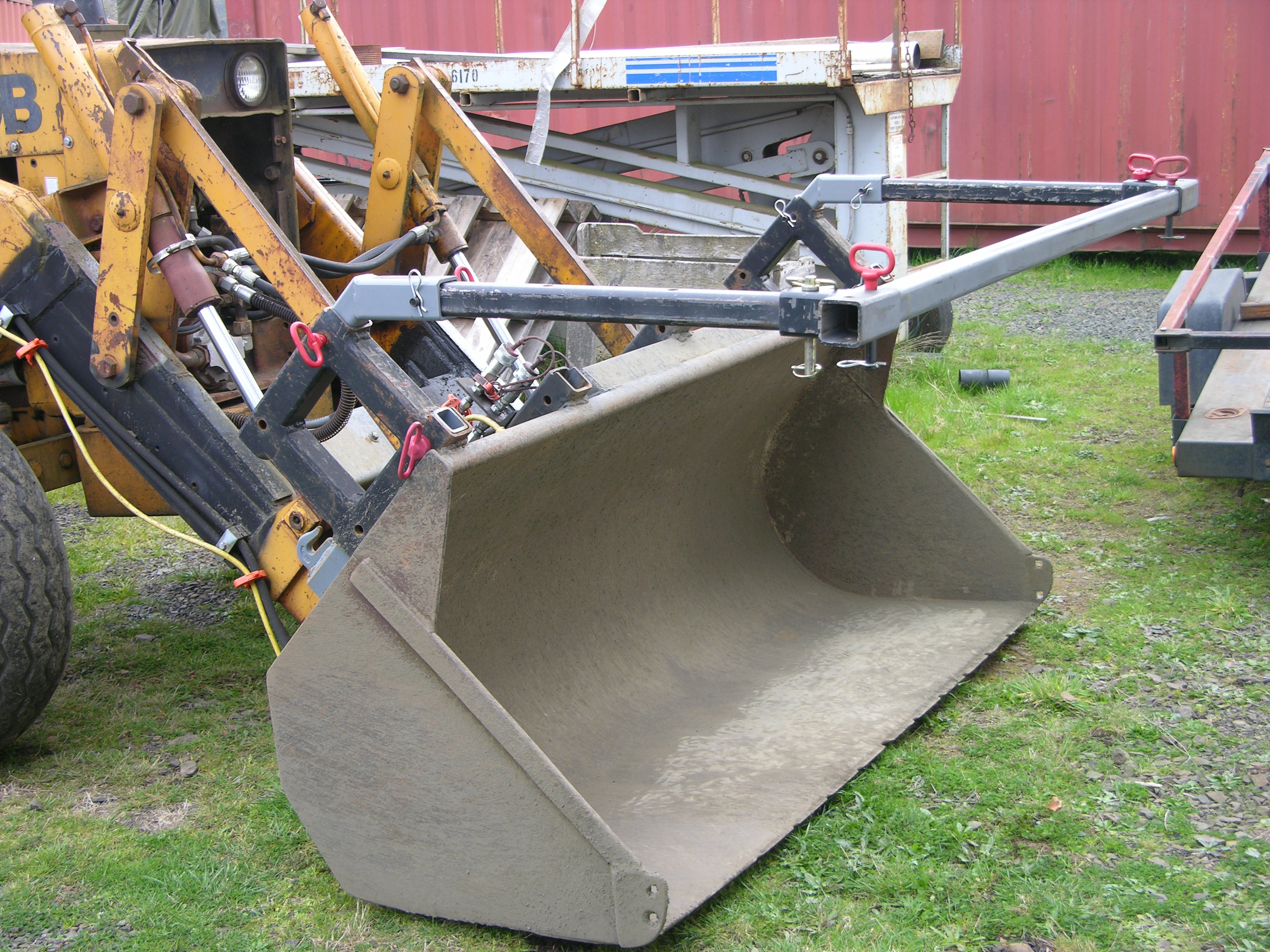

Here's a few of the "tinker toys" in process, the place they usually hang out when not in use, and a handy little 120 volt winch that can plug in wherever I have a reciever (or a place to clamp to) - runs fine on the little 2kw inverter genny.

Why not use his method for the round tubing on the square tube? Then you don't have to worry about where the weld seam is. It may wear a little more but easy to touch up if it dulls.

Yah 1/4 is a stronger socket (if necessary). The HF one can be beefed up too, in fact their collar is lame, you have to burn the paint out & re-weld it anyway.

Sometimes you can get a better fit removing the seam thsn choosing the oversize.
I once did a plug something like his but not a cutter, I pushed it thru, with a little raised weld bead that just shoved the seam up out of the way.
With a 20T press. I wondered if it might just get stuck but it had no trouble.

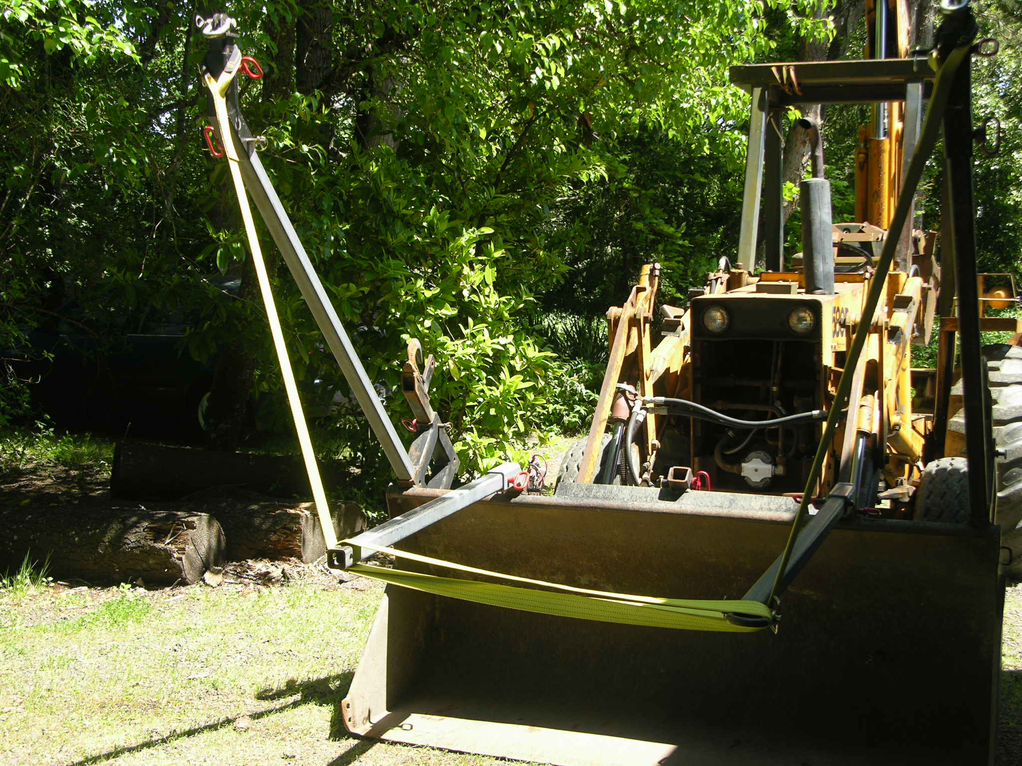

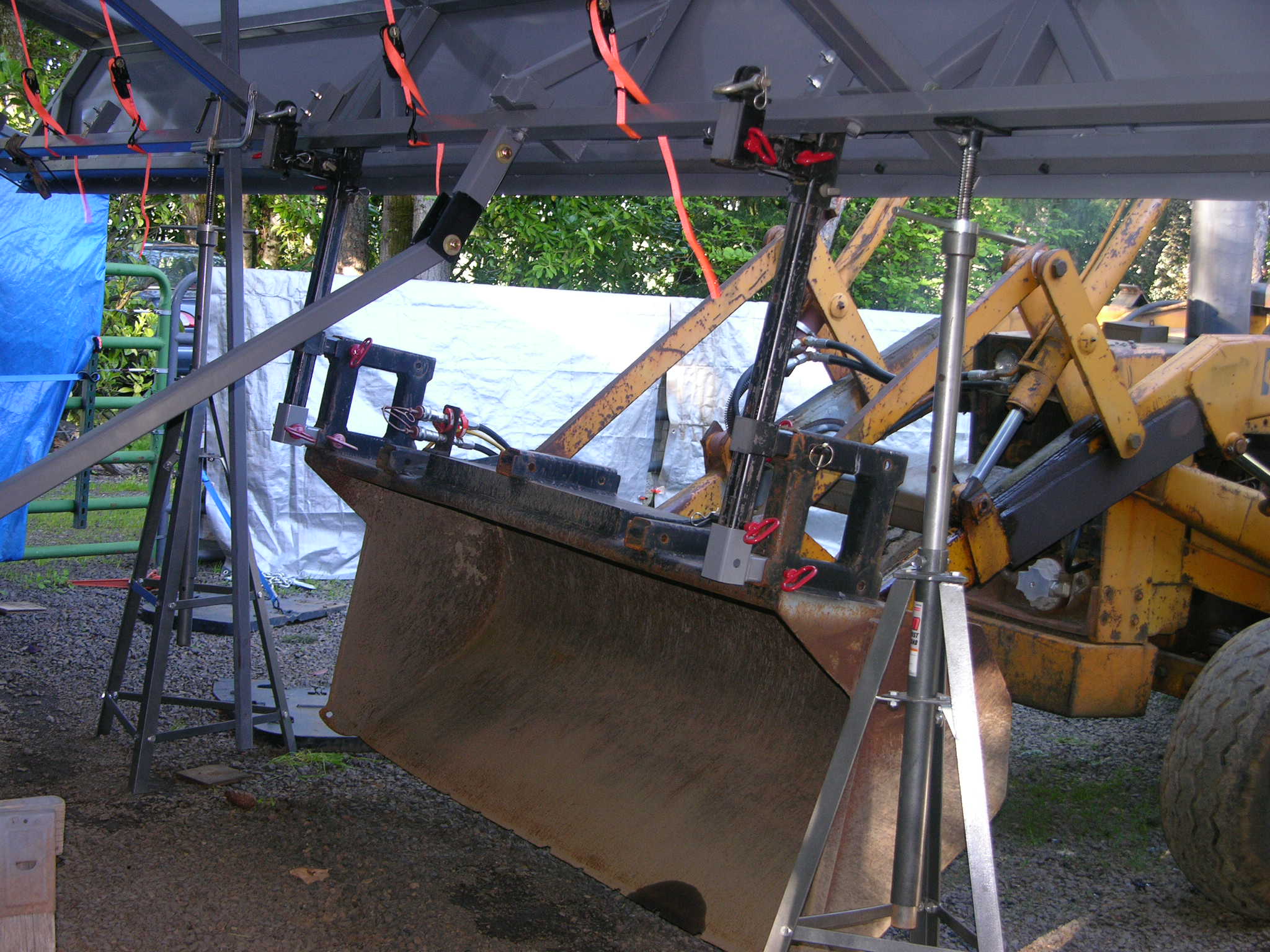

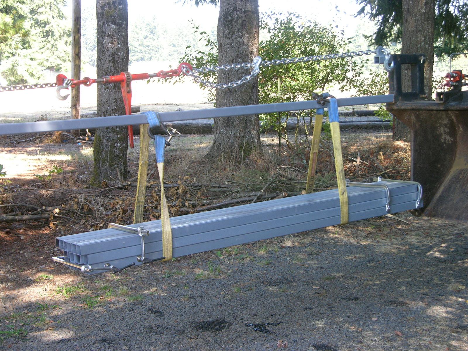

Nope - quite the opposite, my tinker toys actually keep me IN control - between having pairs of 2.5', 4' and 6' pre-drilled 2x2 "arms" and nearly any combo of male/female, both male or both female adapters in straight, 90 and 45* (at least two of each) I can piece together a safe way to rig nearly ANYTHING up for safe lifting/carrying.

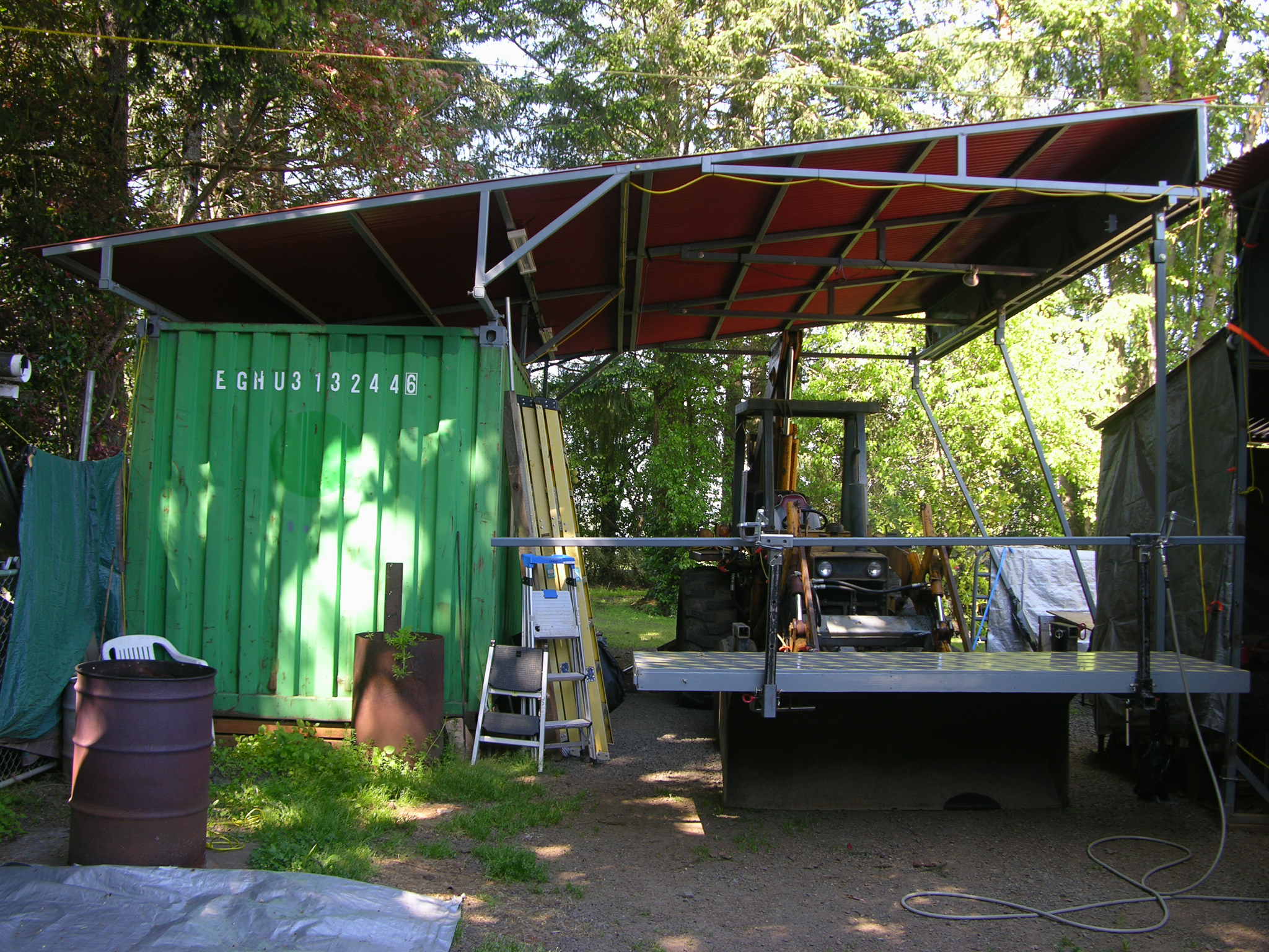

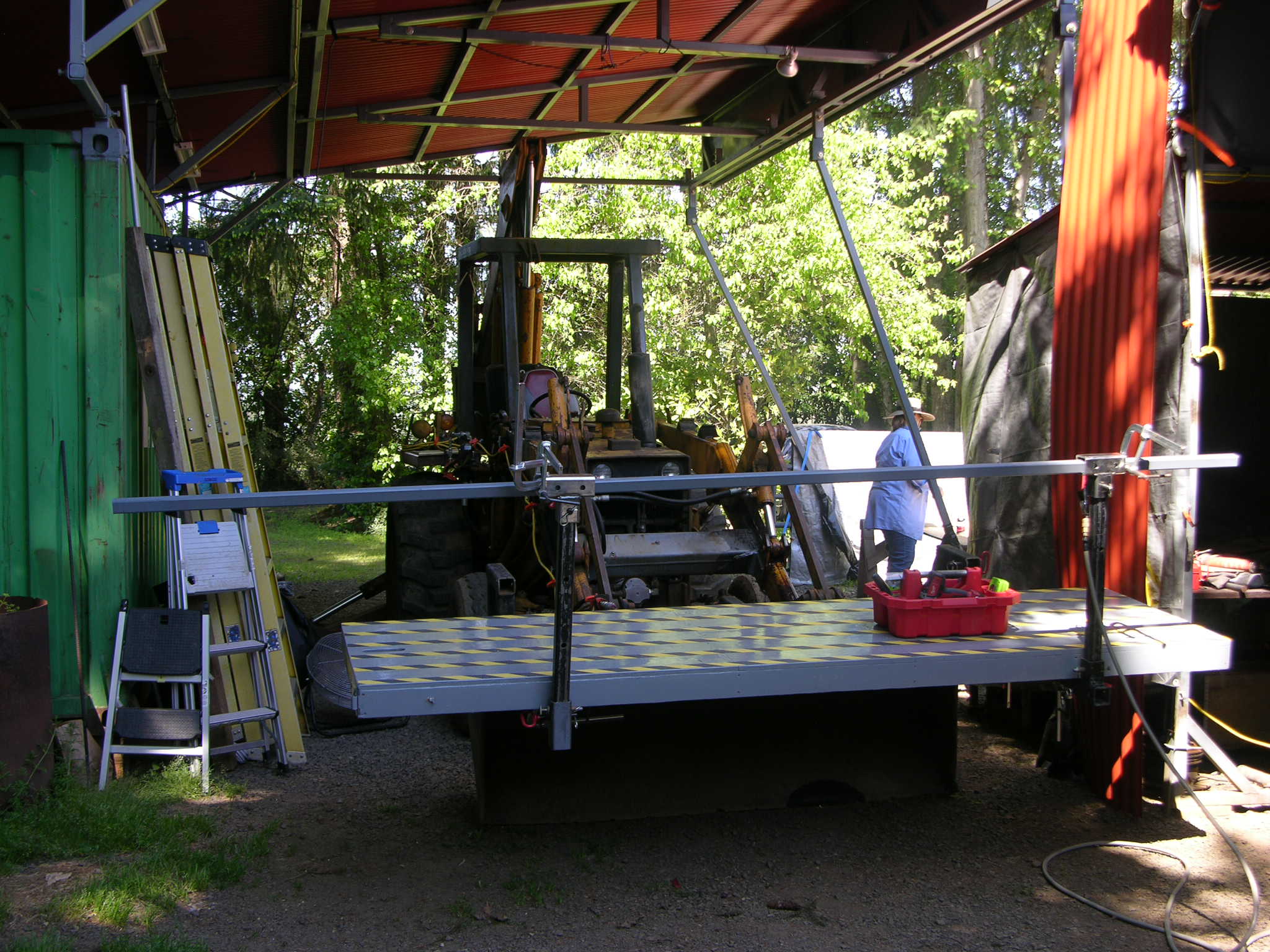

Add to that my "super plank" (3/4 ply over 2x4 frame, non-skid top, built in removable "wheelbarrow wheel" (sucker is HEAVY) and I can put a 3'x10' work platform anywhere I can get to with the loader.
Jobs i've already used this "system" for include
Moving bundles of steel down my driveway and into containers with the bundle PARALLEL to direction of travel (driveway is NOT 20' wide) - this lets me use bucket curl to control the angle it enters the container, so the first end to enter the container can rest on a car dolly while I reposition the lift further back and get the entire bundle inside the container WITHOUT having to either rig up a separate lift OR hurt my back.

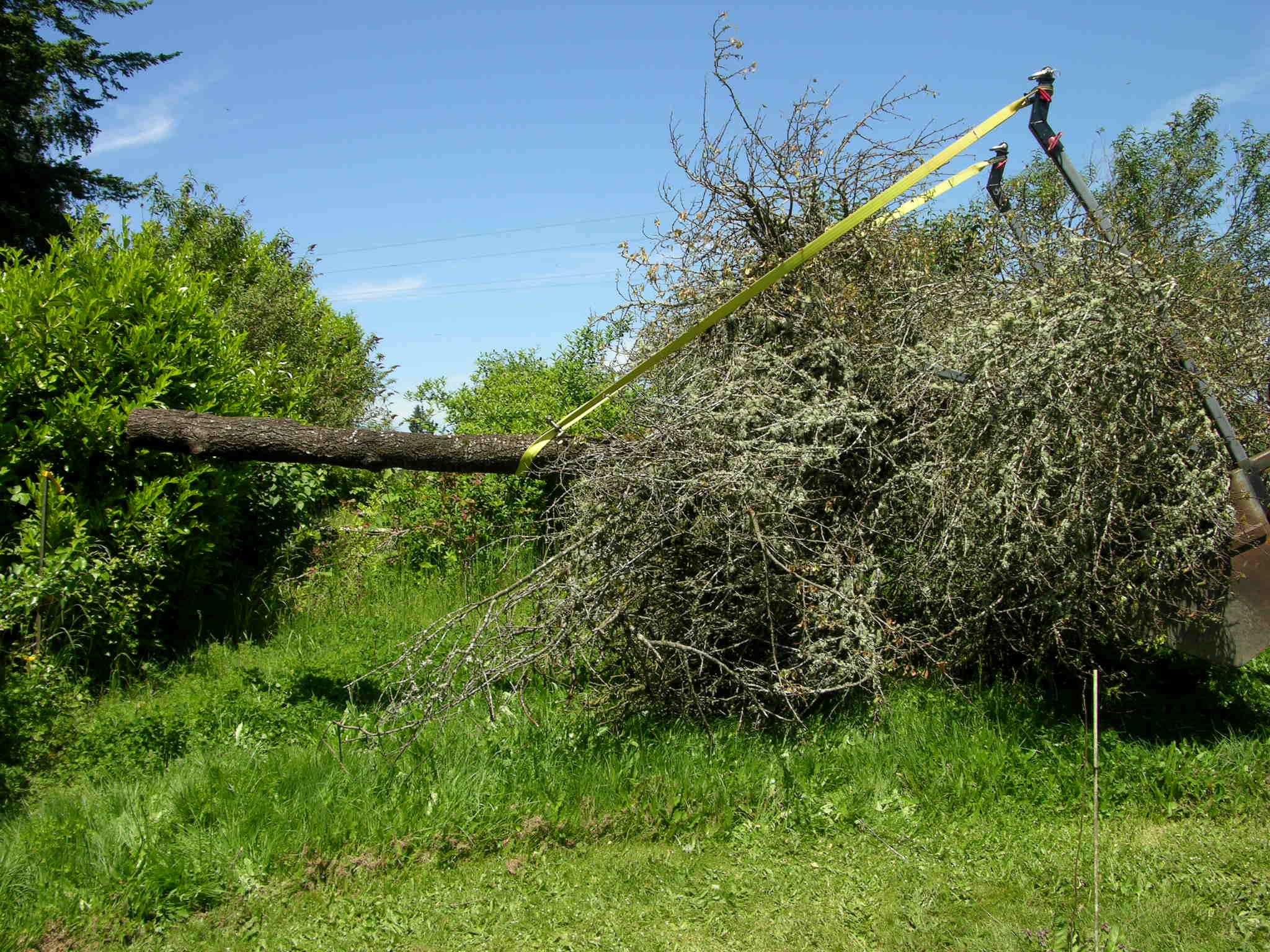

Pick up an entire downed tree (endwise, about 10" at the butt) from my neighbor's yard and move it to my burn pile so I could cut usable firewood out before burning, WITHOUT making a mess in the neighbor's yard (the shorter, inboard pair of tubes were to act like a bale spear to keep the crown from shifting on its 300 yard trip to the burn pile) DSCN2810.JPG DSCN2811.JPG
Use the super plank when roofing the 24' square modular roof I built over the 20' container, so I could get my entire weight directly over the impact driver when using self-drilling screws DSCN2799.JPG DSCN2801.JPG
Rigging/lifting the above roof frame into place (and relocating/re-using said roof later[module by module], should my future plans actually materialize) :rolleyes:) DSCN2768.JPG DSCN2769.JPG
cobble makeshift gin pole (using chain as upper brace) for moving smaller bundles of steel around DSCN2273.JPG

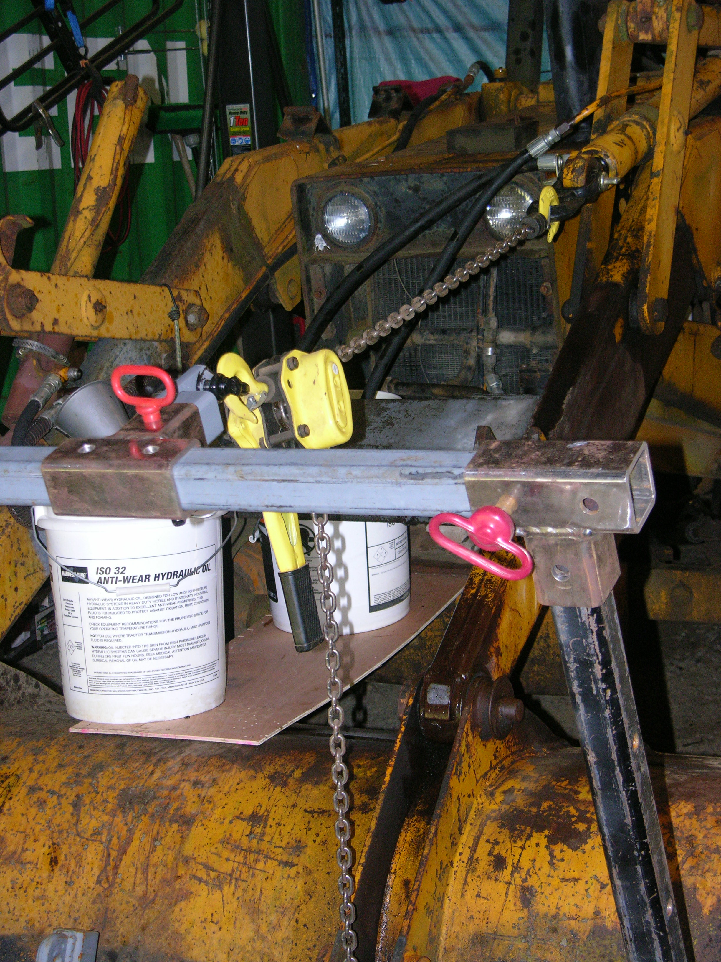

Creating a "pull point" where there WAS NONE for pulling the rods out of hyd cylinders to rebuild (still have 6 more to do on the 580B) DSCN3261.JPG DSCN3262.JPG
Using my 100# vise anywhere the 580 can drive
