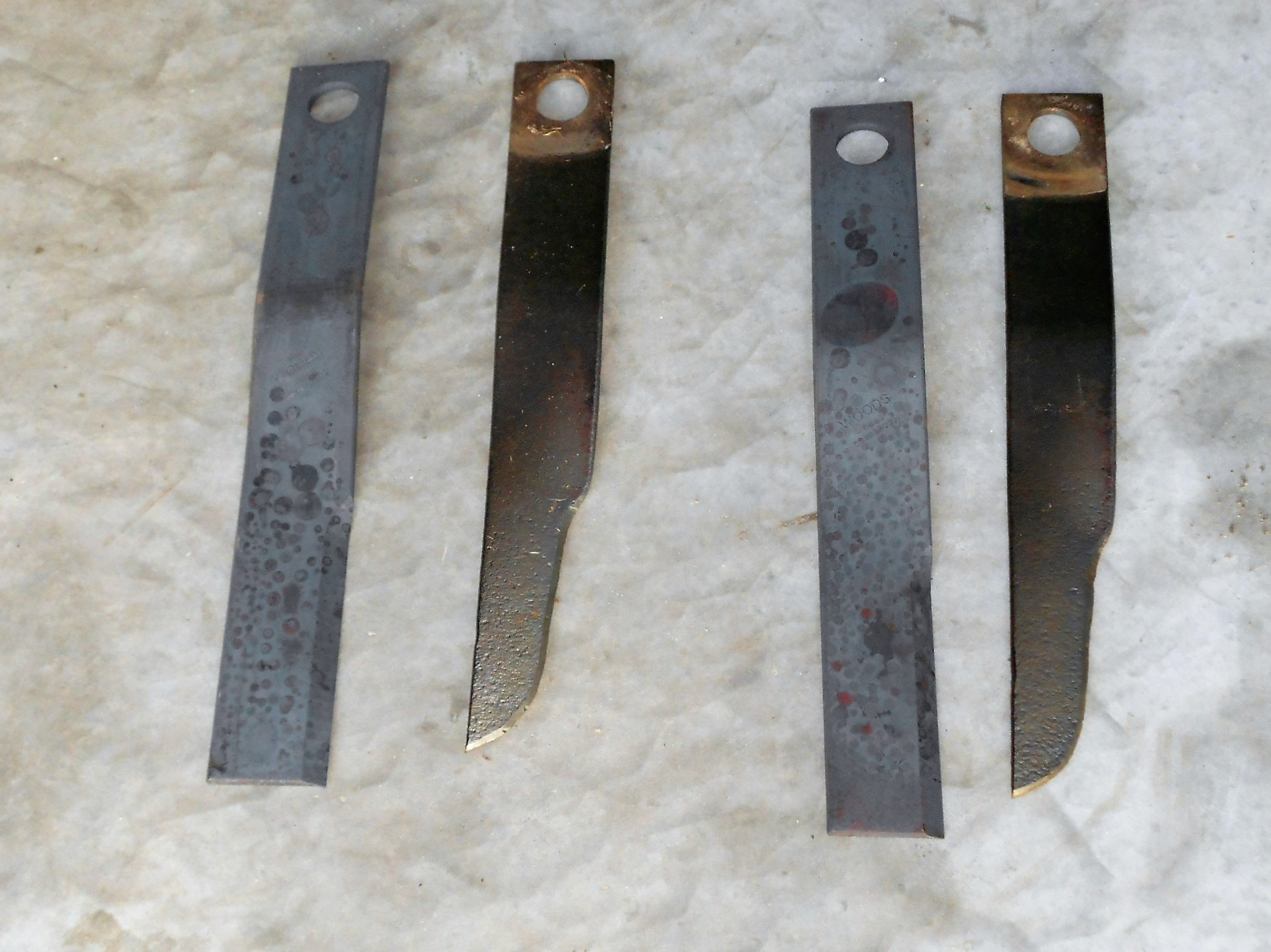

I changed the blades on my 5' Woods and I believe looking at the old blades they were original.
I don't know how old the cutter is but I bought it VERY USED!
It took very little time and was easy.

Stimw, I'd say you got your mileage out of those blades!
