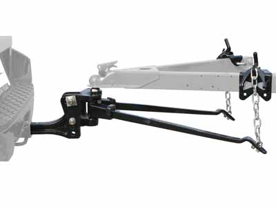

All trucks including 2500 series require a weight distribution hitch above a certain limit. Some 3/4 ton trucks have a 300 lb tongue/3000 lb limit without one. The 500/5000 limit is actually average to above average in 3/4 tons.
Unfortunately many don't realize this. I see a lot of skid steers and mini excavators being hauled behind 3/4 ton trucks without a WD hitch and 99% of them are exceeding their hitch limits. You can purchase aftermarket hitches but that doesn't change what the manual states.
Having the WD hitch spreads the tongue load across all the bolts holding the hitch on rather than just the rear bolts taking all the tension. Not to mention adding addition weight to your most important stopping axle, the front.

A weight distributing hitch is not part of the trailer it is a special ball mount which has sockets built in for weight distributing spring bars , you then add a set of "snap up brackets" to the A frame of the trailer, the snap ups attach quickly so they could be moved from trailer to trailer if need be , then you add a set of spring bars appropriate for the weight of trailer you're pulling and set the tension when you hook up.

O.K. thanks, I think I got now , my truck just has the class 4 2"receiver hitch so 500/ 5000 no weight distribution, 1000/10000 with weight distribution installed... new trucks with the class 5 and the 2&1/2 receiver are higher... And for the 20 foot 5th wheel utility trailer that I use the most, it's really more a matter of the trailers rating - which is 12,000 lbs. then if I use a heavier duty trailer can go up to about 13500 lbs. = up to the vehicles GCWR of 21000 lbs. 13.5k+7.5k =21klbs.
