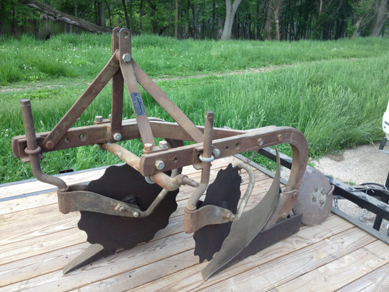

I am picking-up an old ferguson plow this weekend -- covered in rust.
What's the best approach to removing the rust?

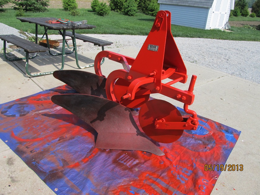

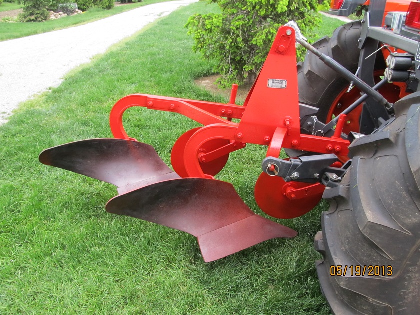

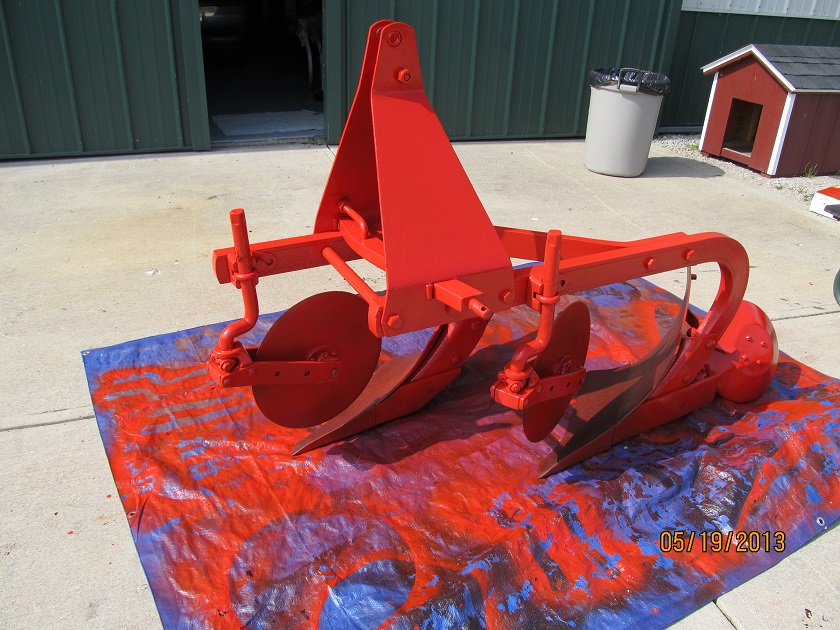

All done. Had to touch up the bolt heads and give a light coat on the flat surfaces and I was good to go. The moldboards have a light coat of flat black and will scour quickly. I painted the coulter blades and landslides red because they needed something but I think they will also scour quickly. Either way they are now red. This was so easy and turns a beautiful plow of yesteryear into a beautiful and functional plow of today. The quality of steel seems way superior to that of today and given my choice between one of these or a modern plow recently made, I'd easily take this old one.
If you ever do this yourself, take photos before you disassemble. All plow bolts need to go back in the same holes and chase any threads that are the least bit bunged up. I put a drop of oil on threads before I paint things and that way the paint won't stick and I can oil later in case stuff ever has to come apart again. Paint things apart the best you can, assemble and then finish coat it. If the item is in good condition it's now worth top dollar and I have found that people will readily pay up for something painted and done right. Plus look at the history being saved. Imagine the late 1940's or early 1950's when there were hundreds of these beautiful plows awaiting farmers looking for their slice of the American dream.
Here's the old "before" photo

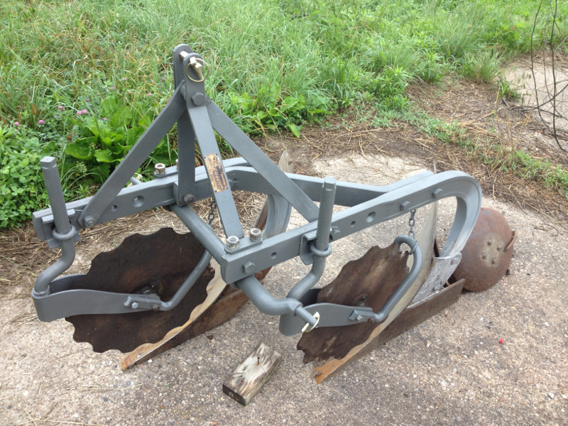

Well, I spent the better part of my weekend disassembling, priming and painting my "new" plow. Here is a snapshot of the plow now...
