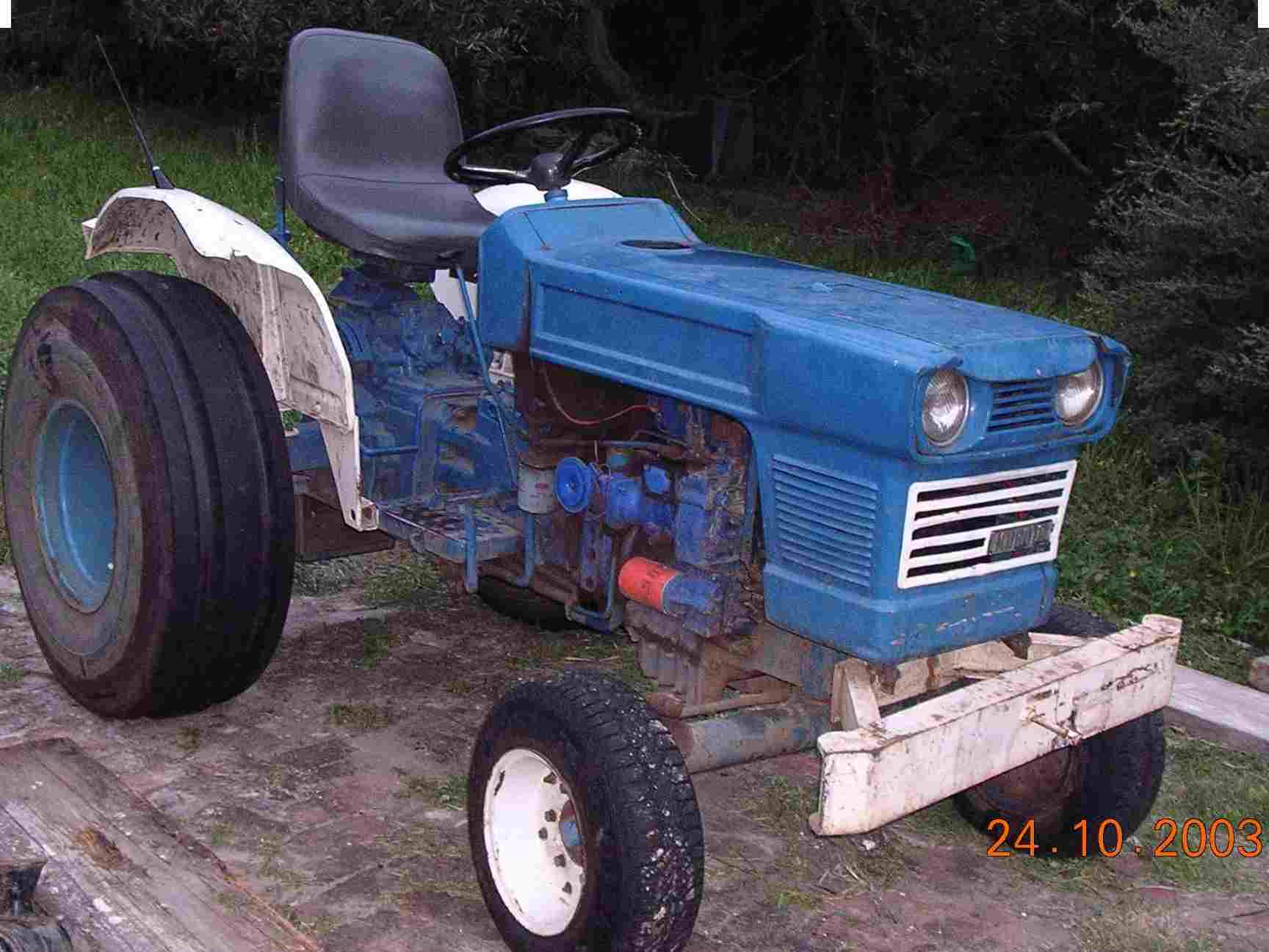

Here is a before Pic Of the latest spray job we did.
As you can see blue just did not do it for a kubota

Nice looking paint job; and you're right, orange looks a lot better on that tractor. /forums/images/graemlins/grin.gif
