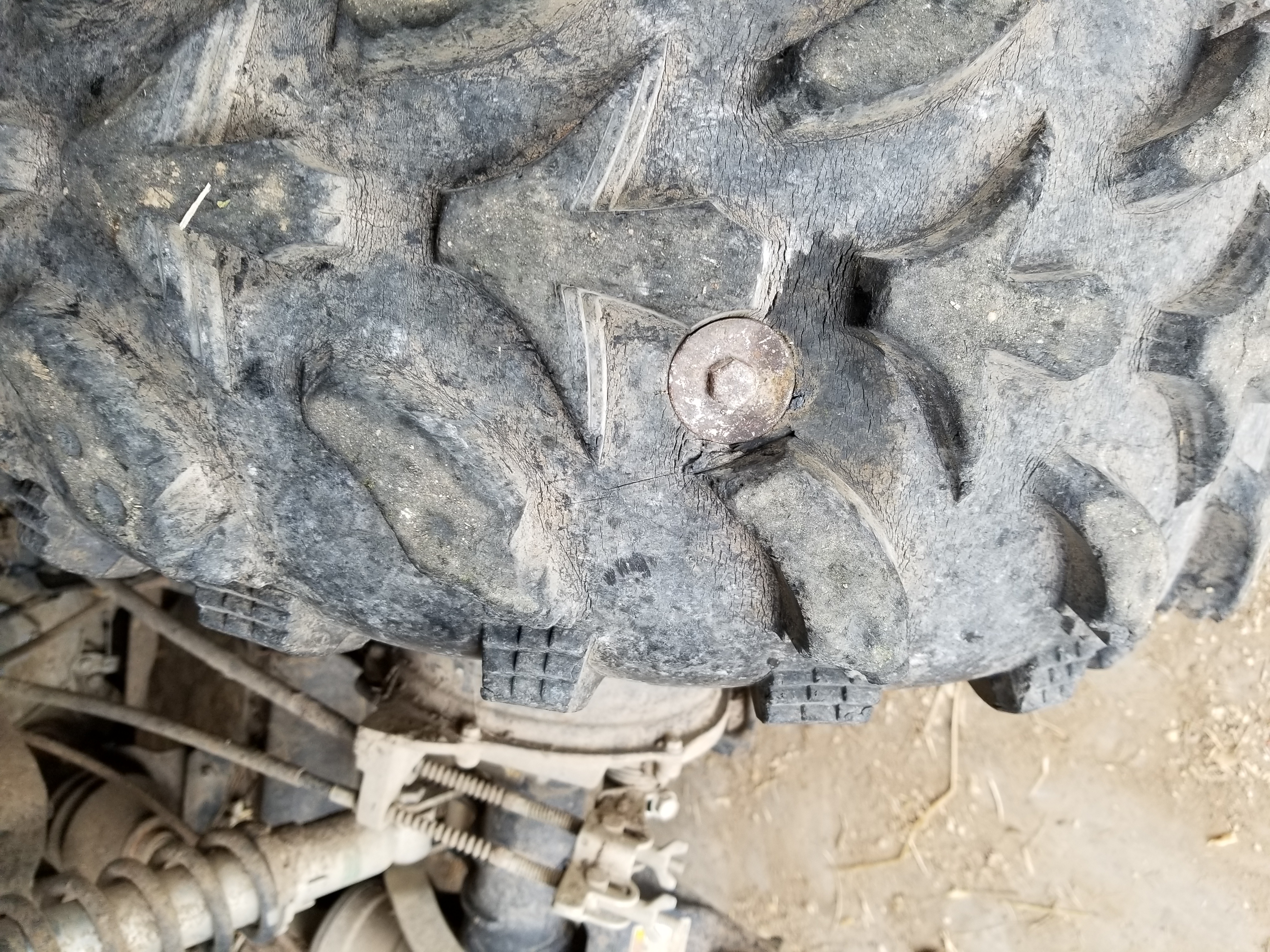

Buy some green slime I did that when I had a nail in the tire it last awhile.
   / Repair ATV Tire With a Bolt? #42
I hate slime, I used to put it in my ATV tires but it makes a heck of a mess for the guy who has to replace the tire. I like plugs the best.
I have had a car with slim in it before, in the winter the tires shook until that slime spread out lol, I wouldn't put it in a car tire either.
#43
UPDATE: Three years and hundreds of miles later, the nut/bolt fix is still holding without leakage despite my beating the crap out of the machine.
