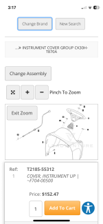

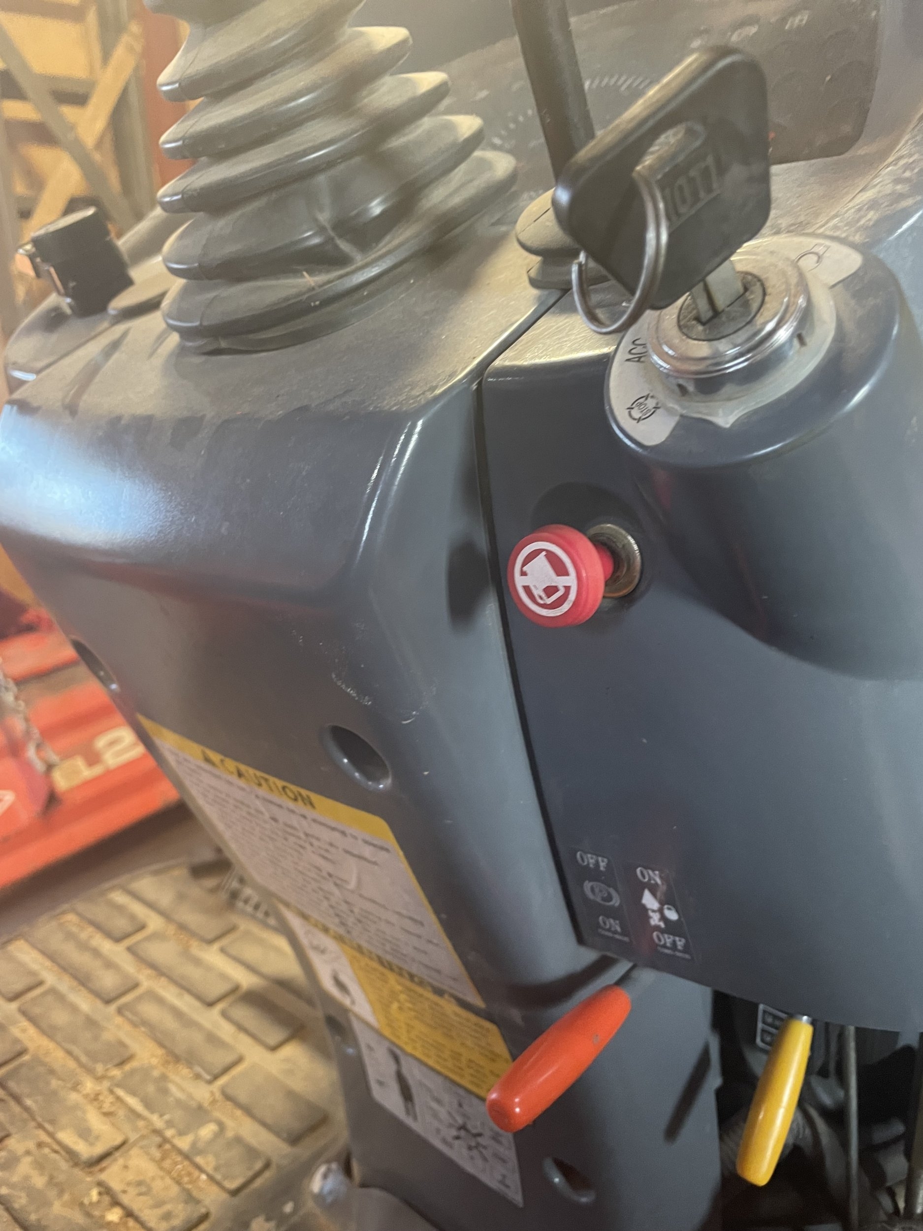

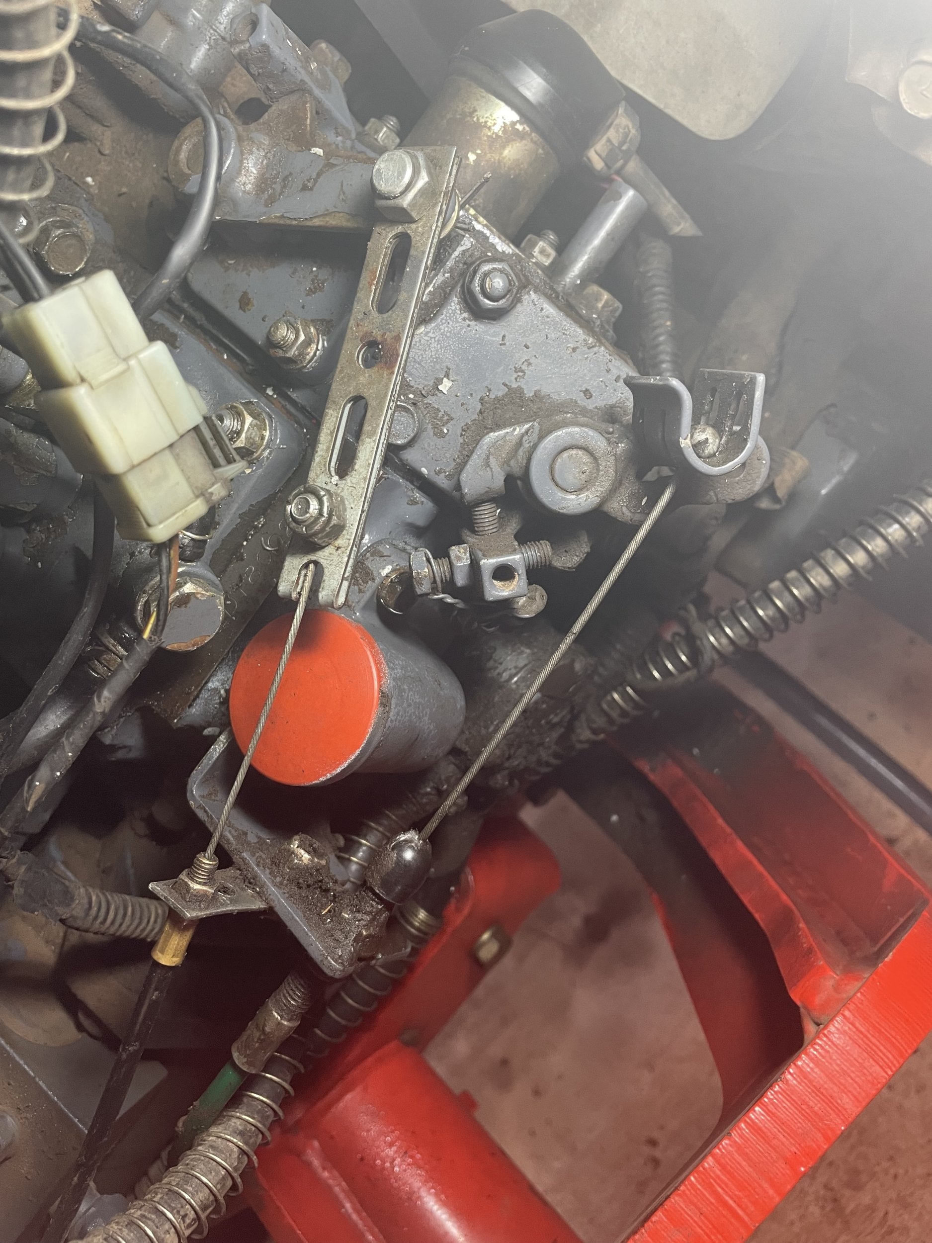

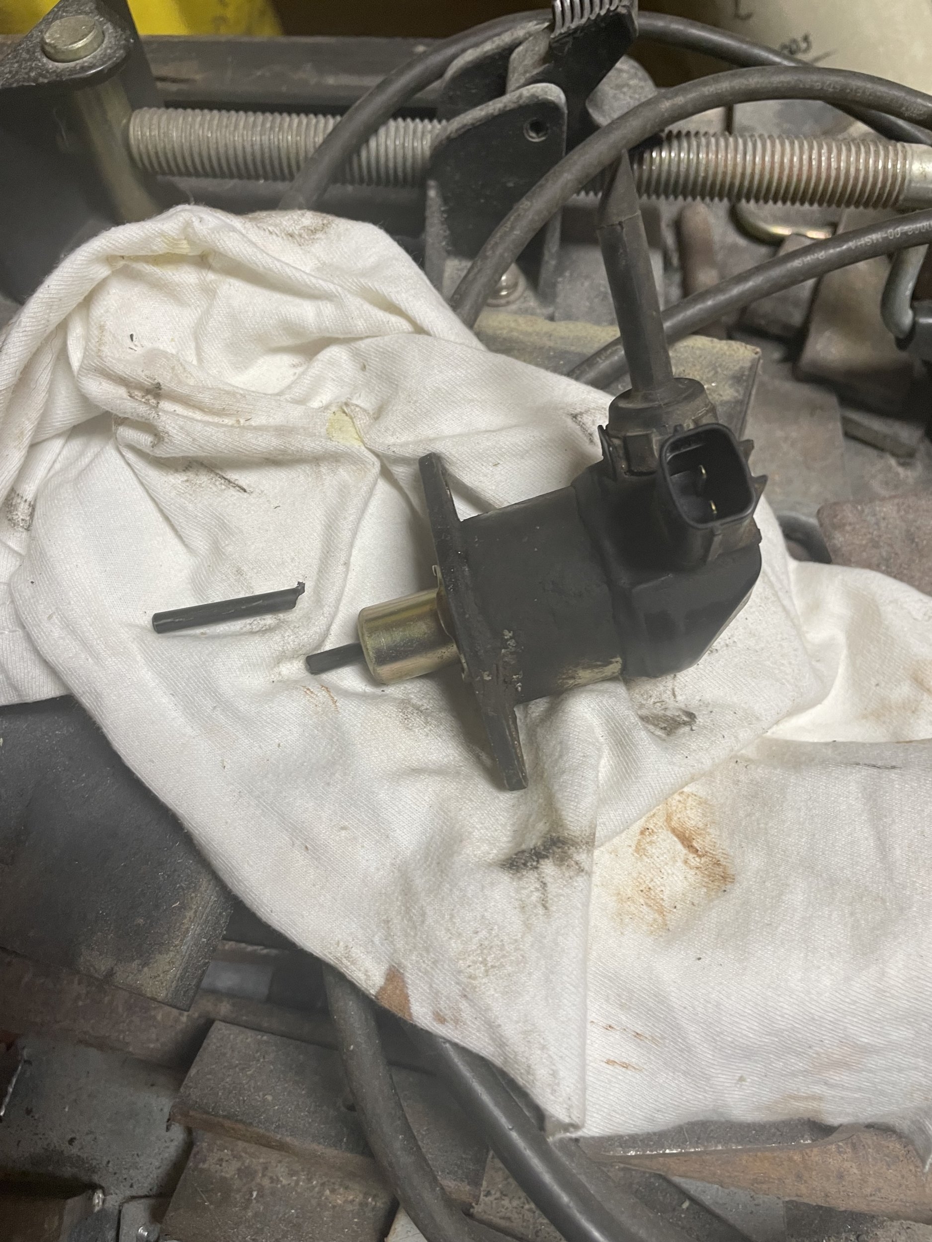

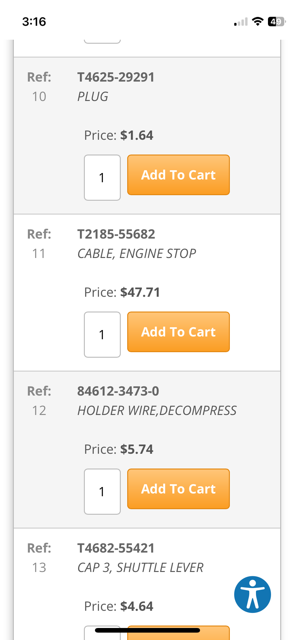

Follow up to my second pump failure. Well it was a warm day so I pulled the fuel solenoid out and cut off the rod. Plugged it back in only so the wires don’t dangle into the fan. I installed the fuel shut off cable several years back so now I shut the key off then pull the fuel shut off cable. The fuel shut off hole is already in the dash and the cable fit right where it should have been and not that defective setup that was put in place for a few model years. No more rack slamming, tooth busting, rack jamming for me. The parts finder I used was Michigan Iron’s, so that’s the price from their website. I had to manufacture a couple of parts/pieces to make the cable work but hopefully I’ll never have to worry about a broken injector pump again.
