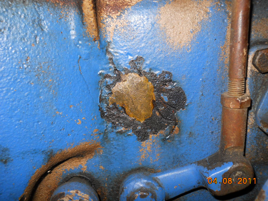

Years ago the clutch exploded on my tractor and blew a hole in the side of my tranny. I brazed it. It seals fine. I can take a piture if you like. Mine is cast iron also.
   / Repair Hole in Transmission Case #32
Heres a picture of mine fixed.

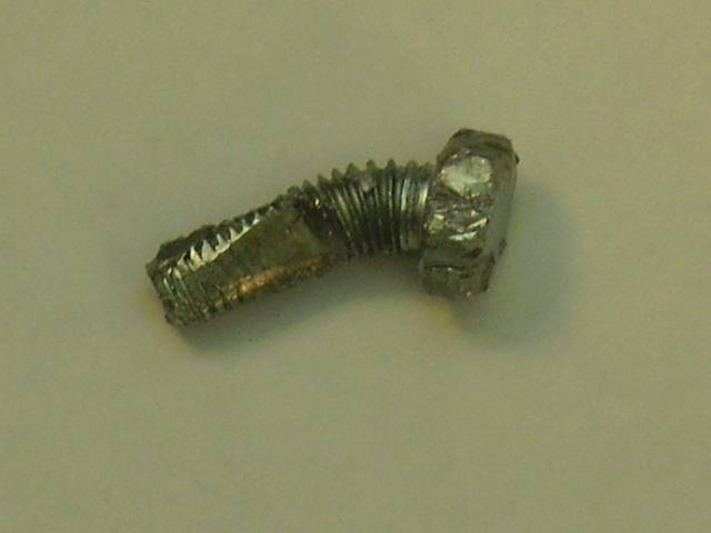

Here a picture of the culprit. Doesn't look like a transmission part to me.
I have a suggestion for your hole in the transmission case. If it's not too big drill it out to the size of the nearest pipe plug . Get a pipe tap and thread the hole. When tapping the hole don't go in to far or you will tap it to big and you don't want the pipe plug in to far or it might interfere with the gears. Ran the tap in a little bit and then try the plug. If it is not in far enough tap it a little more. If the gears are close to the case you will have to grind the end off the tap. It means you will sacrifice a tap but thats a small price to pay. When the tapped hole is the right size apply some good pipe sealant to the pipe plug and install it. Use a pipe plug with an internal drive not a square external drive head. Like the kind used on oil galleries in engines. I have used this type of repair on the same type of problem before with good success. I agree with the others about trying to find out where the bolt came from. VE6IAZ

i wonder how thick that webbing is down there.. I'm not sure a plug is gonna have enough threads to seal it, AND not interfer with the gears.. looks like less than 3/4" of room judging onthe size of the bolt and the fact tht it did punch a hole thru..
No it doesn't...maybe a bolt off a cover plate or something like that.
Probably been adrift inside the case for quite a while...
That's a good repair, knightrider!!!
