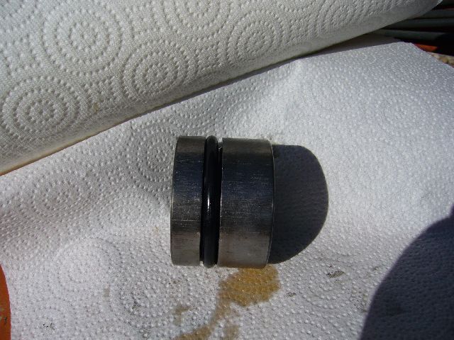

I thought I would share some pictures of the 3pt o-ring change out I did. Here is the background/detail:
I bought this 1970's or so Kubota B7100 along with some attachments. I found that with heavy implements the 3 pt would go down almost as fast as it goes up :confused: this necessitated me constantly bumping the control handle whenever I had an implement on that I did not want dragging. The 3 pt 'speed control' could slow it down but than meant taking forever to purposely let the implements down as well so that was not the problem. After reviewing the parts manual and searching posts here on TBN I decided the o-ring on the 3pt lift cylinder was the culprit. I purchased a new o-ring from the dealer for about $2.50 as well as new o-rings for the cover. About $5.00 in parts altogether.

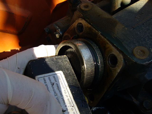

The second pic is a close up of the piston. This is as far forward as it comes with the lift arms all the way up.

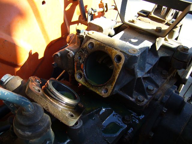

Pic three I used a magnet to pull the piston out of the cylinder.

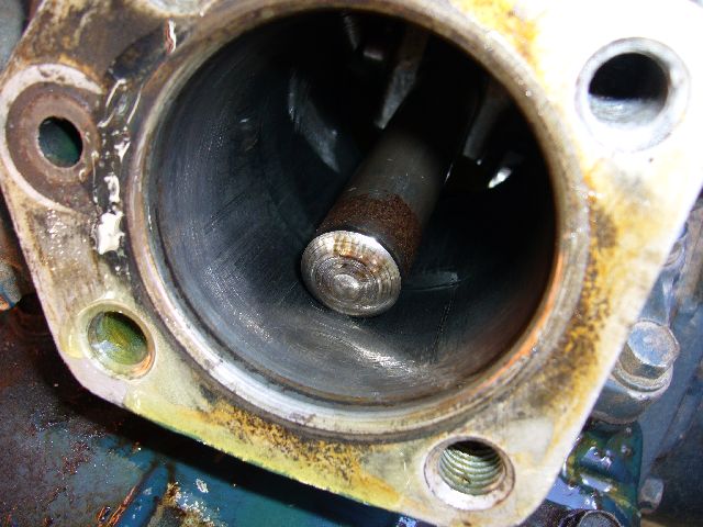

Pic four shows the inside of the cylinder, not too bad for about a 30 year old tractor.

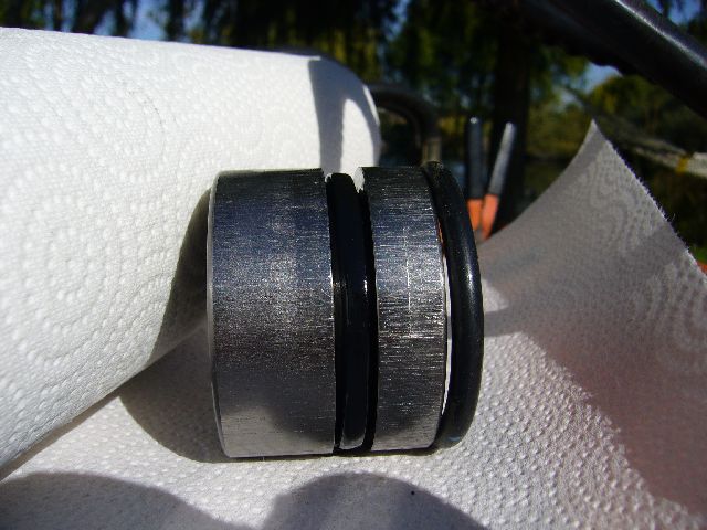

Pic five shows the piston, old o-ring in place and new o-ring leaning next to it, you can already see the old o-ring probably isn't even making contact with the sides of the cylinder anymore.

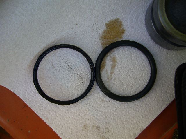

Pic six shows old o-ring on the left and new o-ring on the right. This really gives you an idea of how badly the o-ring was worn.
Pic seven is the piston with the new o-ring in place.
Put it all back together, topped off the oil and took it for a test run. The 3 pt hitch is now good as new, even with my almost 400 lb tiller it didn't drop even a little bit in a 15 minute period.
If you went straight to it you could probably do this in under an hour but I got side-tracked a few times;) Gotta say I am pretty happy with this $5.00 repair. :D

Looking at the picture of the cylinder bore does show some marks or scratches, did you hone the bore before you put the piston back or not. What does everyone think - would this ruin the replacement seal as you need a smooth bore to seal well, or would honing improve the seal?
   / Repair: Kubota B7100 dropping 3pt hitch #5
I would try to hone down any scratches I found. Deep scratches will eventually degrade the orings. etc.
From what I remember the scratches look worse in the photo than they really were. I did not hone it out and still works fine almost 2 years later.

Charles,
Ten years later...I've got a b7100, same problem. Just wondering (if you still read this post), how did you keep the piston rod in place when reinserting the piston? I had a Satoh, and had to take the arms off, etc...as the piston rod "laid down" on the bottom of the cylinder bore. Thanks!
   / Repair: Kubota B7100 dropping 3pt hitch #10
The underside of the piston in concave (carved out) so that the rod will self center when you reinstall the piston. Helps if you move the hitch arms so that the rod is retracted as far as possible when inserting the piston.
