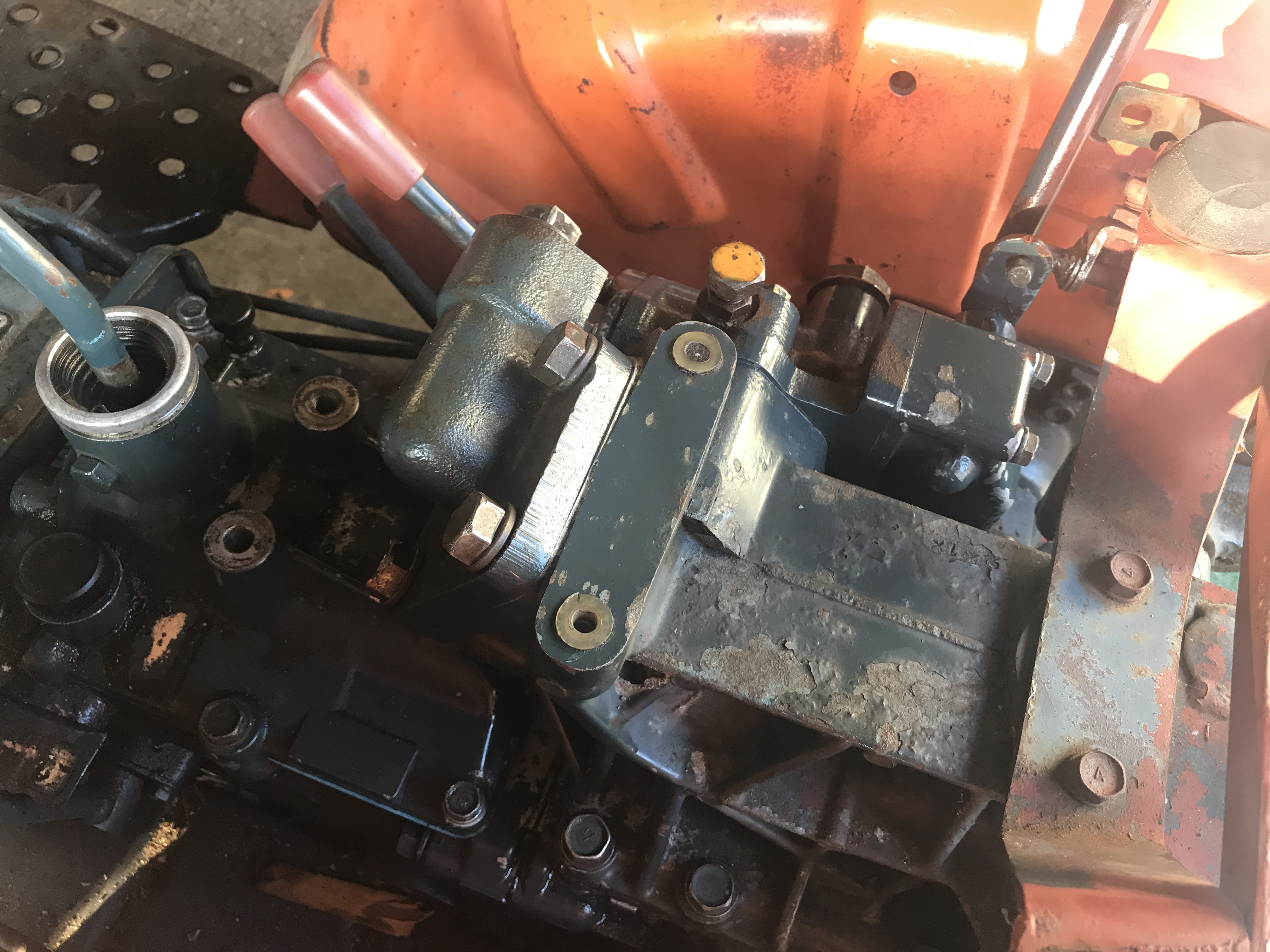

Hi everyone.New member here.So I used the search function and found this thread,which has been great reading.
I have a B7100 as well,and have the exact same problem as this.
I have replaced the high pressure O rings on the piston,done a complete flush and changed the fluids to the hydraulics.
I致e torn down the three point hitch pump, AAE96916-BBE5-42DF-A392-08EB03309565.jpegeverything there seems good.
The front hydraulics work perfectly,but when the three point hitch comes up,I can put my foot on it and push it down again.
My coloured three point adjustment screw is fine,I致e taken it out and cleaned it.
Please help,I知 officially getting driven to insanity.
