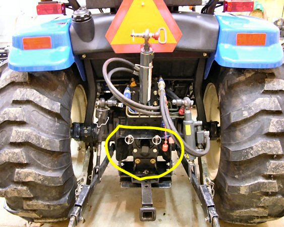

Don't know if this qualifies or not, but I got tired always looking for ring pins that are used to secure implements in place. I finally took 2 single pieces of chain and bolted each to the folding PTO stub guard. Each link holds a pin until it is needed and they are always within easy reach.
