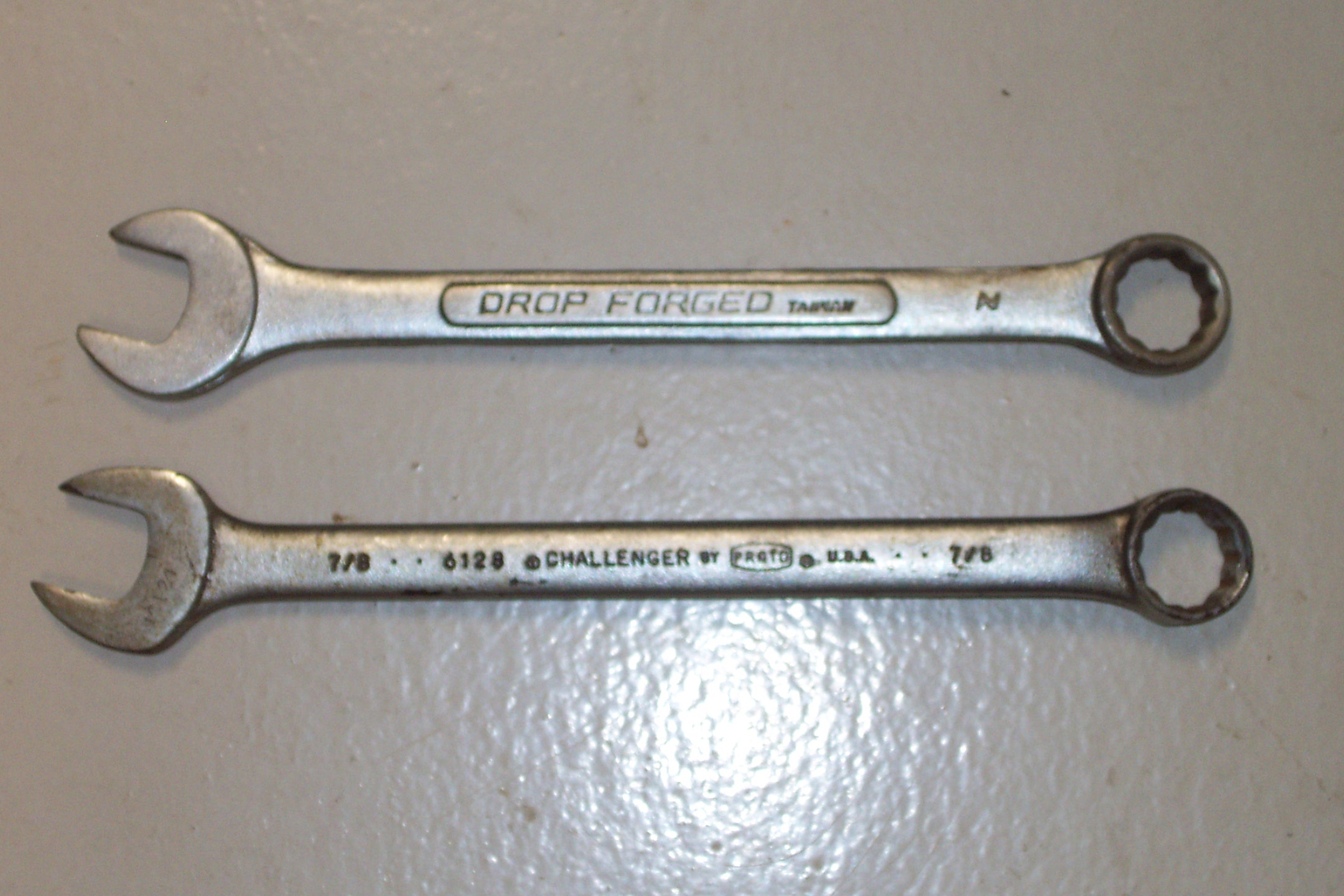

Please consider this as my opinion.
The strength of the metal itself is at the top of the list. A busted knuckle because a low quality open end wrench spread and slipped on a nut is a powerful reminder. I have personally seen good tools remove fasteners where lesser tools have failed.
Second would be the working clearance required for the tool. Low quality wrenches have to have bigger shafts to avoid deflecting, thicker shoulders on open ends and thicker walls on boxed ends to compensate for the softer metal used. One day, that 1mm of added width or thickness will become real important.
Next would be weight. Why would someone care if a cheap wrench weighs an ounce more than a quality wrench? They may have to pick one up 500 times a day, or have to manuver it in a tight spot with fingertips only.
A picture is worth 1000 words. The attached photo shows some of the differences in a good tool, a Proto in this case, and a lesser quality tool.
I'm not a professional mechanic but have turned a few bolts over the years and want every advantage I can get when doing serious wrenching. I feel top quality tools give a little added edge.

I'm not a tool conneseuir ( spelling? ).. The differences you showed in those 2 wrenches is beyond minscule for the average guy who is just doing maintenance on some lawn or estate equipment.. or even minor repair work.
if I was a profesional mechanic.. I might think otherwise.. thus.. without being a professional mechanic.. i don't get into anything i would consider 'serious' work.
I've been elbows deep into antique tractors.. and chinese tools have been there too... no problems yet... even use cheater pipes on them... so far so good.
