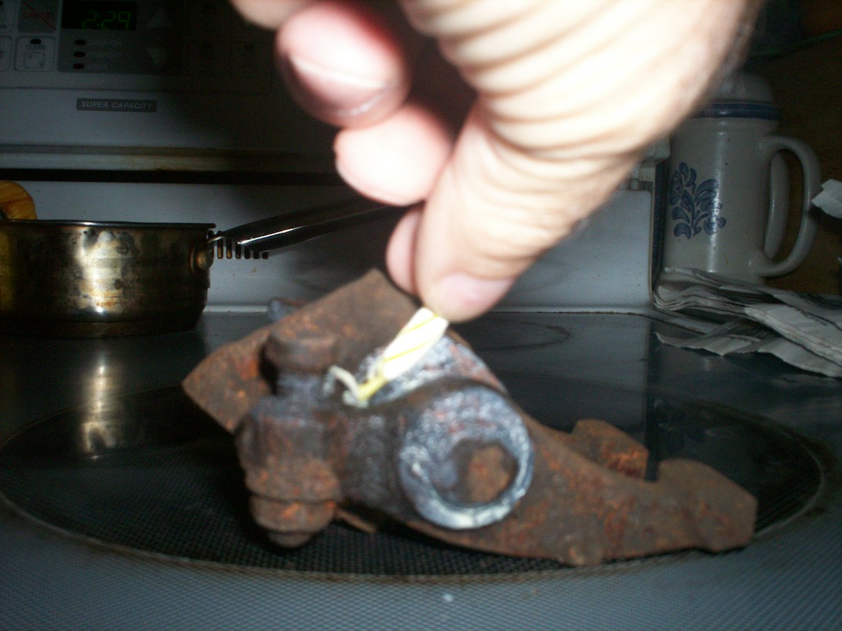

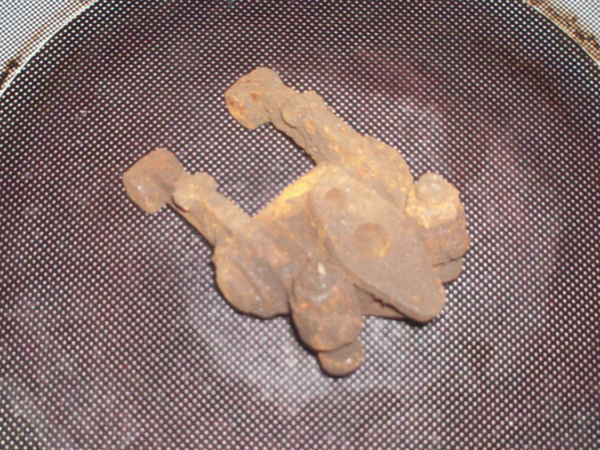

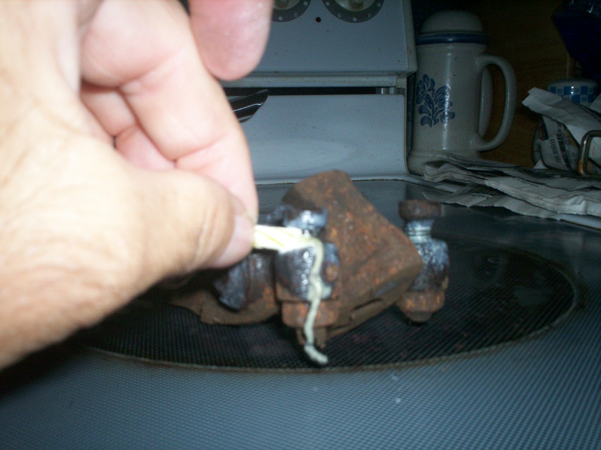

Stuck nut.. heat joint and then apply candle wax.. the wax will seep into the joint by capilary action, and act as a lube when you do go to unscrew it.
Don't know/remember who suggested this first, but Soundguy's post is where I found this quote. It works. I used it to free up rusted rocker arms that were immoveable due to rust. The wax wicked right in, and with a little encouragement, freed right up.
