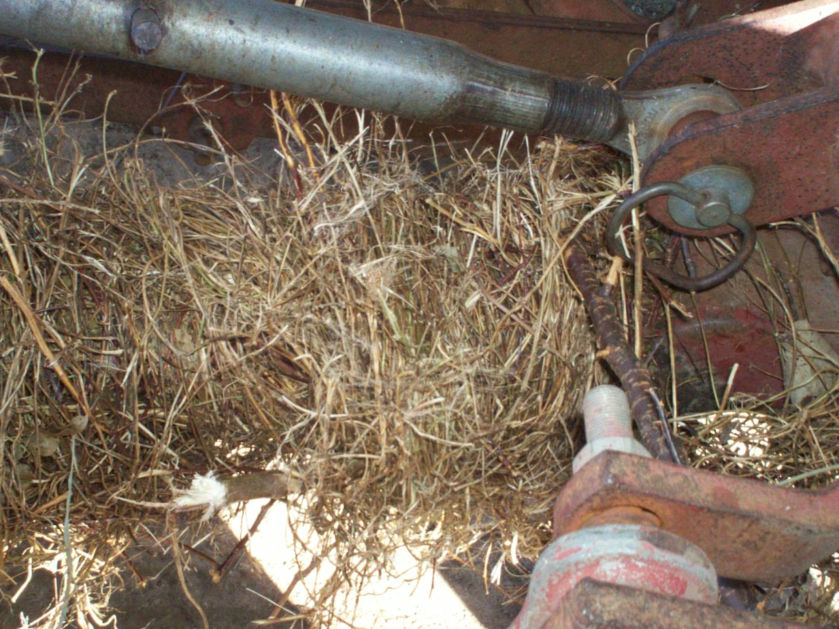

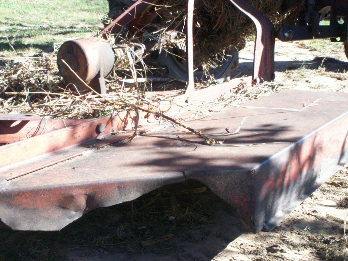

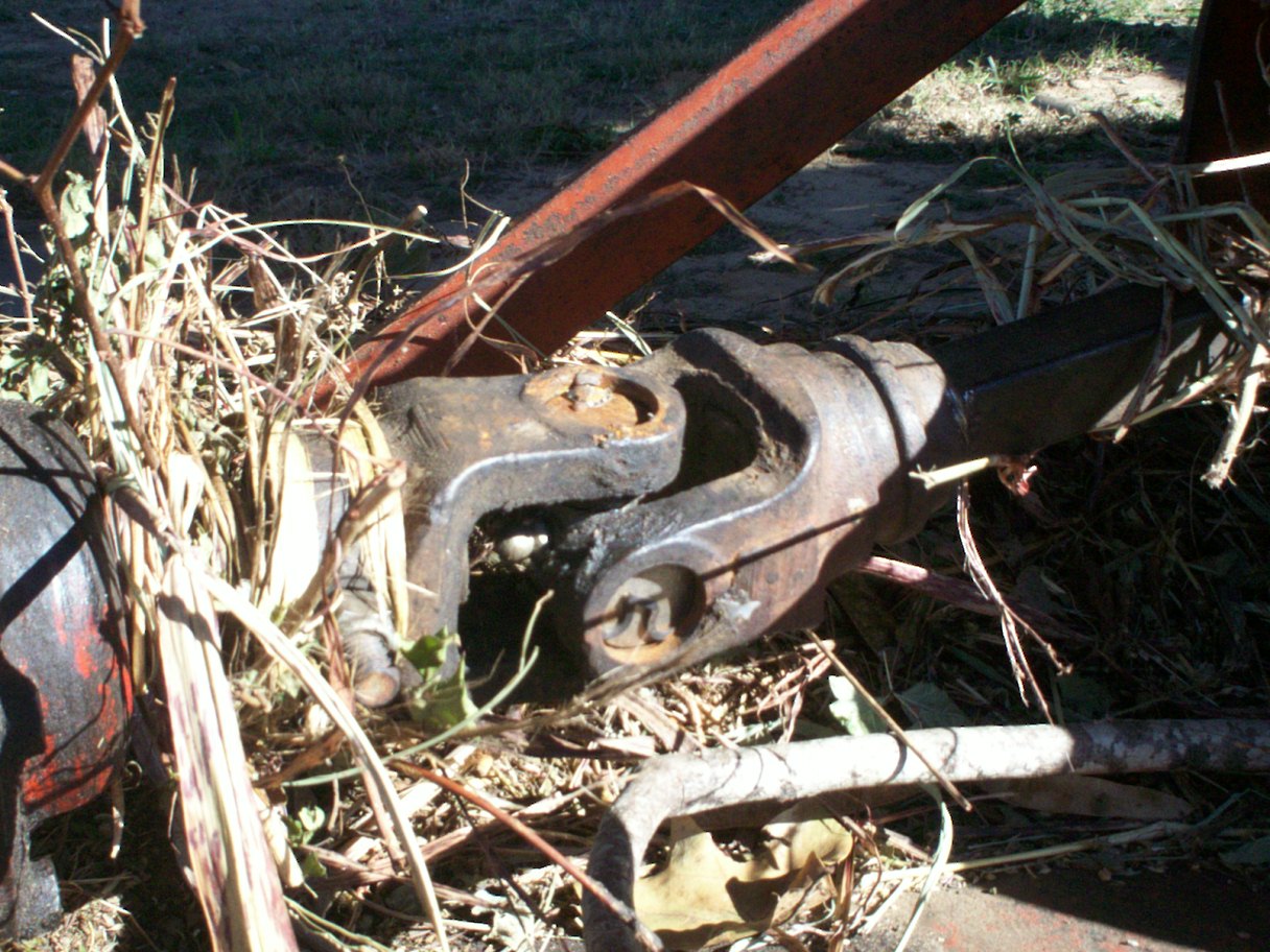

I replaced the u-joints in mower shaft a couple weeks ago. This is on a good but well used unit (don't know the brand). After getting the new bearings in, one retainer on each end wouldn't go into groove. What to do? I tack welded in place:eek: . In a few years, if I have to replace again, I will just cut off and install new yokes. Probably not the ideal fix, but it works in a pinch, and no telling how long it will last. As you can see, I probably should invest in a guard of some sort too.:D

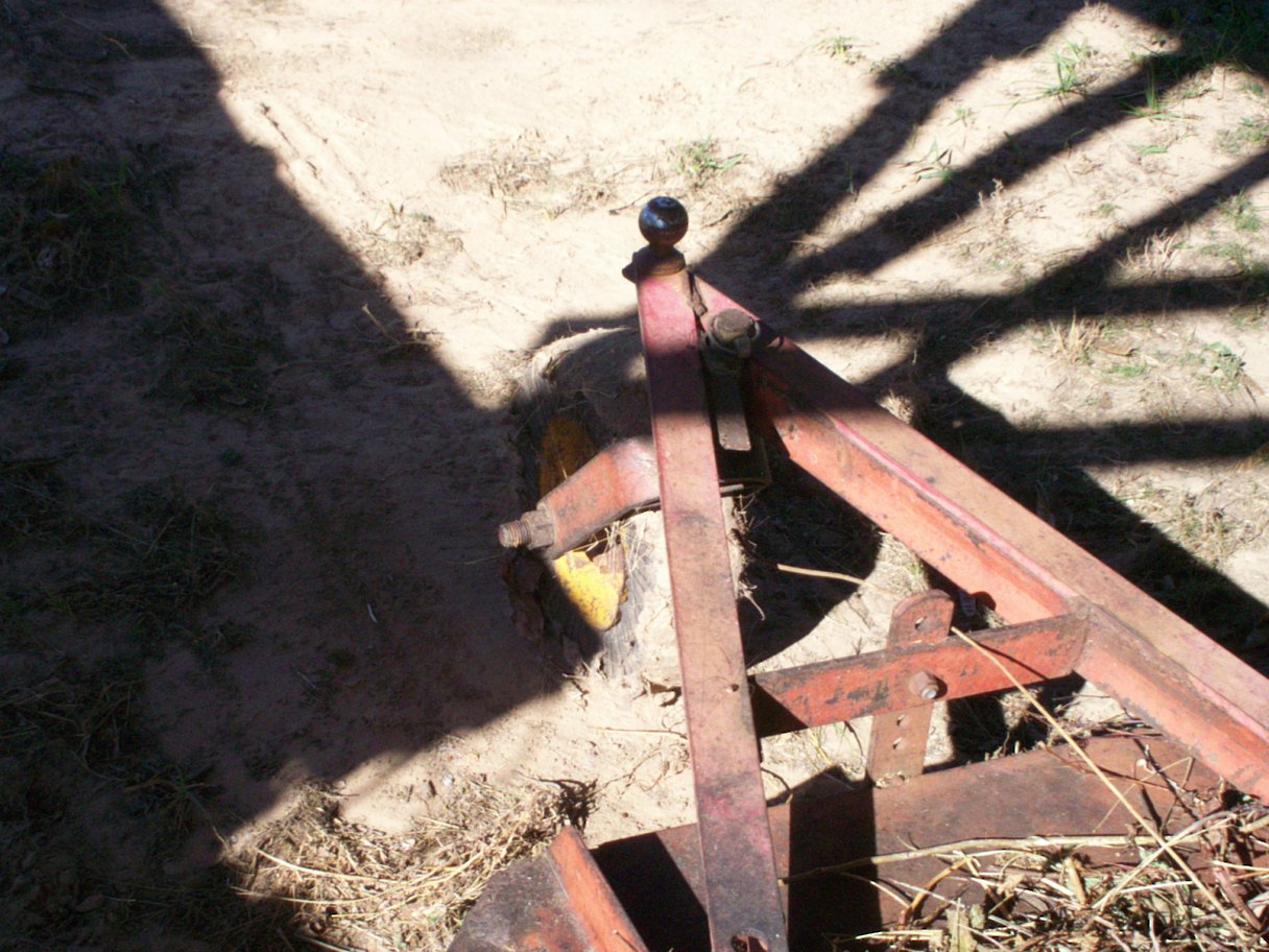

Pic 4 is of the ball mounted near tailwheel so I can move things around without taking the mower off.

But why wouldn't the u-joint close up enough to insert the clips? Did a needle bearing come out and lodge in the bottom of the cup? Did you hammer or press the yoke ends together a hair too much? I think once I determined that a needle bearing was not out of place, I would have pried the yoke open a hair with a crowbar to enable me to insert the clip. Hope welding it didn't cause the grease to run out or damage the seal. :(

I too was concerned about a bearing out of place and took it apart a couple of times to check, and each time found nothing. Clip just would not go in. I had spent a couple hours on the thing, and I just got tired of messing with it. I tacked in place. I was needing to get the mower working due to me being off, and didn't want to miss the chance to mow while weather was nice. Like I said, I probably need to upgrade to a shaft with a cover anyhow, so next time I can do that as well.
