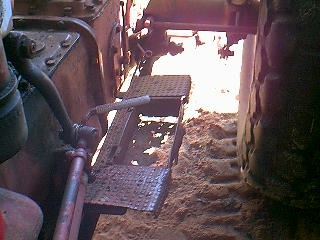

repair of tool box/running board on my NAA

Here is the before pic... running board with the tool box lid gon, and the floor rusted out.... makes getting on and off the tractor a bit difficult.

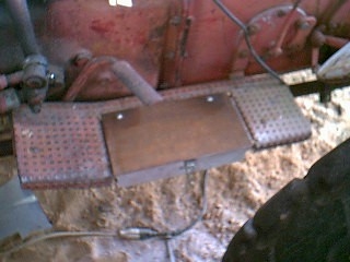

Here is the new lid I made.. used existing hinges, and had to fabricate a shackle style locking mechanism using a pin an old hinge and a cotter pin.
I replaced the floor of hte tool box with a perferated metal... not regular expanded metal.. but one with little 1/16th holes in it. First box must have rusted out due to holding hater.. this new one won't hold water.. but will still hold small nuts washers.. etc... And the new box/lid holds me getting up on the tractor!.. a deffinate plus.

Not great work.. but I can' weld well, so took my time and made something that worked and was sturdy.. but not very pretty... oh well.. least I don't have to worry about forgetting and putting my foot through a hole and falling off the tractor now..
Soundguy
   / repair of tool box/running board on my NAA #5
Looks like a pretty good fix to me... /forums/images/graemlins/grin.gif
   / repair of tool box/running board on my NAA #6
They make grinders for folks that can't weld well! a welder told me that . /forums/images/graemlins/grin.gif
Lets put it this way... I'm an excelent grinder!
That lid for instance.. I need to get a new cutting tip for my O/A bottles.. so I had to use my angle grinder and a cutting blade on it... Perty good job if you ask me.
Best of all.. it works and is safer... I kept having thoughs of forgetting and falling through.. or having to clutch and break rappidly and foot slipping off and through. and getting sucked under.. etc.
